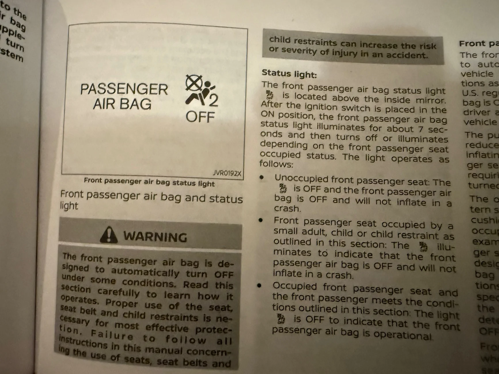

I got an answer and what I am experiencing is normal.
From the manual:
So really the light should only be on if condition 2 above is met - a small kid / car seat is in the passenger seat to let you know it is off.
even unoccupied, it does not light up (like every other car in the world) but the airbag is actually off. Probably because like some of you here have said since it is at eye-level and can be distracting.
I tested this by just pushing down on the passenger seat a little bit and the light came on. Then went off again when I let go.
