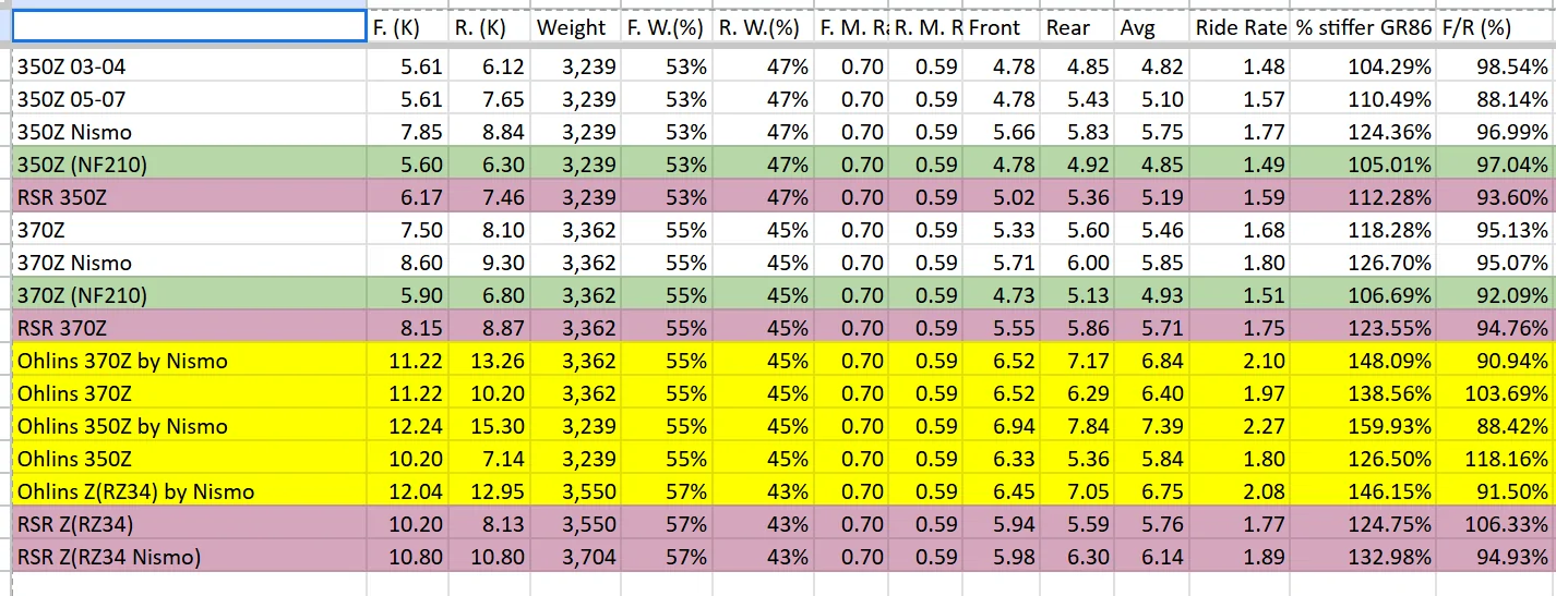

I don't have the spring rates of the OEM Nismo springs but have something interesting for your reference!!! :)
White background : OEM
Green background : NF210 springs, about as same rates as OEM
Red : RSR springs, about 10-20% stiffer than OEM
The second and third columns are spring rates for Front and Rear. I also calculated the ride rates and comparison differences with GR86.
Ride rate calculation (This video is for ride rate calculation)

Some additional infos about ride rates...
2009 GT-R : 1.98
911(991) GT3 : 2.17
911(997) GT3 : 2.06
Miata(ND) : 1.2 <--- My wife, an approaching 60 year old woman, said the Ohlins suspension from my current F car was more comfortable than the Miata(ND) I rented???:crazy: I guess the additional weight could help the ride comfort a lot especially for some very stiff suspensions!!!
I also find except SUVs, no matter which your car is... Ohlins almost always bring the ride rates of their DFV suspensions to around 2.0-2.4 which is 911 GT3 territory!!!
By the way... My wife and I just finished a 2500 miles trip recently in my F car with Ohlins DFV and she NEVER complained!!!:muscle: We also plan another 2500 or more miles trip next year... (I can't wait!!!)
PS: I don't think my calculated ride rates are 100% accurate but they should provide some general ideas!!! Have fun!!! :)
