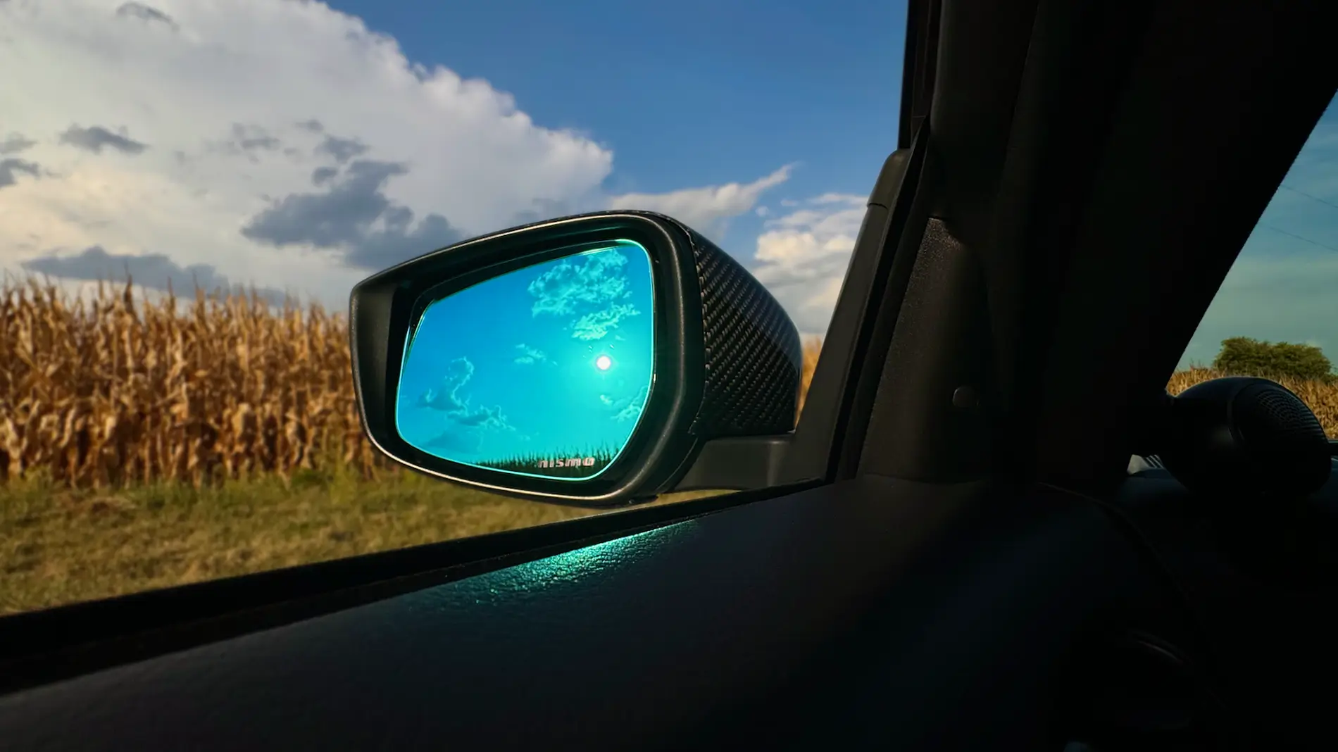

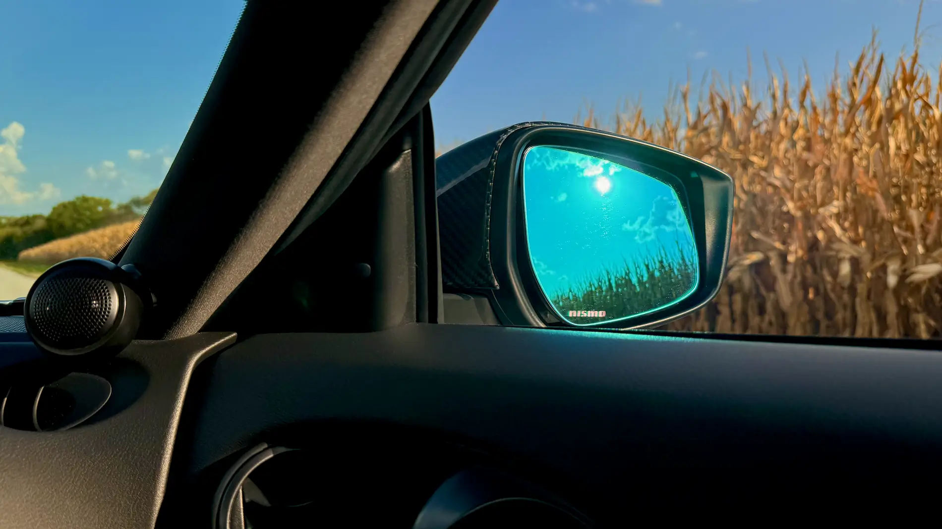

I installed them as well - a bit pricey but I have trouble seeing in the blind spot when at intersections and merges since my back is bolted together with rods.
these fixed the problem with the wide angle view - don’t need to turn my head as I can see with the mirror now - love them and the blue color is cool.

Around $225. And you have to use 3M tape to build a curved adhesive point as the Nismo mirrors are flat glass, and they have a habit of falling off since the factory mirrors are not flat. So when you stick the Nismo mirror on your original mirror, especially the passenger side, which has concavity to it, you need to make sure you get a good surface. I built it up with some 3M tape to ensure a solid mount.
