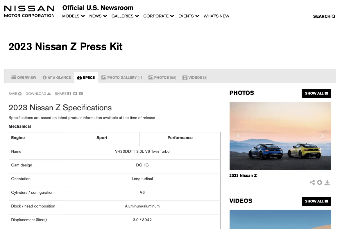

A typo on the spec sheet? I would be shocked. The amount of eyes that passed over that before it went live probably couldn't be counted on your hands nor feet.
Have the press kit open and just screenshot this - https://usa.nissannews.com/en-US/releases/2023-nissan-z-press-kit

A typo? A believable typo would be 2979cc vs. 2997cc. 3042 is way too intentional.

I don't think changing the piston or cylinder head shape could change the displacement. It might change the compression ratio, but the displacement is based on the volume swept by the pistons (if you imagine the top of the piston as the border, it will be the same at the top of the stroke or the bottom of the stroke, so any change to the piston will be cancelled out, and the open space at TDC is not counted as displacement since it is not swept volume). Maybe they changed the cylinder lining thickness (used the PTWA like on the GTR and some of the Ford motors) and gained some bore, or maybe slightly changed the stroke. Or maybe it's a mistake, but will be interesting when we get some details.
