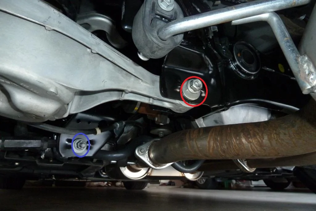

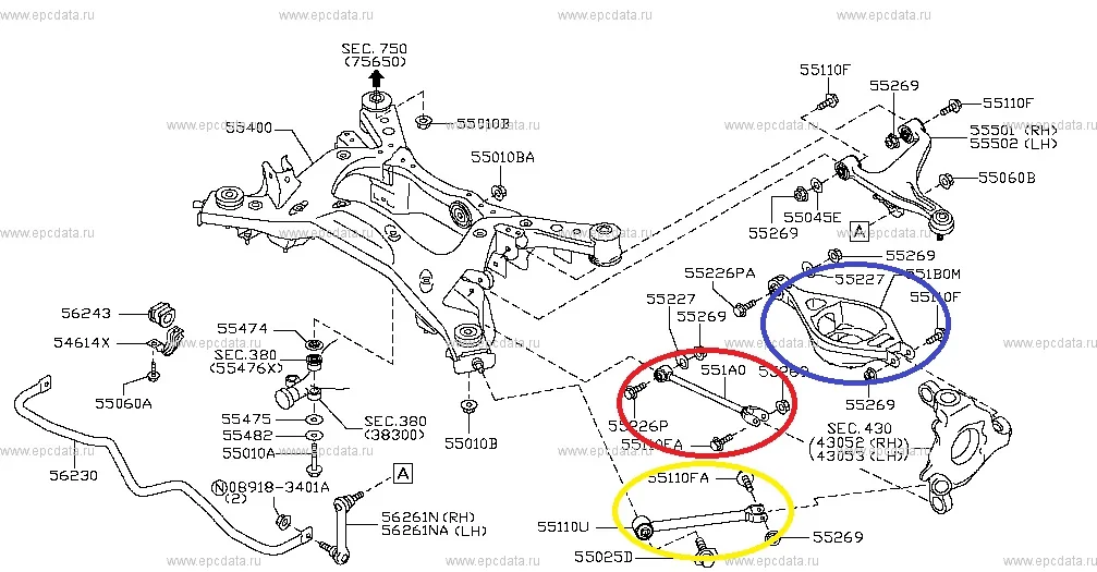

There are three main "arms" in the rear suspension
The blue arm is the mid-link, which has the bucket for the spring. This is the arm that is replaced when there is a "true" coilover (spring wrapped around shock) with a "toe arm" (the arm you linked to)
The red arm is the camber arm. This arm is in place regardless of whether you have the factory bucket or a toe arm
The yellow arm is the traction link. This is also in place regardless of setup.
These arms are fixed. There is no length adjustment to change camber or toe in factory form.
Instead, alignment in the rear is adjusted via eccentric bolts on the subframe. These rotate with a slight offset and slightly change the length of the arm's end point. It allows for very limited camber and toe adjustment. Red is toe, and connected to the factory mid link/bucket. Blue is camber, attached to the factory camber arm.
You got replacement springs only, which means you retain the factory bucket. That means you will NOT need a replacement toe arm.
You will still have the factory camber and traction link arms and both eccentric bolts for adjustment.
The ideal way to lower your car and gain full alignment adjustability is to replace your springs and shocks with a coilover setup. Aftermarket coilovers are available in both factory style divorced spring/shock style or true coilover style. For most people there is no real advantage.
Depending on the style you get you will get a replacement mid link or a replacement toe arm, and either way you should replace the camber and toe links with adjustable versions that can change length. The best ones on the market are SPL Parts or their Nismo recolors.
I recommended the Sake Bomb Garage Ohlins because they start with a high quality brand coilover and customize it to your use, and also have an air cup system designed to work with it.

you bought the Apexi toe arms already?
and you plan on using them?
look the diagrams and re-read my posts
do you see a problem?

No, I purchased the Apex'i Camber links for the one highlighted in red.
I also purchased the Whiteline Toe arms at the same time, thinking they were needed, but after re-reading what you pointed out, since I'm only replacing the springs, I can't use them because they would replace the bucket midlinks?
