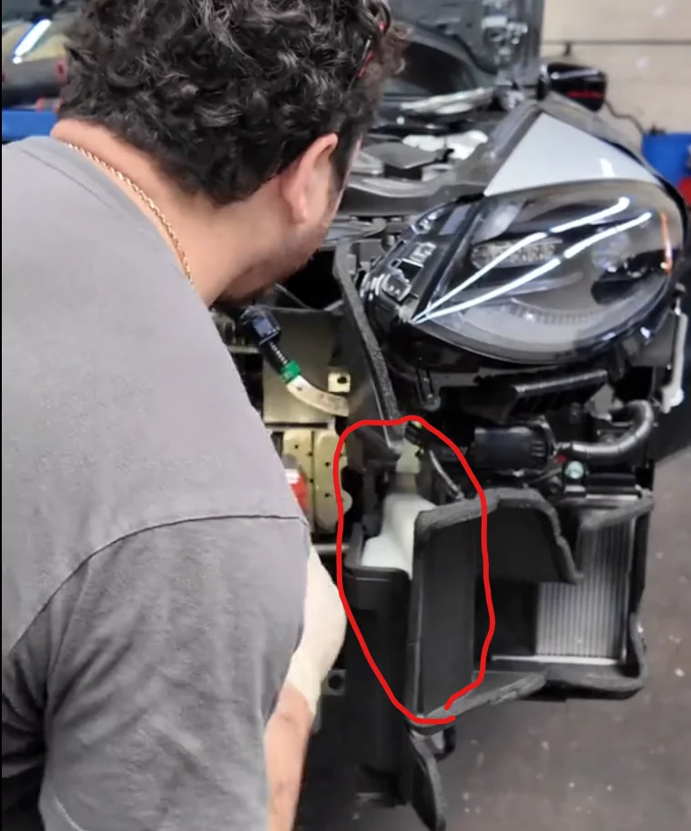

You can probably just use the Nismo washer reservoir since it's relocated for the aux radiator that is in front of the front wheel on the Nismo.
Here's a screenshot of the Nismo washer bottle location, as you can see it doesnt extend into the wheel well because a big radiator is located there on the Nismo:
For the bumper hood popper sensors, I wonder if we can measure the resistance and just plug in a resistor and be done with it. Apparently even if you eliminate the poppers if you hit a cone at autocross, or even drive over bumpy enough ground I've heard it can still trigger the hood popper sensors and require the dealer to reset them in the ECU.
