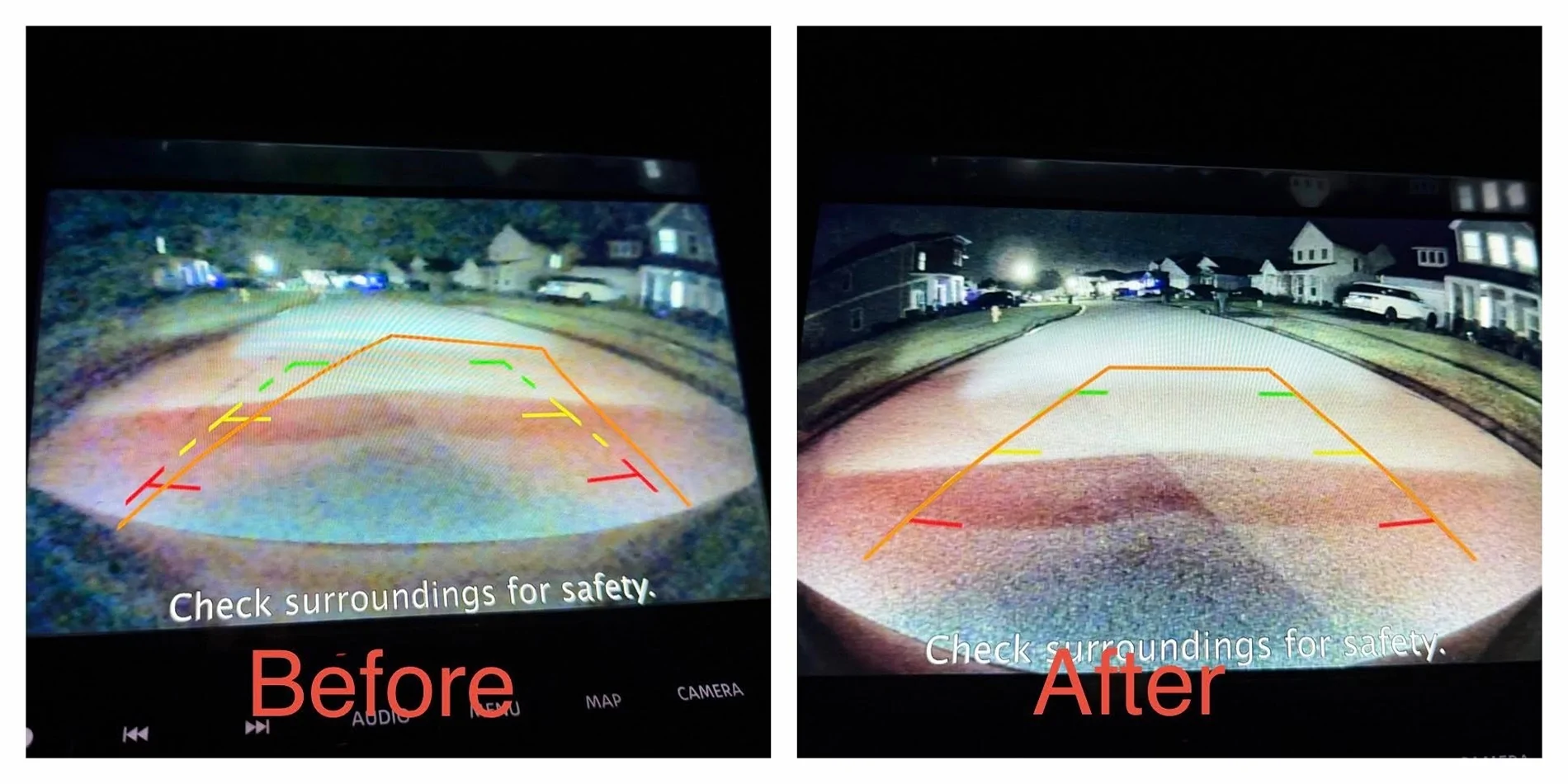

Surprised no one posted this. Here is a proved fix. This is a post from The New Nissan Z page on Facebook by Brian Watford.
Ok… I’ll have the upgraded cameras ready to ship on or before 12/20! I setup a Google Form for those that might be interested. I will only have 20 cameras ready for this first round. We will plan on making more dependent on interest.
$250 each
Upgraded Camera
• Resolution: 1280x960 (=1.2 million pixels)
• FOV: 140° (H) / 80° (V)
• Sensor: 1/3-inch HD CMOS
• Low Light: 0.001 |x
OEM Camera
• Resolution: 632Ɨ480 (=300k pixels)
• FOV: 140.5° (H) / 95.5° (V)
• Sensor: 1/4-inch CMOS
• Low Light: 1 Ix
https://forms.gle/SVCS6BSmRPfiMmWS7
Link to installation instructions:

Hey guys! I've seen a few posts about my camera upgrade that I offer, and that I have been selling on one of the FB groups.
I’ve been working with someone in Japan who’s developed an upgraded reverse camera for the RZ34. I have had this camera installed in my Z for about 6 months. It's a massive improvement over the OEM camera.
This isn’t the same camera that’s been posted before — it’s also made by KTN-san, but it’s been improved and redesigned. The older version had a little lag when shifting into reverse, but this one fixes that and seriously improves the image quality. It also had a fisheye type display new one (actually version 4) that we are offering is nearly identical to the OEM camera in angle and view.
Install is pretty simple, howeer you do need to run a 12V power supply to the camera.
Here’s a quick spec comparison between the Upgraded camera and the OEM Camera
Upgraded Camera
• Resolution: 1280x960 (ā‰ˆ1.2 million pixels)
• Low Light: 0.001 lx
OEM Camera
• Resolution: 632x480 (ā‰ˆ300k pixels)
• Low Light: 1 lx
Basically, 4x the pixel count and way better low-light performance.
I just had 20 cameras delivered to the US today, and still have a few available. I currently do not have plans on making more until possible April/May. Fill out the Google Form below if you are interested. These are ready to ship NOW! $250ea shipped within the US.
https://forms.gle/D8XeyL1u4QaDu8916
Below is a link to an install video that another FB group member did for me. He took a bit of a dipper ant approach with the wiring, but it seems to be working and stable!

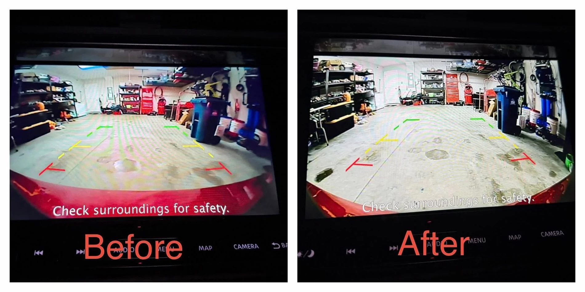

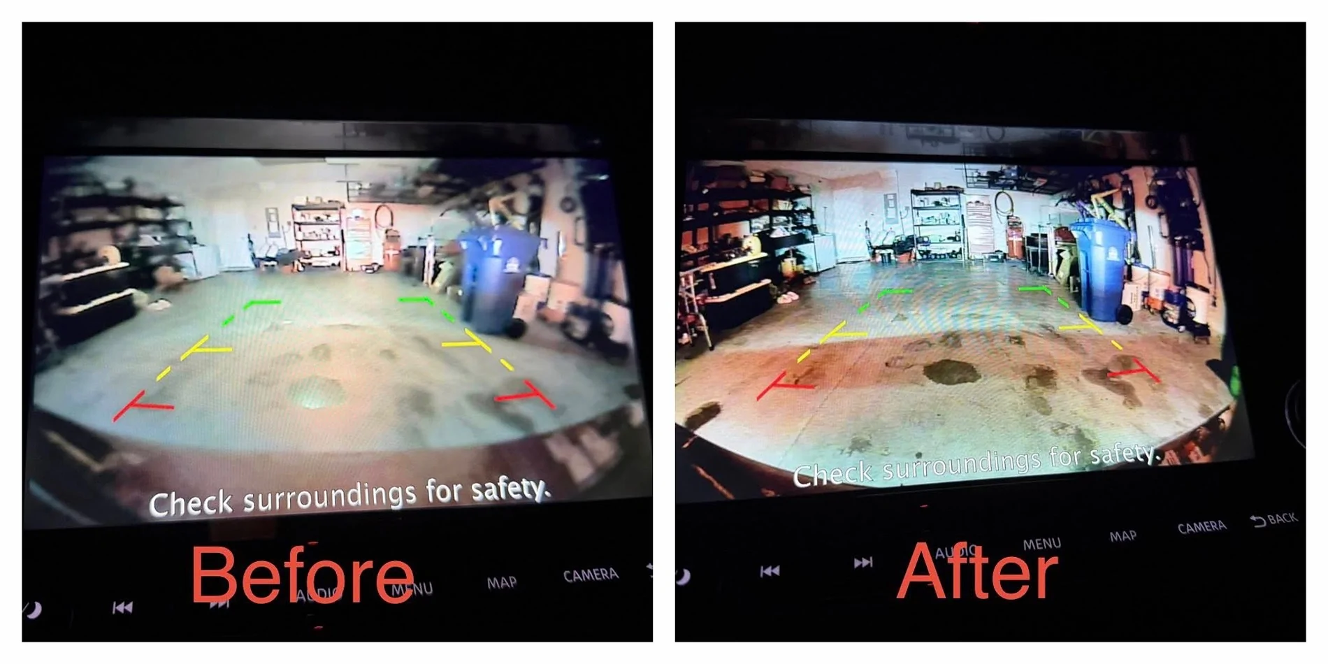

Very easy install. Maybe some of my video can help make it easier:
I just happened to have the right kind of crimper tool from my escapades in low voltage. https://www.amazon.com/dp/B005SUHPSW 2.9 works for the copper end doubled over, 3.5 seemed good for the insulation. Still ended up not using the included splice since only two are included (I stupidly put one on the wrong wire). Would recommend most people doing this should just get their own splice option they are familiar with.
Video quality is more clear and smooth. The fish eye doesn't quite match OEM and I catch some of the car in the corners. Overall definitely an improvement.
