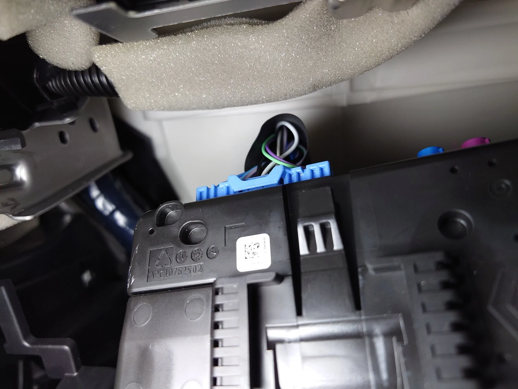

Following up on this, I disconnected my TCU today. I used these guides:
In the second video, there are two notes:
  • 2:20 the HVAC controls section holds down the leather trim above the glovebox, so it's best to remove the HVAC controls first
  • 2:47 the panel under the steering wheel doesn't leave much space to remove the other trim, so it's best to remove it as well
Aside from those points, the TCU can't be removed completely. The big blue plug must be plugged in for the head unit to function as normal.

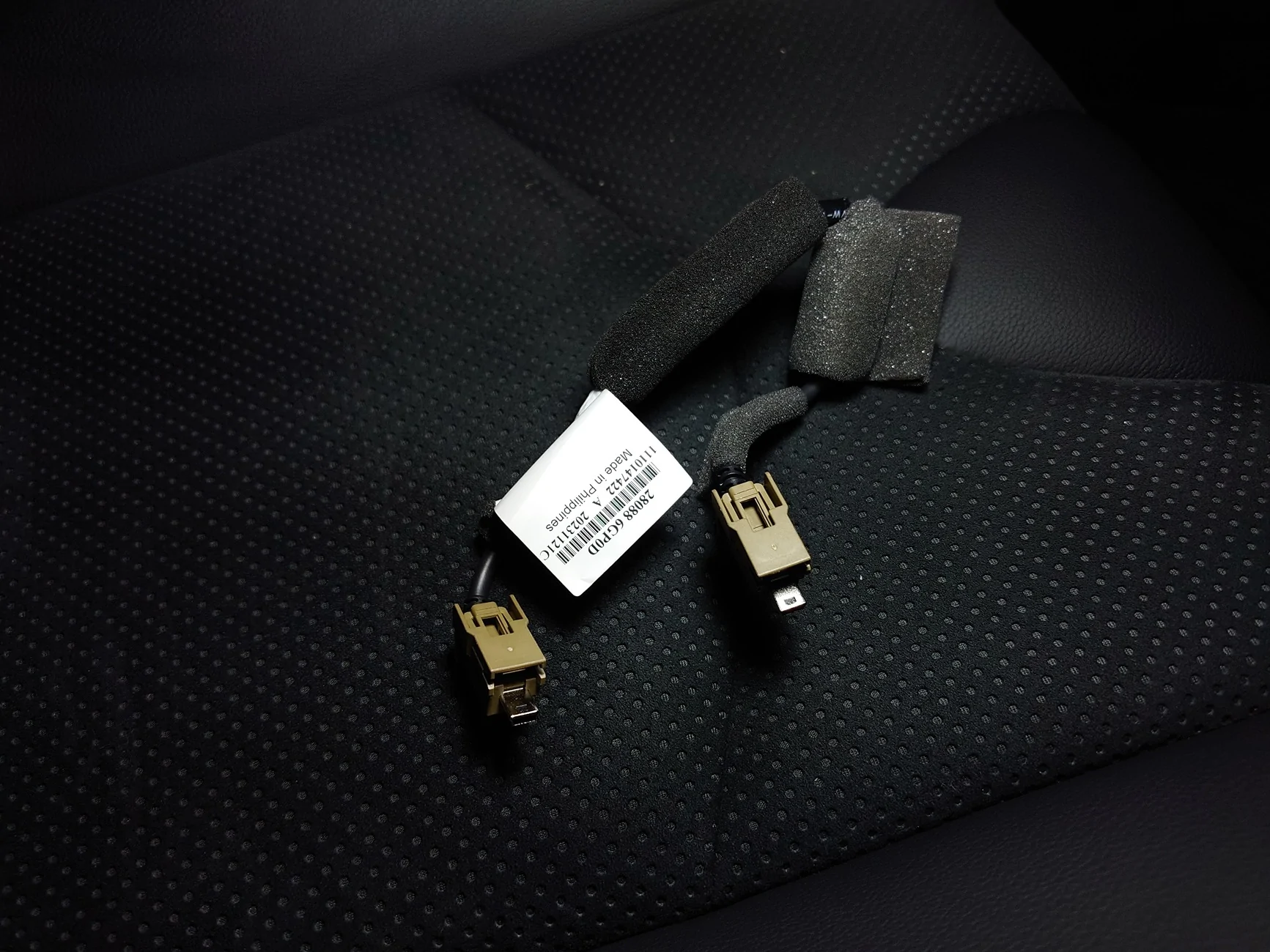

The cable with brown plugs connects the TCU to the head unit, and can be removed completely. This is the most sturdy mini USB cable I've ever seen.

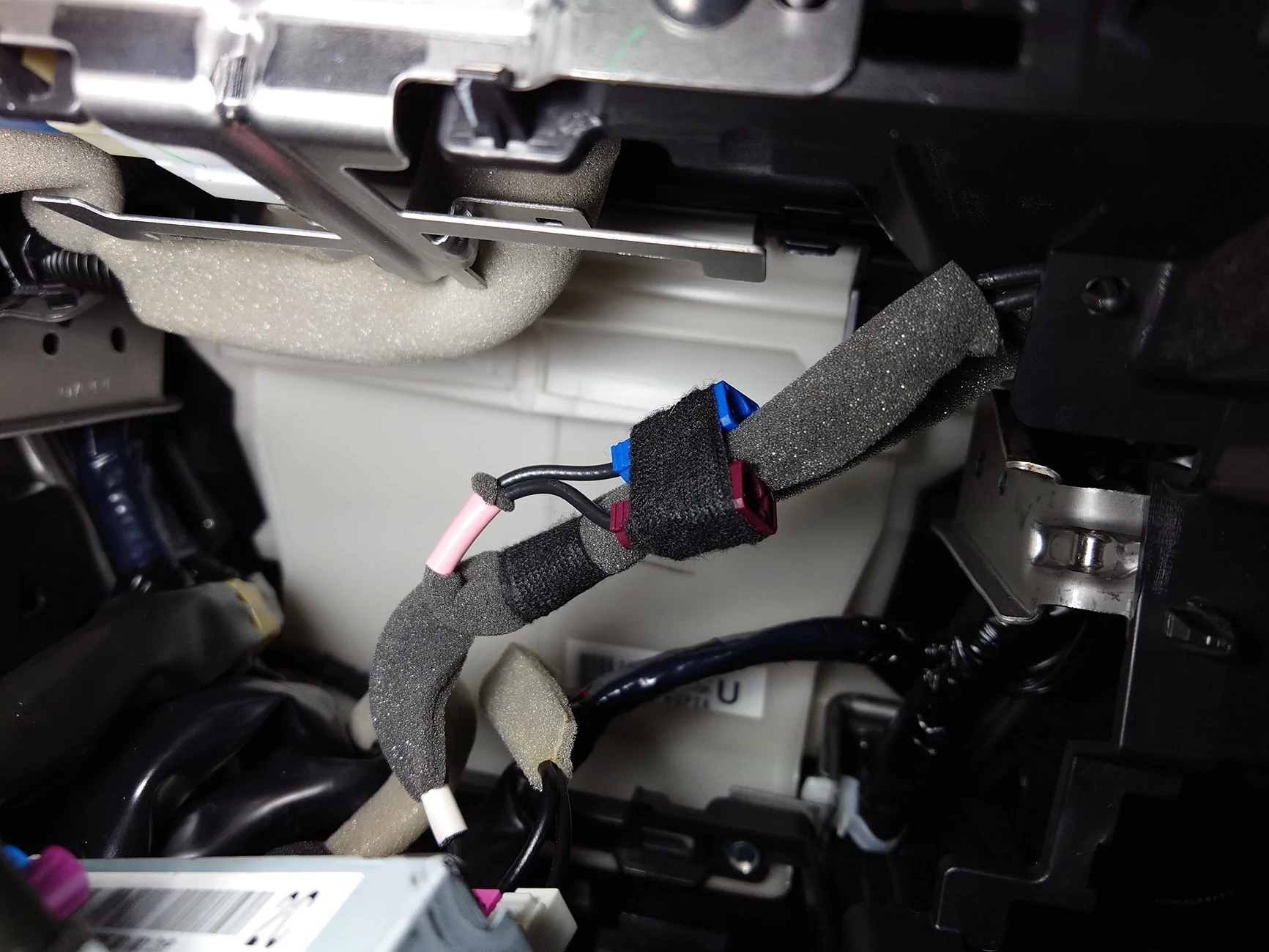

The plugs for the antennas are very loose and can rattle very easily. I chose to secure the plugs and their cable with fabric tape to the other cable coming down from the same location.

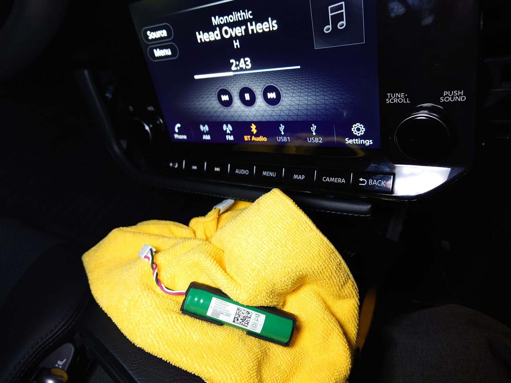

The TCU contains a lithium ion rechargeable battery. I assume this allows the TCU to communicate at all times. It can be removed without affecting the functions of the head unit.
After disconnecting the TCU, the car can still receive GPS signal as normal, so the built-in navigation system still works. I drove the car for a while afterwards and no fault codes appeared.

Ok, new one for me, I didn't realize there's a battery back there! Glad you pointed that out, I wonder if there's one in my Titan also.
Lithium ion batteries can self ignite, if it did, your car won't survive. Now there's two reasons to get after it!
