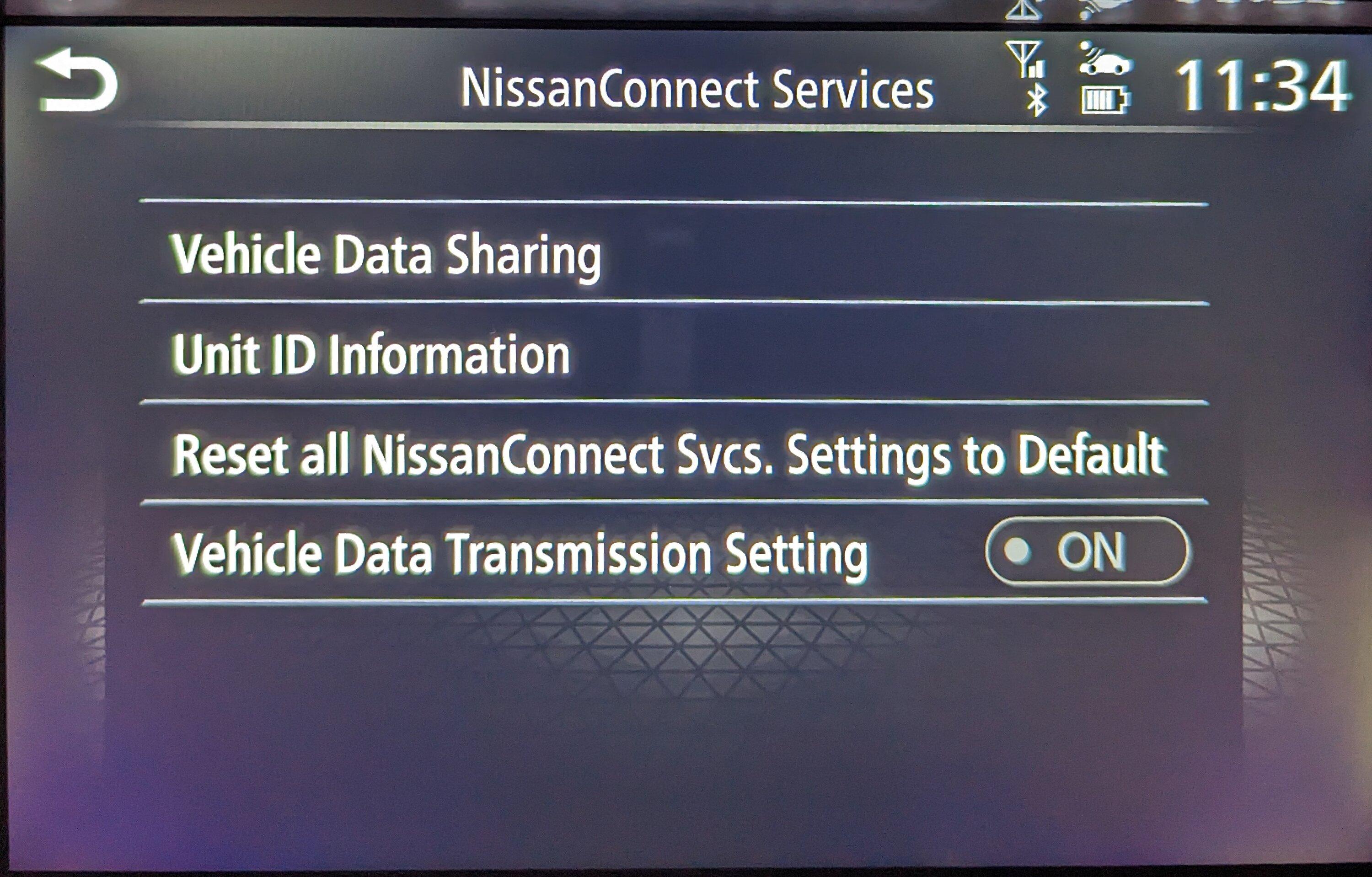

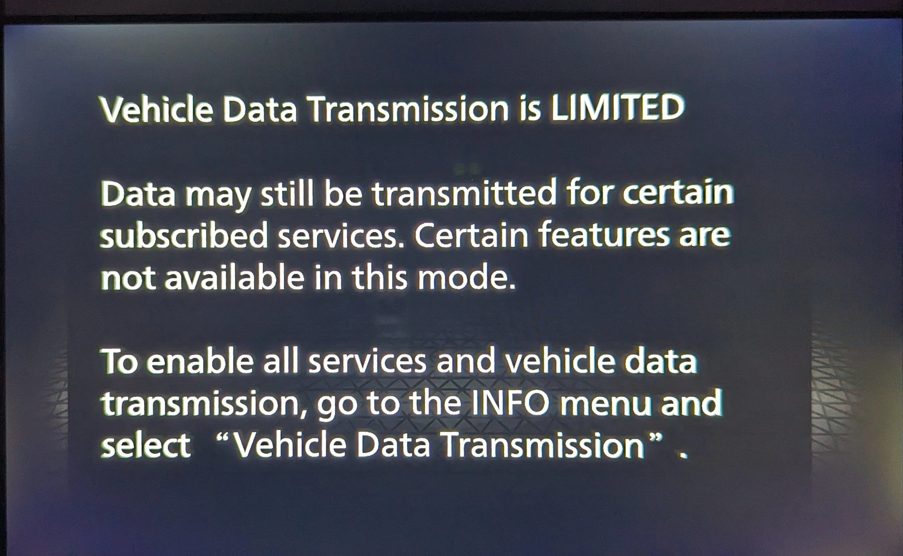

I came across this thread while trying to figure out how to disable the "Vehicle Data Transmission" legalese startup screen. This one.
I have not figured out a way to disable this screen. 😞 I don't need to see this every time I start the car, and it seems like it inhibits Android Auto from starting quickly.
On the other hand, I think I have figured out how to minimize or disable at least some of the data collection. In the settings menu it seems that you have the ability to turn off at least some of this.
Settings -> NissanConnect Services
Turn off Vehicle Data Transmission Setting

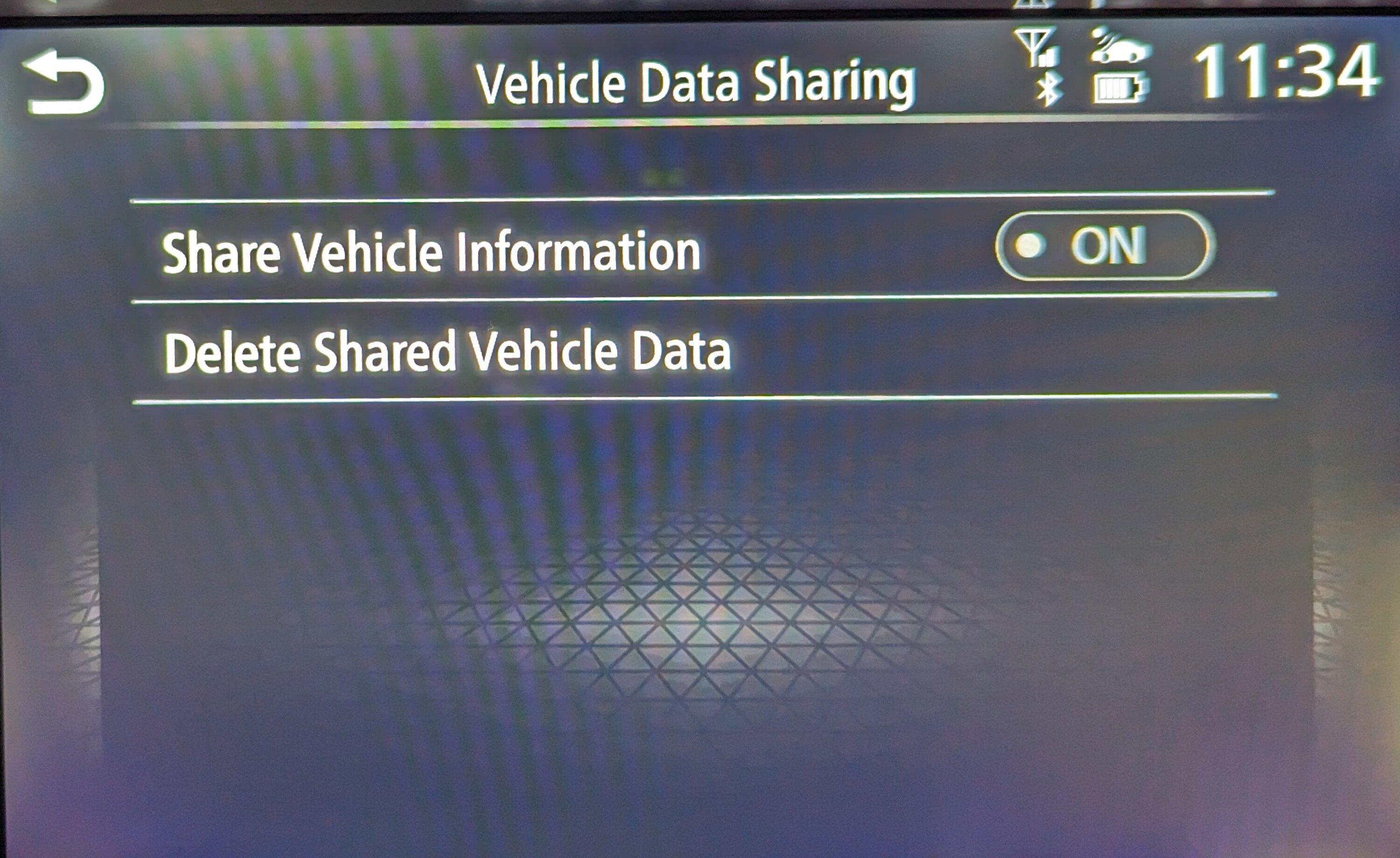

And then in Vehicle Data Sharing you can also turn off Share Vehicle Information and you xan also Delete Shared Vehicle Data.
Note that Nissan seems to really want these settings to be on, so if you enter certain menus, it will be turned on again. That behavior seems a little devious and doesn't inspire a lot of trust. If you want to keep these disabled, it might require diligence to check again after poking around in the menus.
