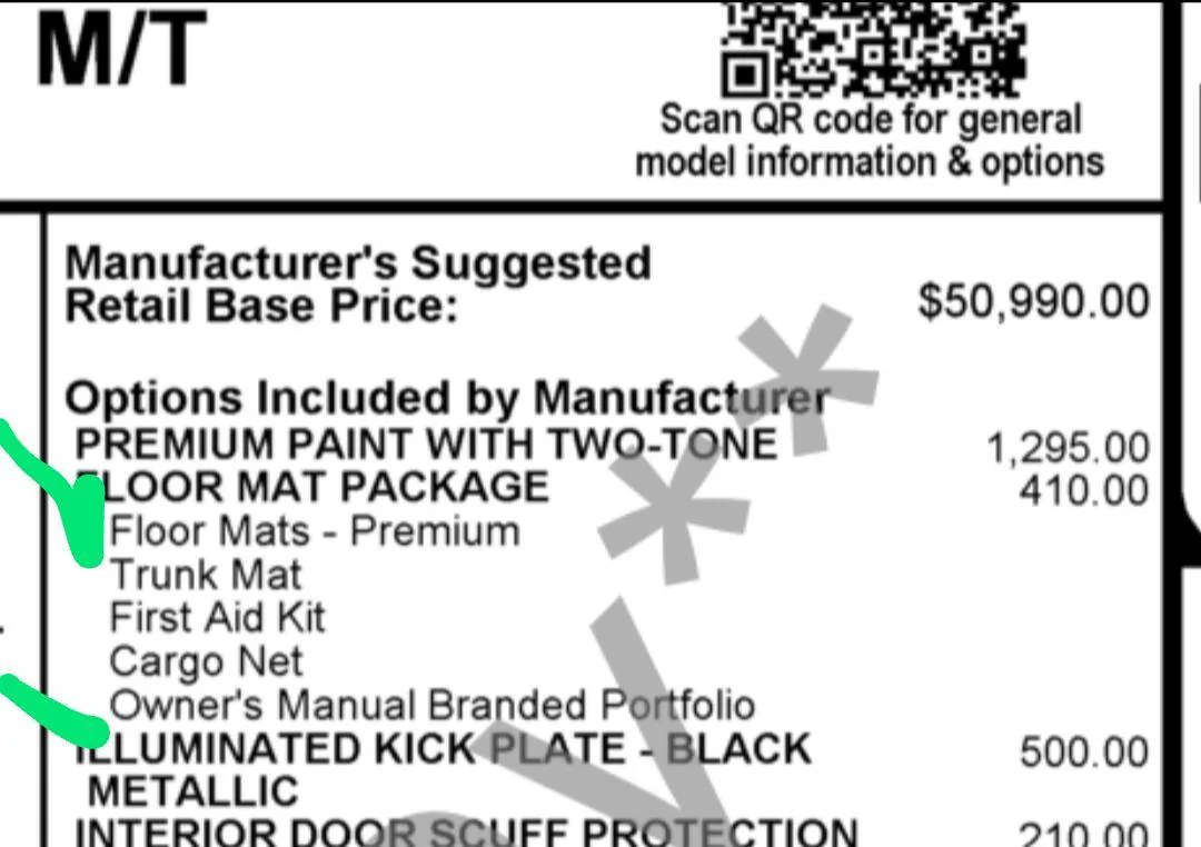

What options did you get? One of the things that makes the car feel a bit more "upscale" for me are the fancy floor mats and illuminated kick plates.

@bpeckham thanks for the input. I got the car from Carmax so I have a 10 day return window for me to make up my mind of if this car is just too much sports car and not enough GT for me. I've got the carpeted mats and illuminated kickplate.
