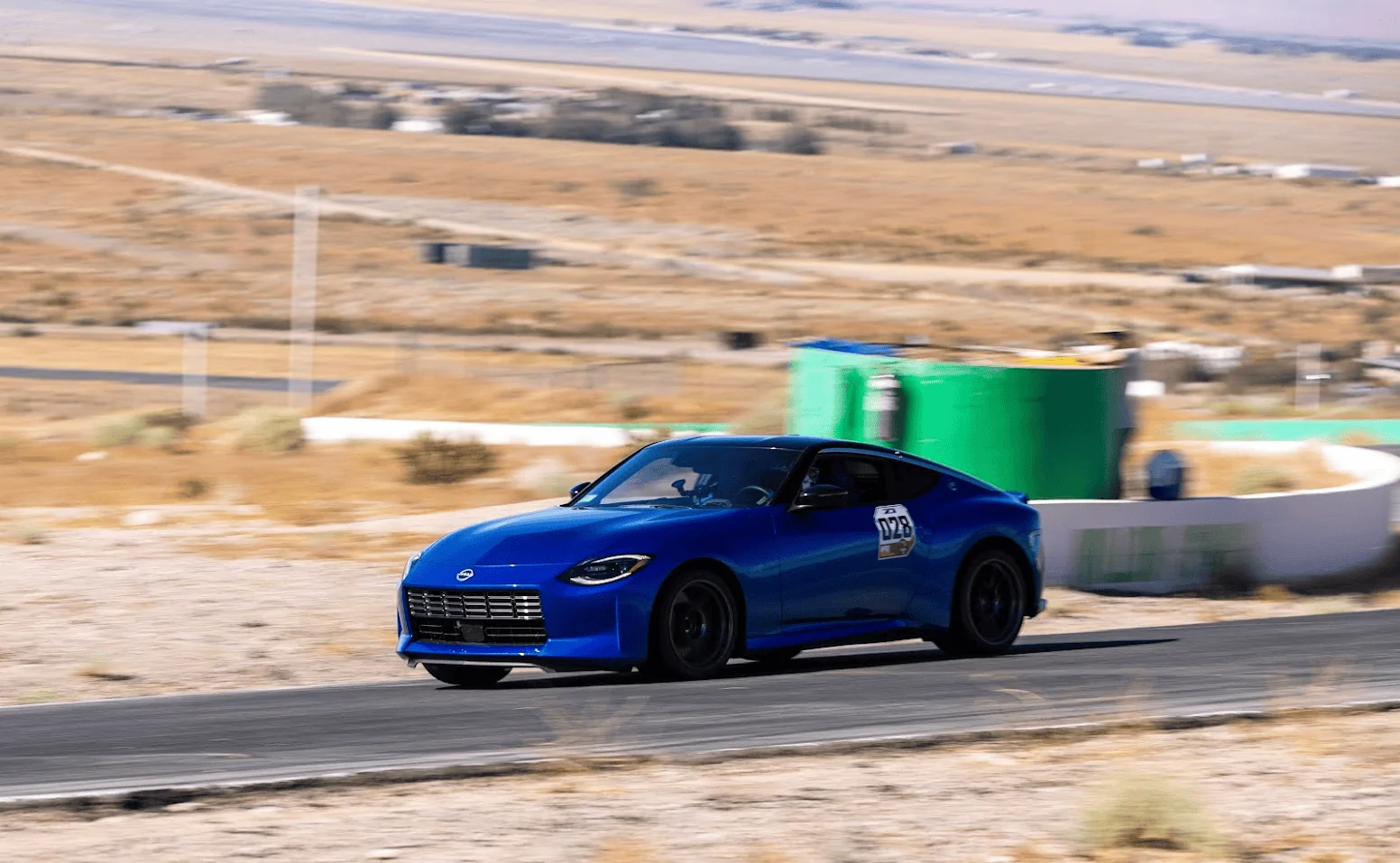

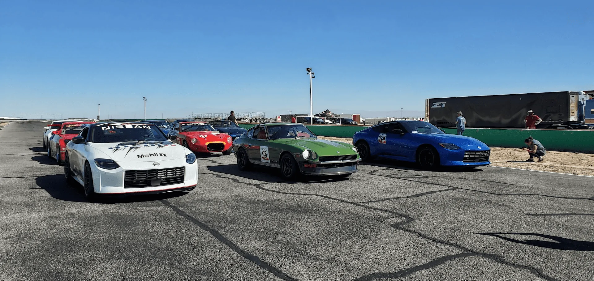

PFA - A couple shots of my new Z at Willow Springs International Raceway during ZCON 2023 in So Cal.
