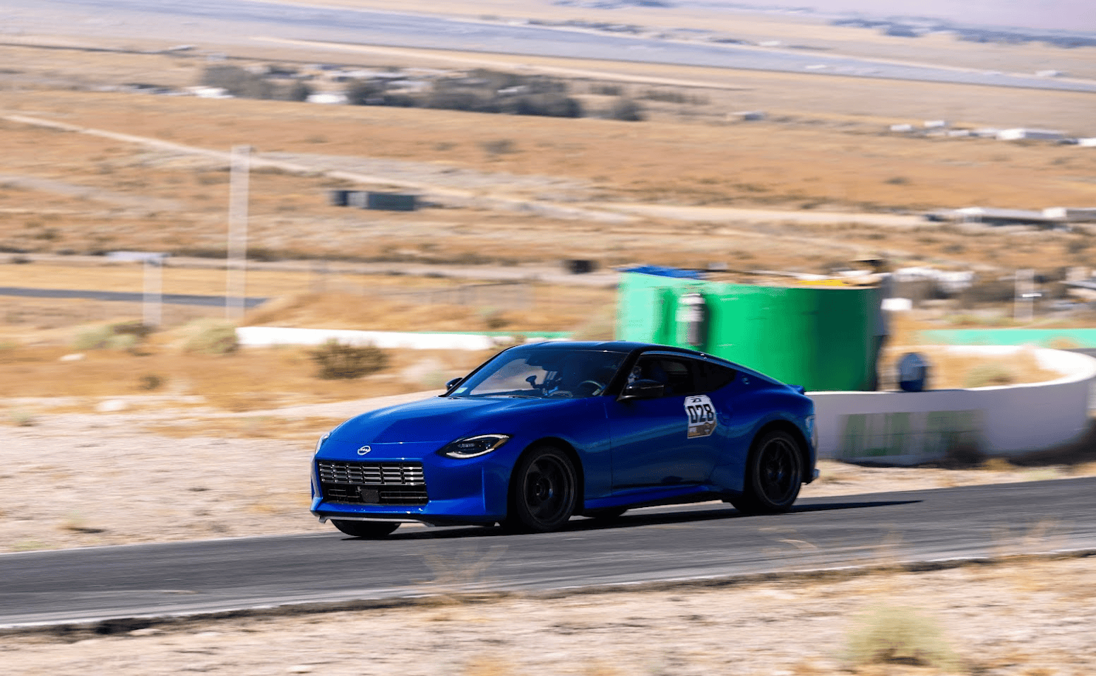

PFA - A couple shots of my new Z at Willow Springs International Raceway during ZCON 2023 in So Cal.

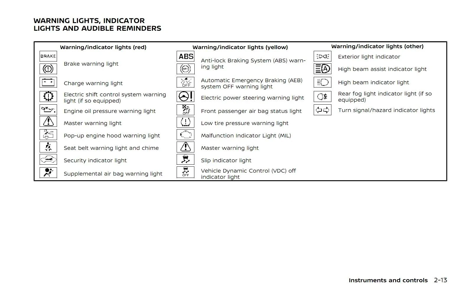

The brake light switch method by itself only got me part of the way there (slip indicator light, AEB off light, dash notification of malfunction) but traction control was definitely still kicking in. I only needed to hold the brake light switch up for about 1 second before this condition was triggered, though only the slip indicator light came on until I put it in gear for the first time. I tried holding the brake light switch up for as long as 20 second but nothing else happened.
