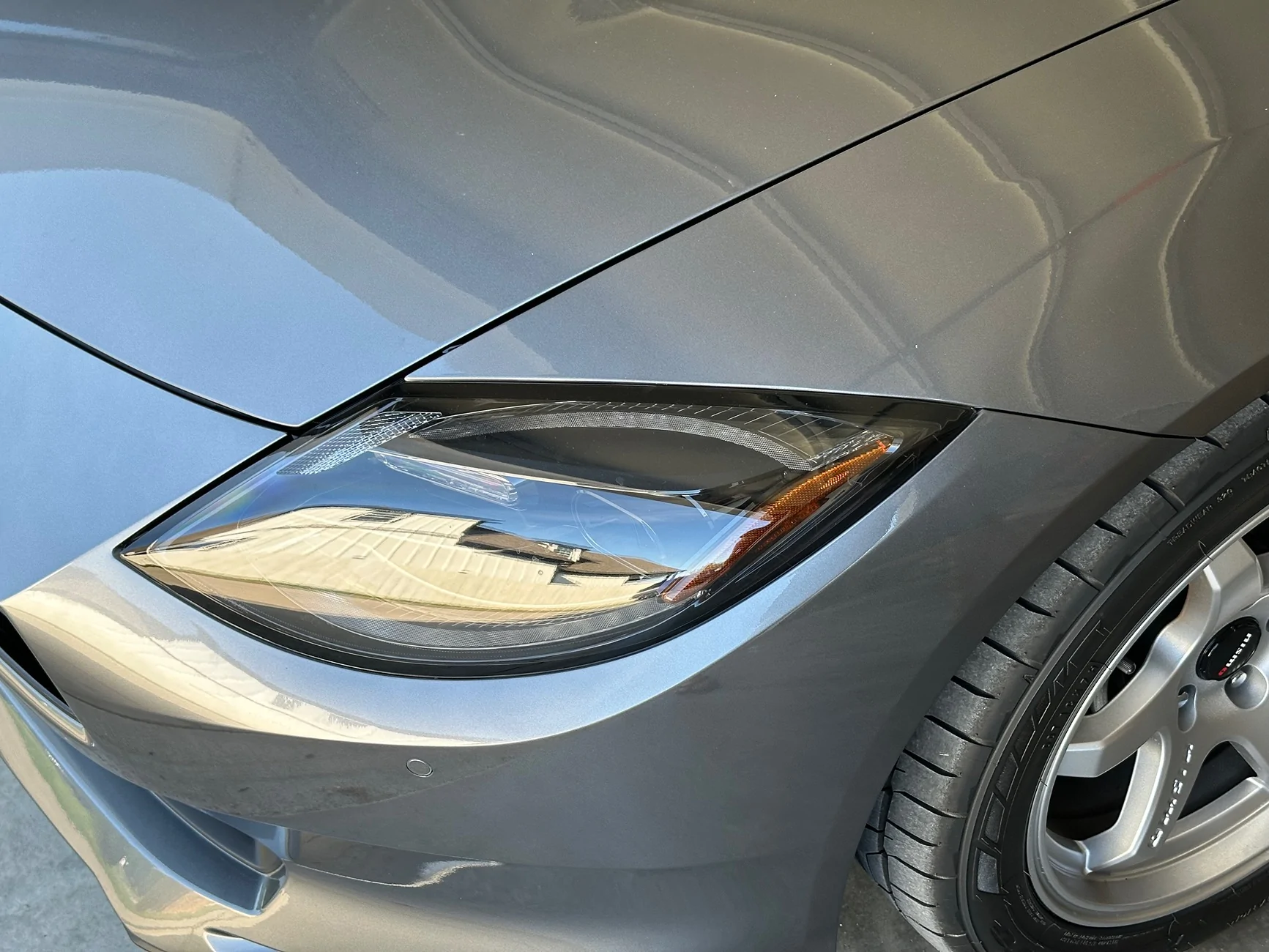

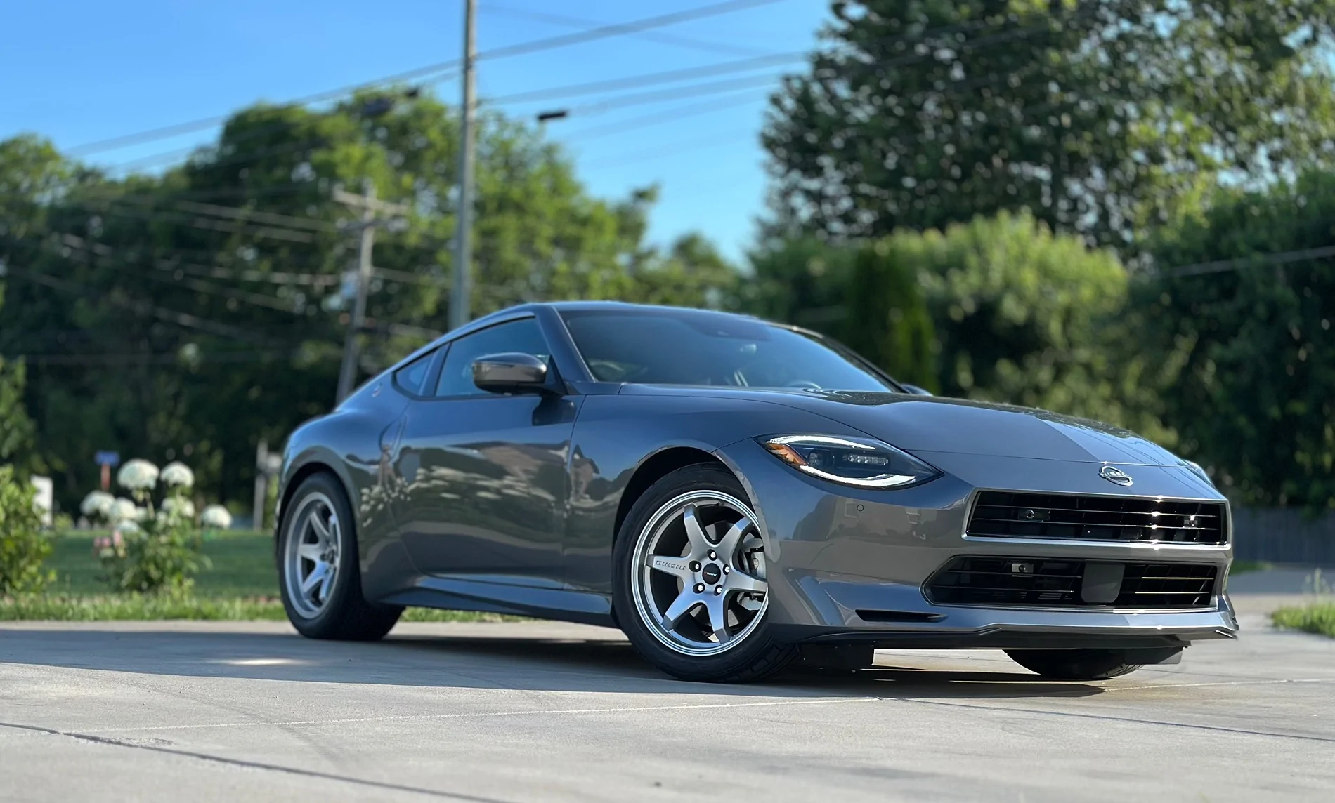

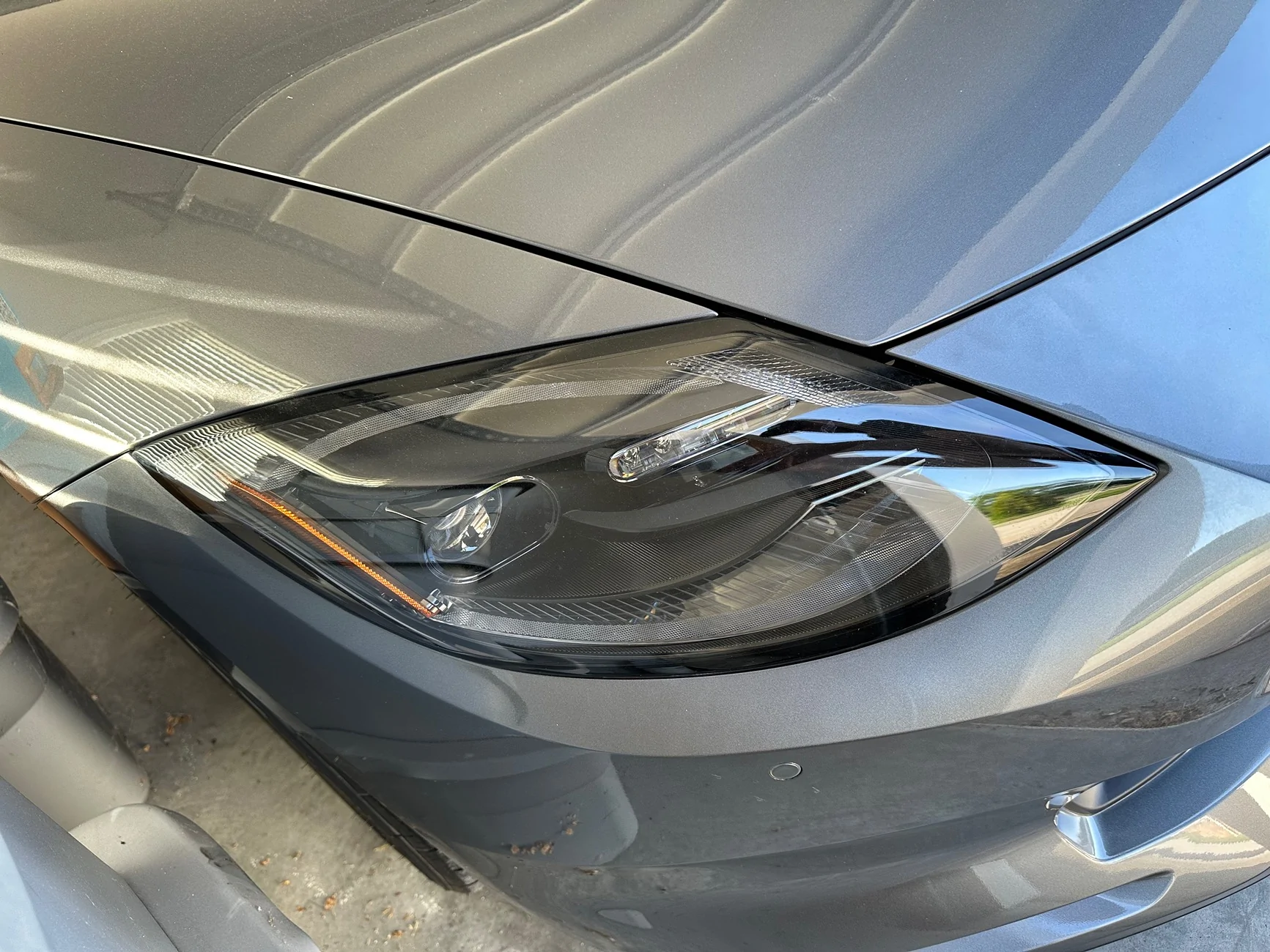

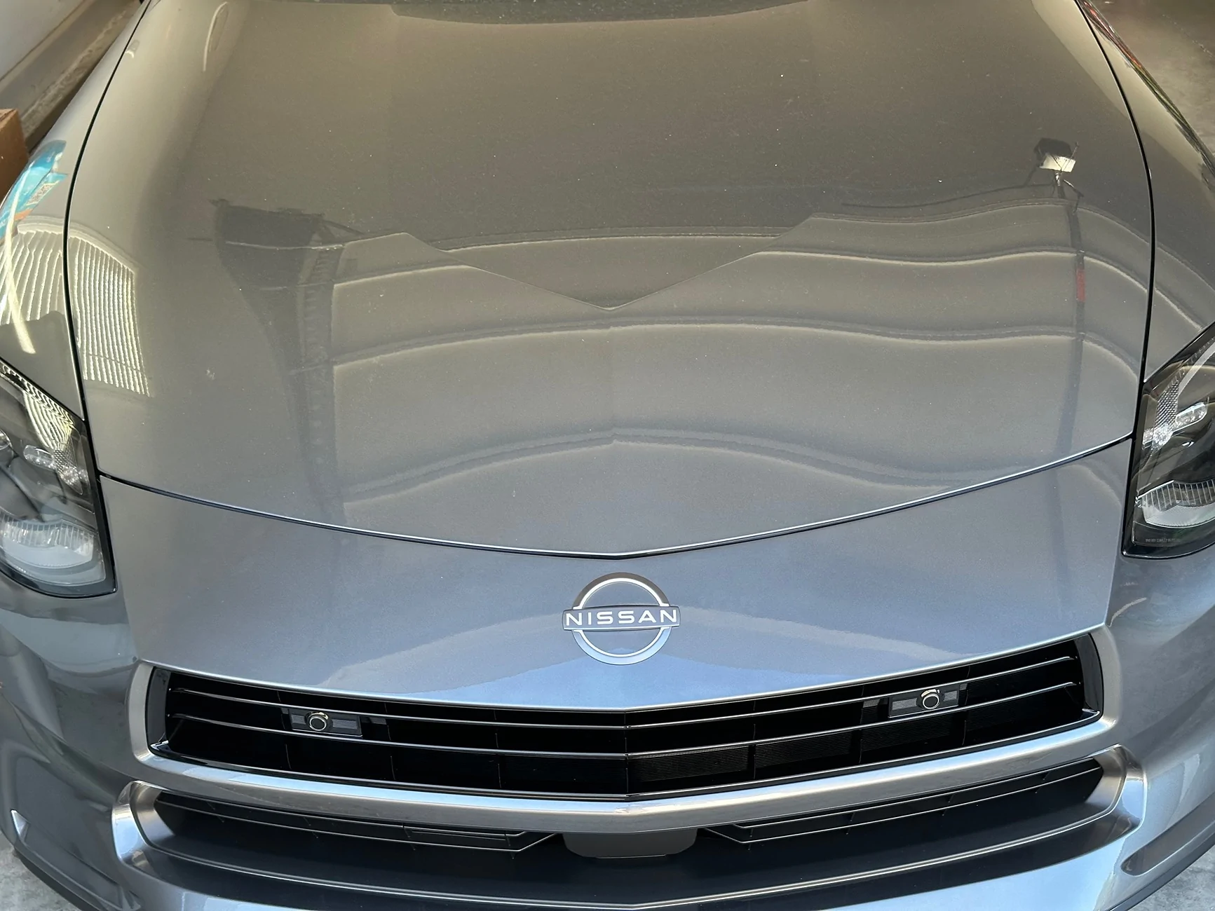

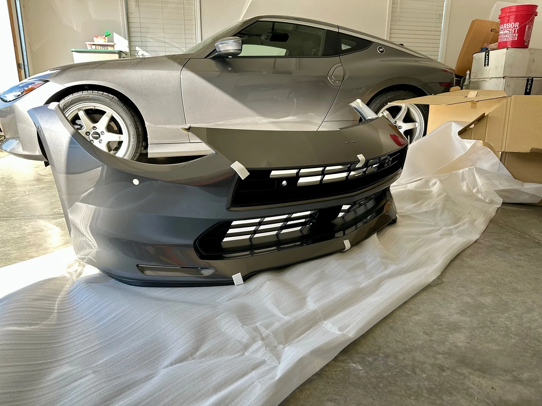

On and I love it! The kit and instructions that came with it from Nissan were excellent. Fit and finish is like OEM. I mean, duh, but it’s always iffy when talking about body alignment. The cleanliness of the harness and everything going on behind the bumper is really satisfying. Gaps around the hood, lights, and fenders are all perfect, but it took me a little bit of wrangling to get there. I was also worried about color match, but it’s spot on. Very very happy with it.

Love the subtle tweaks you’ve been making 👌 Been following your progress for a bit. Car looks great! How’s the dip holding up on the wheels?

Thanks! Dip is good, but I’ve really only put ~250 miles on it. I love the color combo though, I think I’m gonna commit. Next mod will probably be powdercoat. Now I have to decide on which silver I want! :crazy:

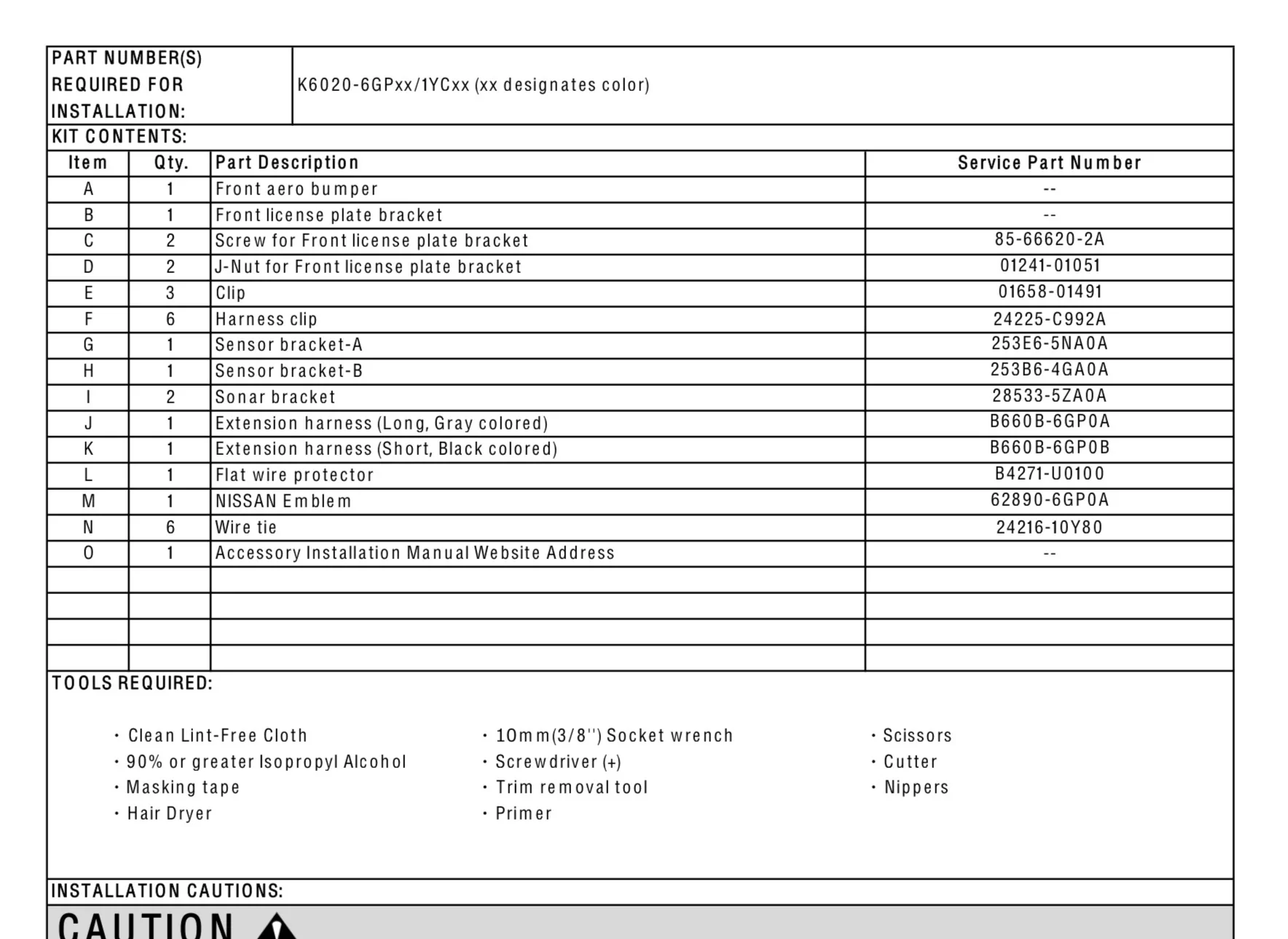

Does the kit include the front grille and everything needed? It looks great

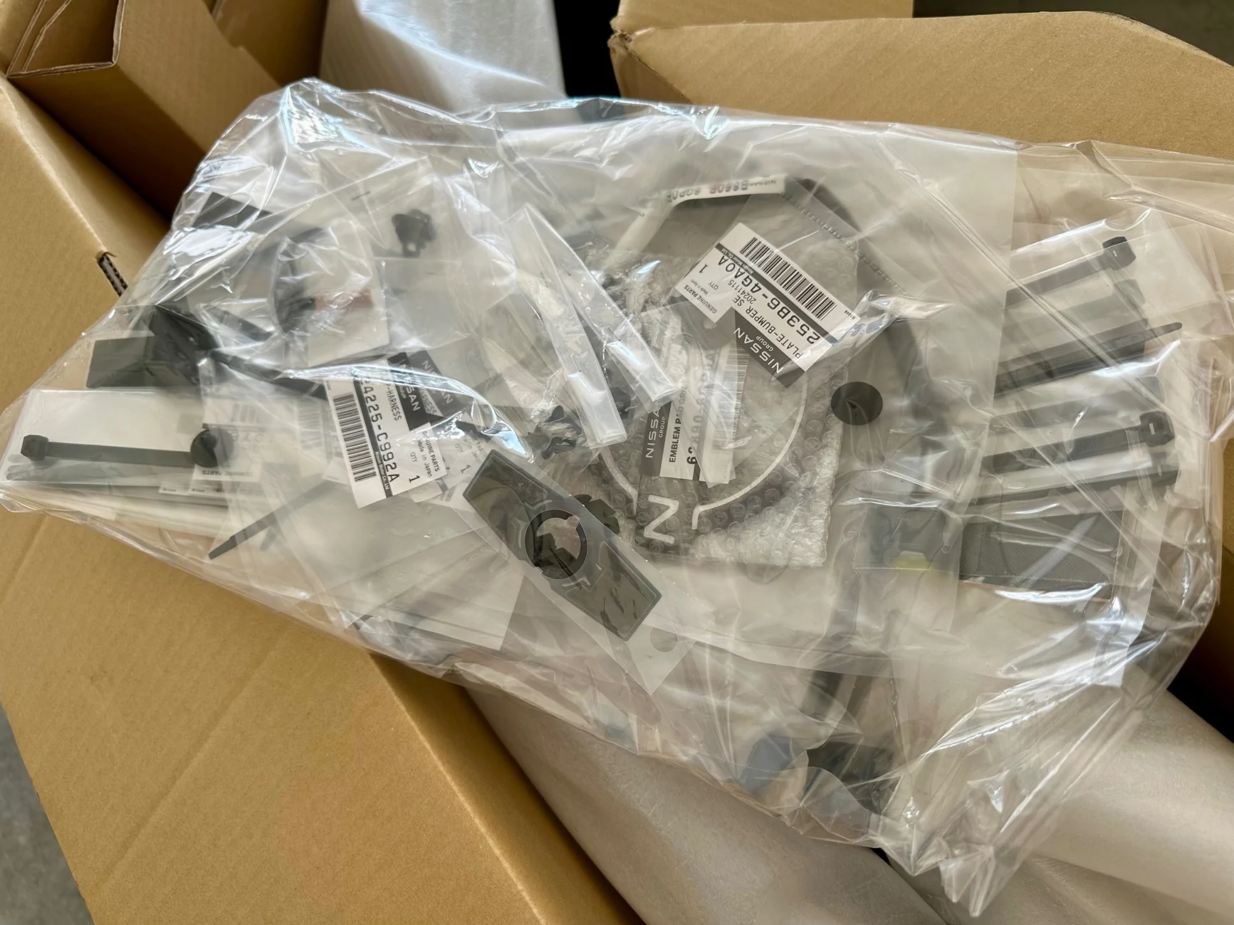

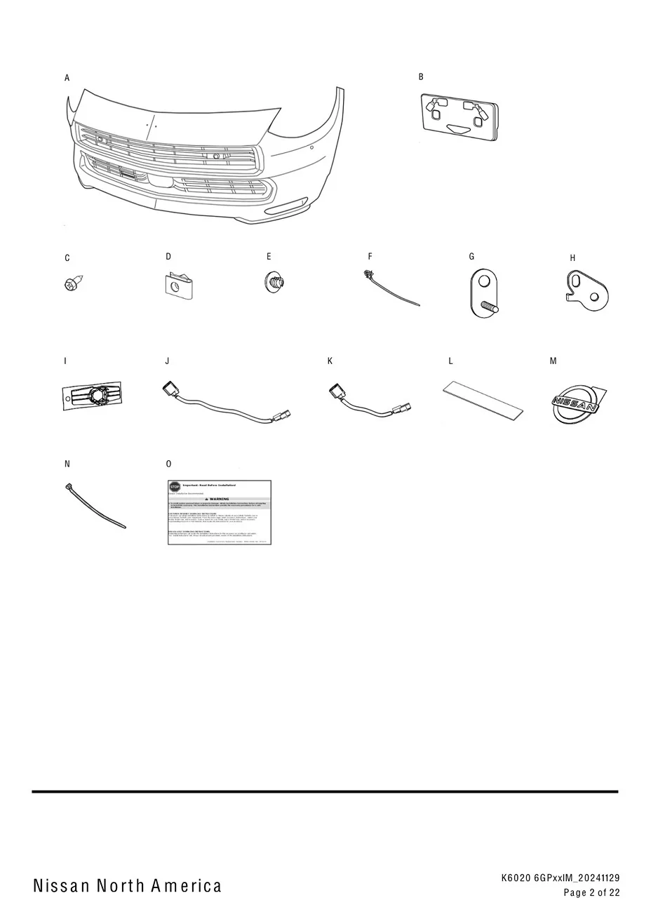

Yes, includes the fully assembled fascia, all required hardware, and a kit to transfer the bumper harness over to the new fascia.
Here is everything included, from the installation manual:

Thank you for posting that I'm trying to track down all those sensor brackets for a bumper install.
Could you share the installation manual website address? Thanks!

HOWEVER, I want to reiterate, since it’s on Pg 1 and this thread is getting a lot of new traffic: Nissan will NOT let you order this part if your car wasn’t ordered with the heritage bumper from the dealer. These parts are on hold for warranty and repair. After you order, they will do a VIN lookup, and if your car didn’t come with the part, they will cancel the order.
I threw away the placard that had the link, but I saved a copy. I’ll host and share it later when I get home.
