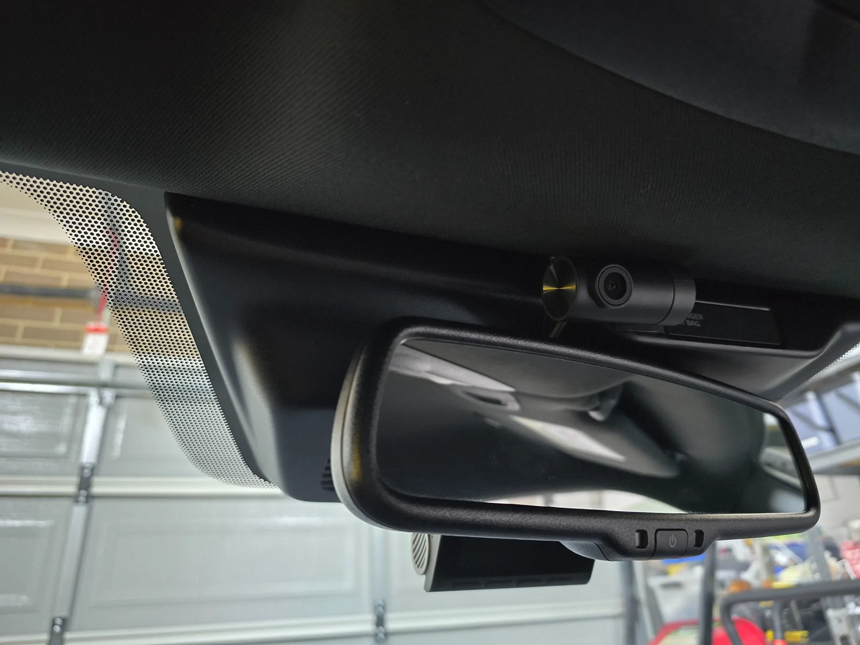

I bouught a 70mai 4K front and 1080P rear dashcam. I didn't want to have any power cables dangling or sourcing power from the fusebox. So like others have said, I piggybacked power from the rear view mirror and bought extra short USB cable for the dashcam.
Another thing I didn't want to do for the rear dashcam was to have cable exposed on the rear hatch, so I ended up putting the rear facing camera just above the rear view mirror, and cut off 95% of the cable and re-soldered it. It's a compact little set up and barely noticeable when driving.
Another good option. I like that it is tucked up a bit. I find the view angles are already restricted with the large rear view mirror so every bit helps.

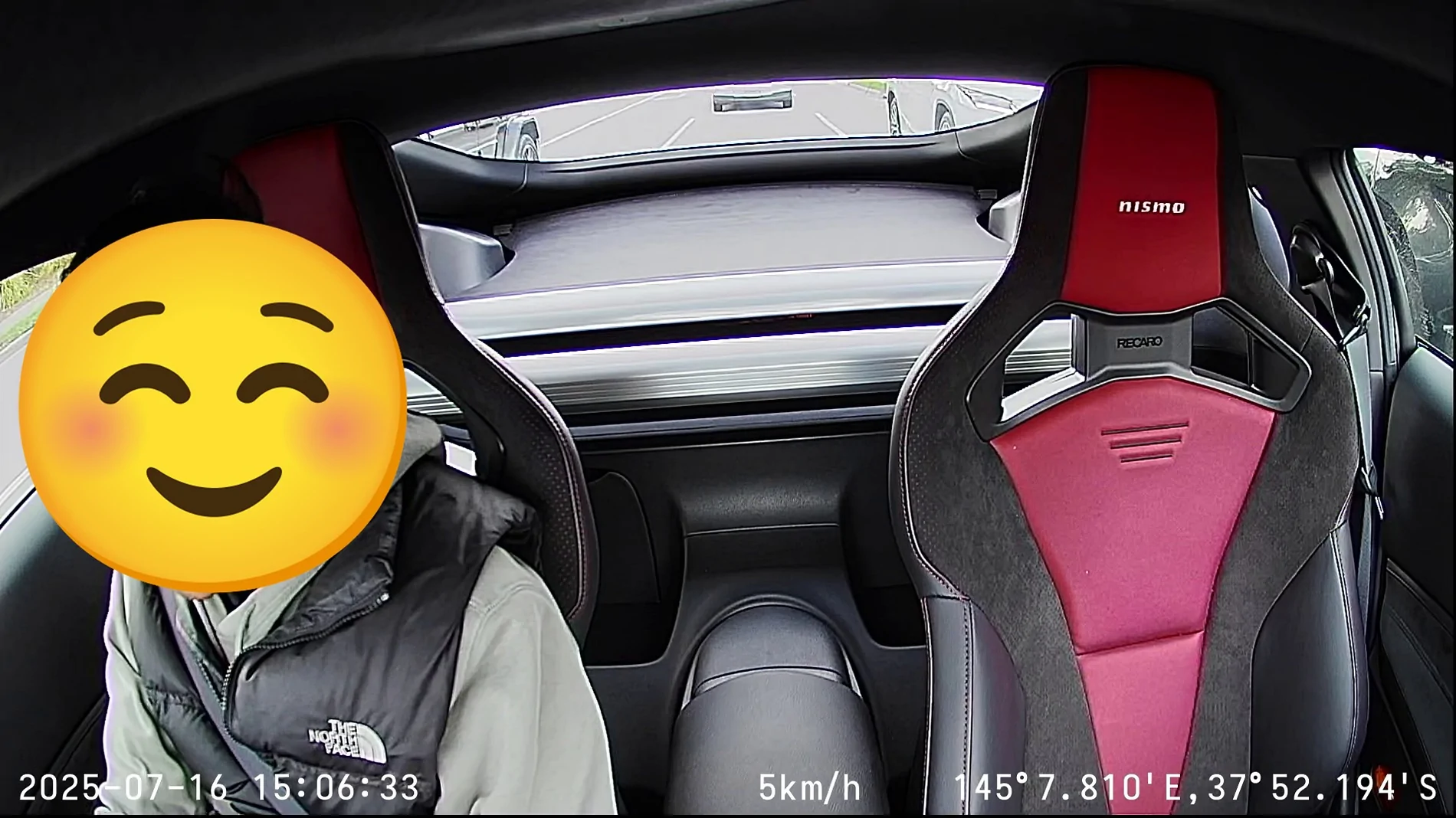

What does the video look like with the rear camera installed there?
This is the rear camera, which I just realised it's slightly tilted which I'll now fix. But I think this is enough to see the rear and both rear quarters, as this only meant to compliment the front camera, I personally much prefer this set up than having too many components spread out in the cabin.

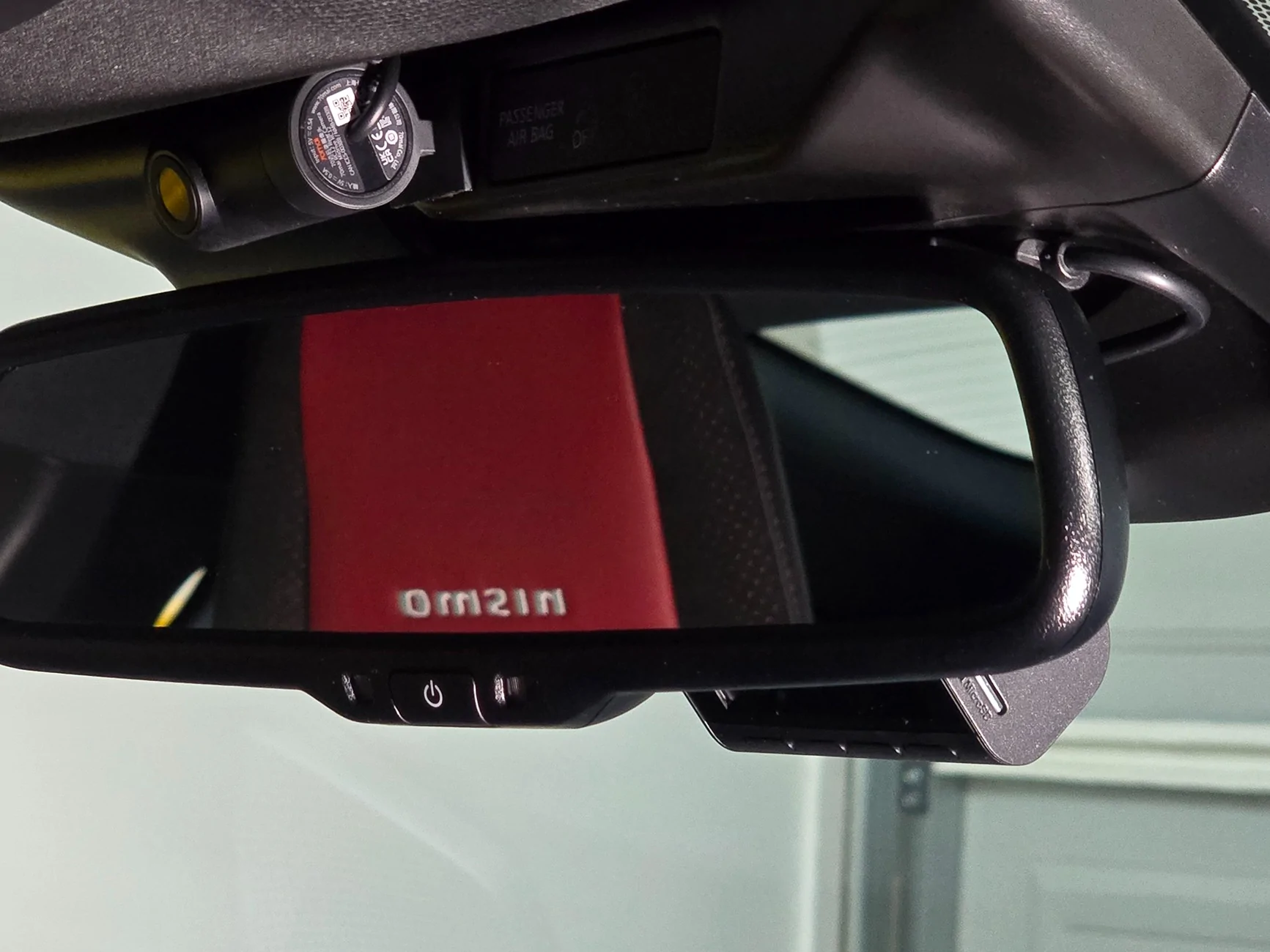

Yeah, I'm definitely of the opinion that dashcams shouldn't be seen or visible when you're driving.
Can't see anything in the rear tho, not sure if it will be helpful if anything occurs in the rear.
I also have the 70mai and I have my rear cam installed on the rear window, I don't see it except for a bit of a wire dangling.

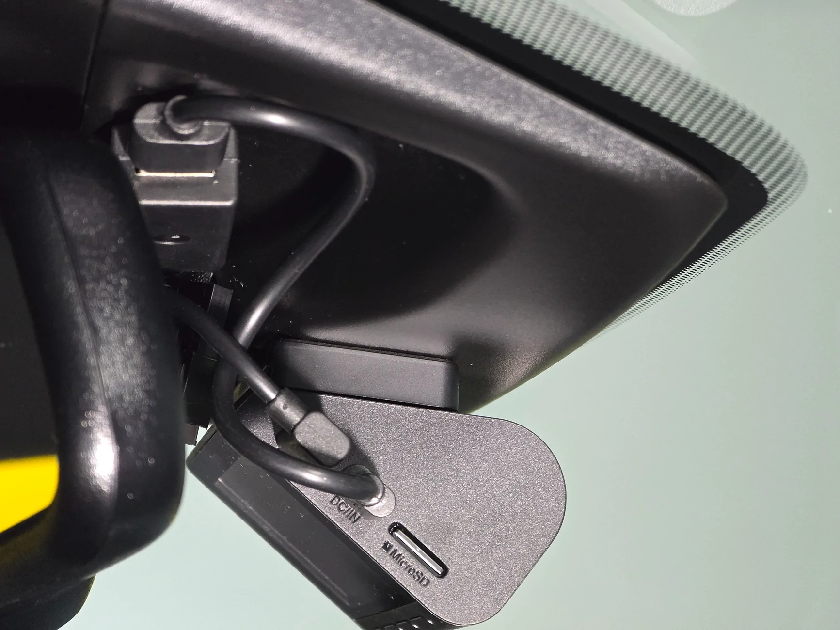

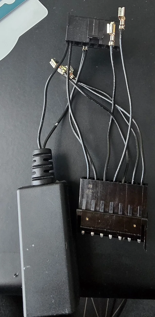

If your mirror is the same, then it is a 7 pin OEM plug, which only comes with accessories (not constant power) and ground. Whereas the Homelink mirrors that you guys get in the US, has 10 pins, which also has constant power if you want continuous recording.
If I had the 10 pin plug, I would have opted for something like this:
https://dongar.tech/en-ca/products/dongar-pro?variant=46722691268832#learnmore
Having the ability to turn on/off continous recording, mainly when I park for an extended period.
But I ended up with this:
https://www.aliexpress.com/item/100...order_list.order_list_main.101.5cee1802AdfkW6
And since only 2 out of 7 pins/cables has a purpose, I removed the remaining 5 to make it even less visible:

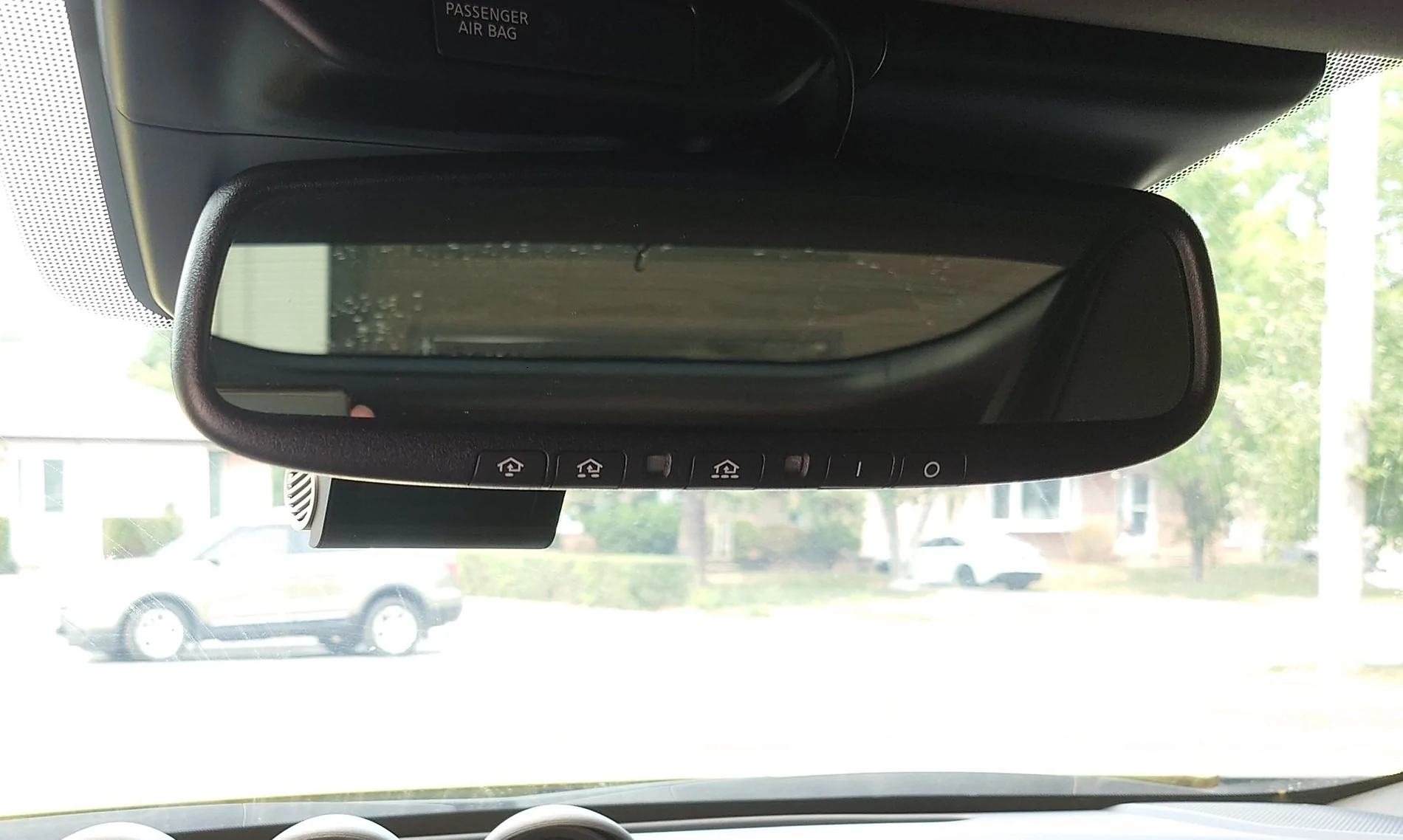

This is what I see with my setup in the rear view mirror.
I may upgrade to the Homlink mirror. Not just for the always recording feature but more because I prefer to have the door activated by the car.
