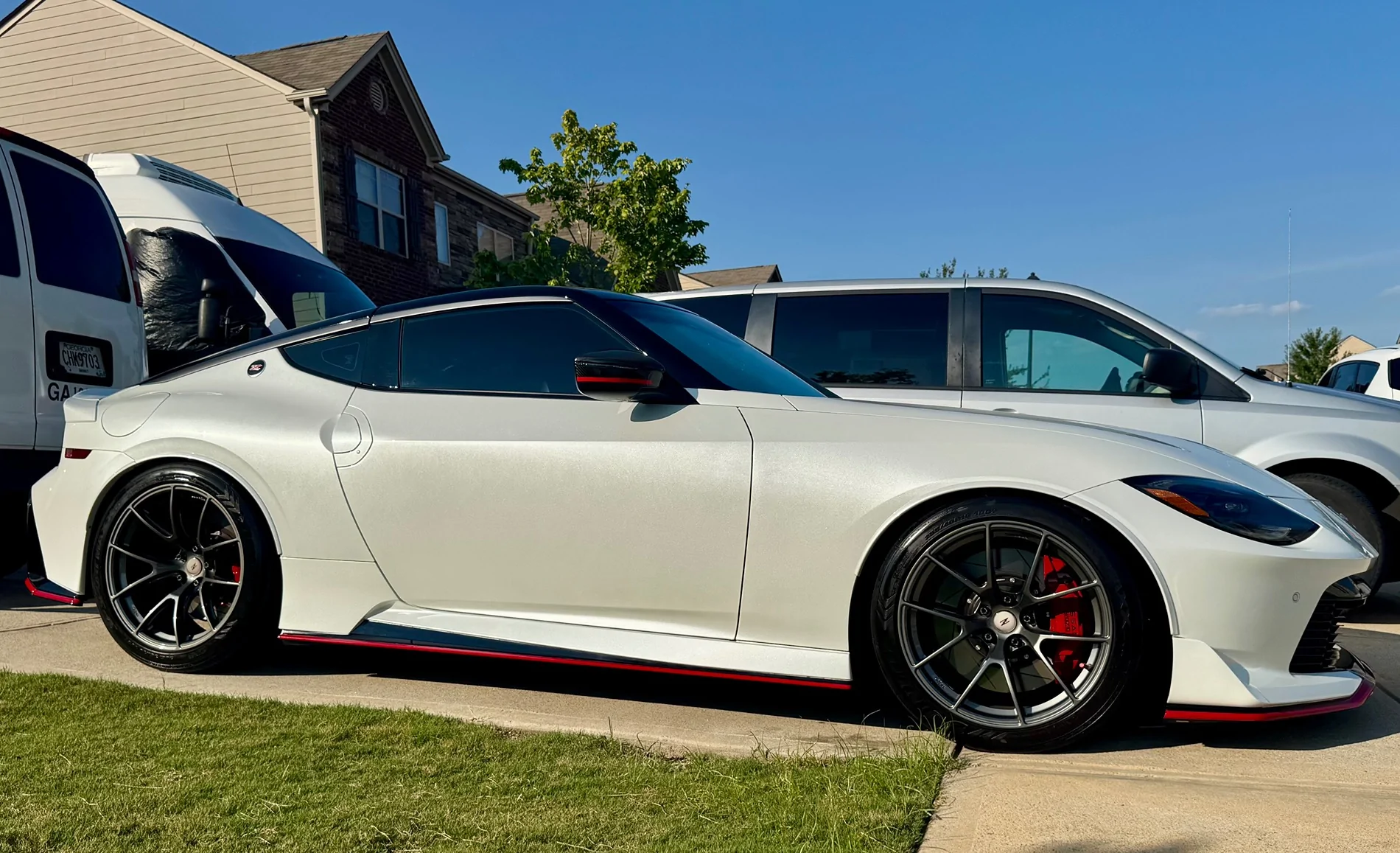

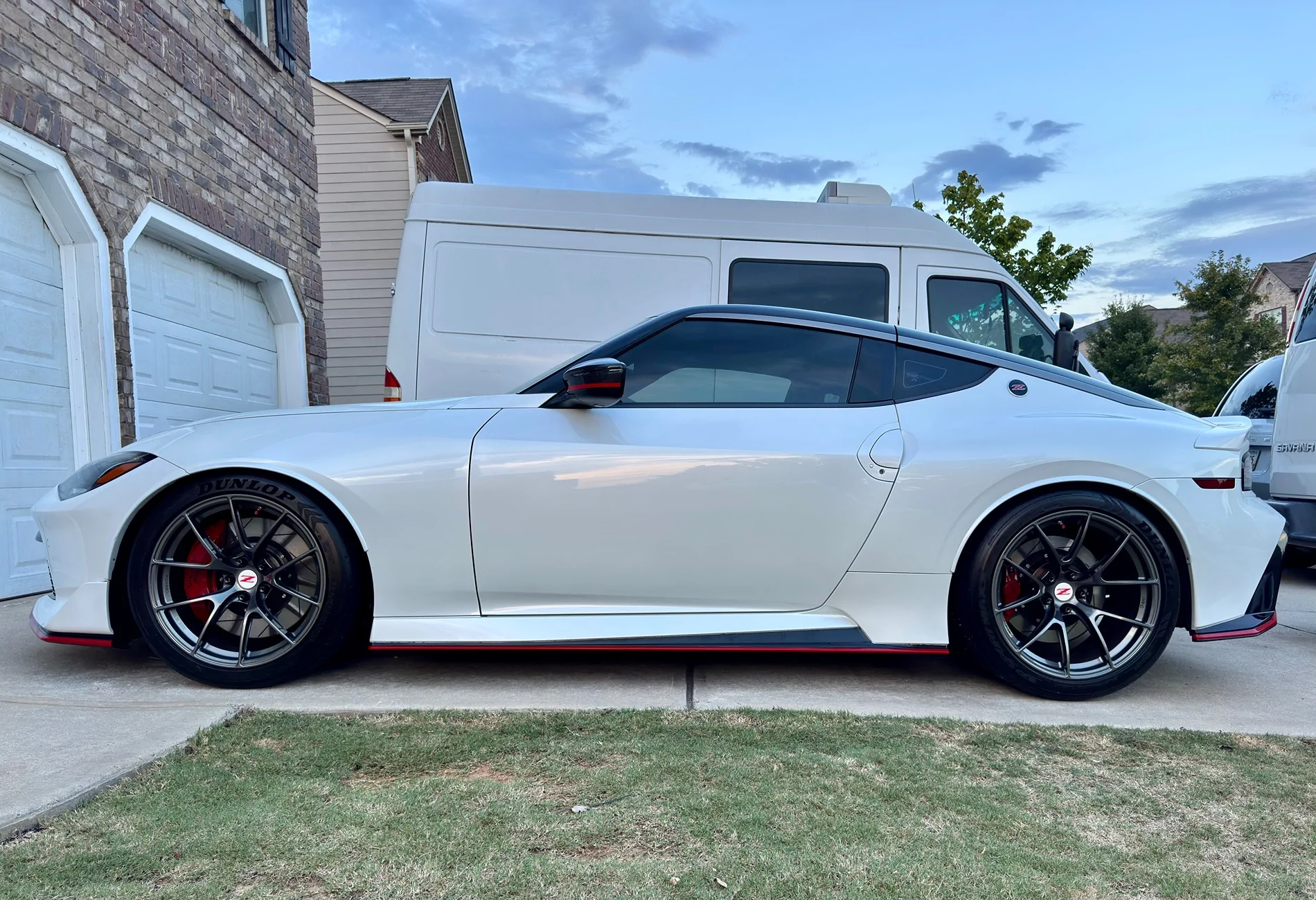

I think Sportlines might be too much towards looks vs performance. I have their Pro Kit an that’s 1.2/F 1.2/R
I show the Sportlines as discontinued. 2" drop would be extreme on this car. Your car on ProKits looks great!

Exactly it would look a bit too "stance-like" and eat up a ton of suspension travel.

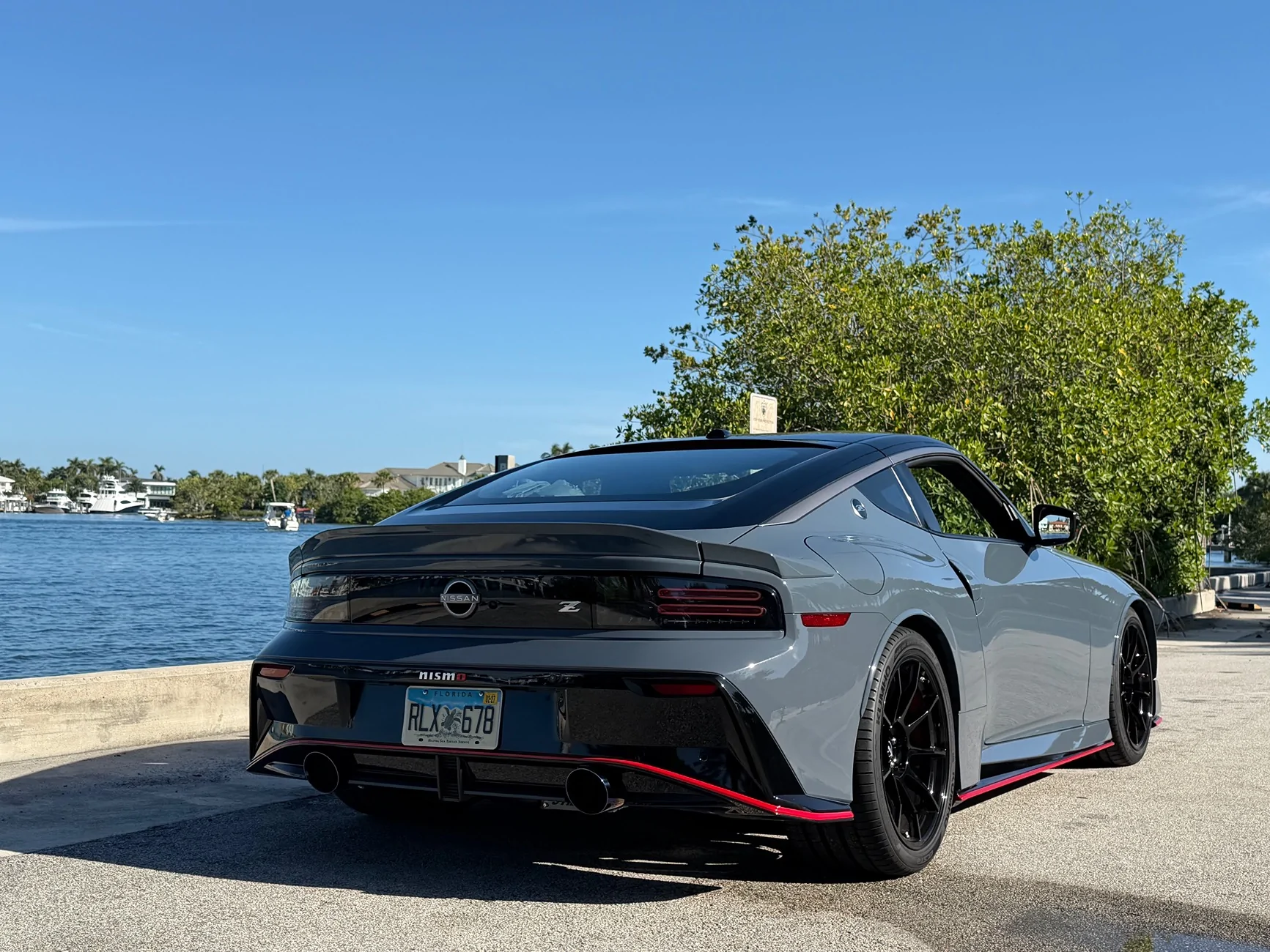

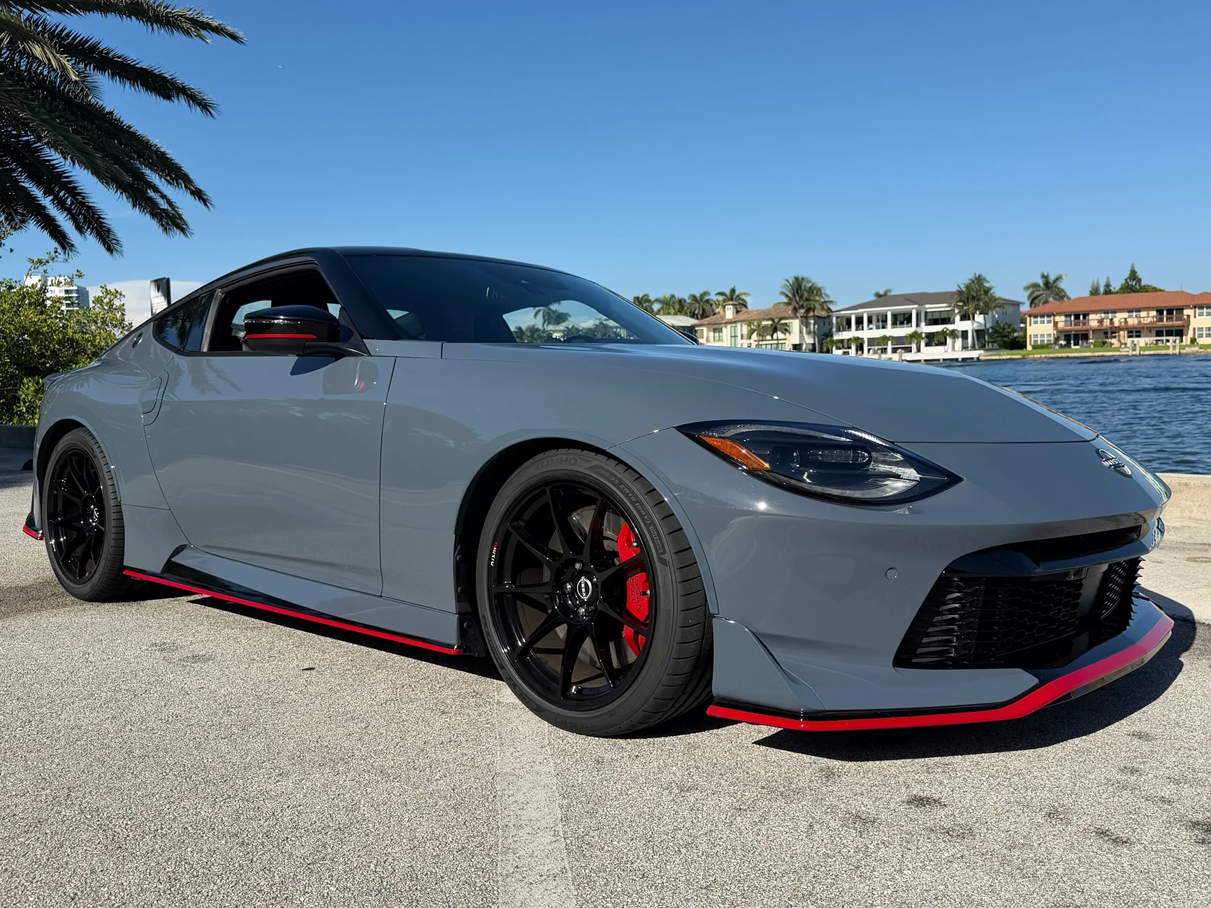

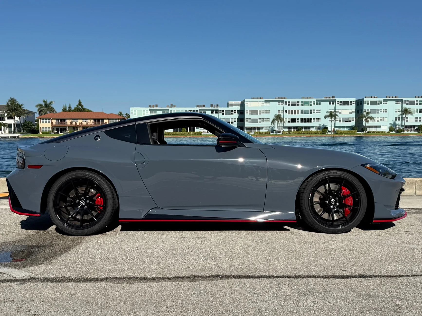

I put the pro kit on mine as a 35 year lover of eibach springs. Ride is better and the look is perfect IMHO. Also installed 265/35/19 and 305/30/20 kumho s tires which are amazing by the way but they run a little skinny.
Car is night and day better but in fairness the Dunlop’s were hard and starting to weather crack despite only being 2 years old.

My mistake as I meant to put 19 not 20 as they’re the stock Nismo wheels.

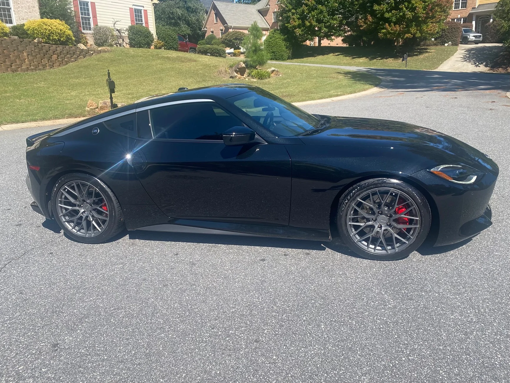

Looking at these, anyone familiar with them for the Z, wanted to know about clearance issues, modifications or shaving of parts, or having to replace control arms. They drop from 1.4” -2”, my main concern is performance and not looks. Any advice is helpful
I put Ohlins and dropped about a 1” had to go the route with front upper control arms sway bar links, rear camber arms and socks toe bolts
