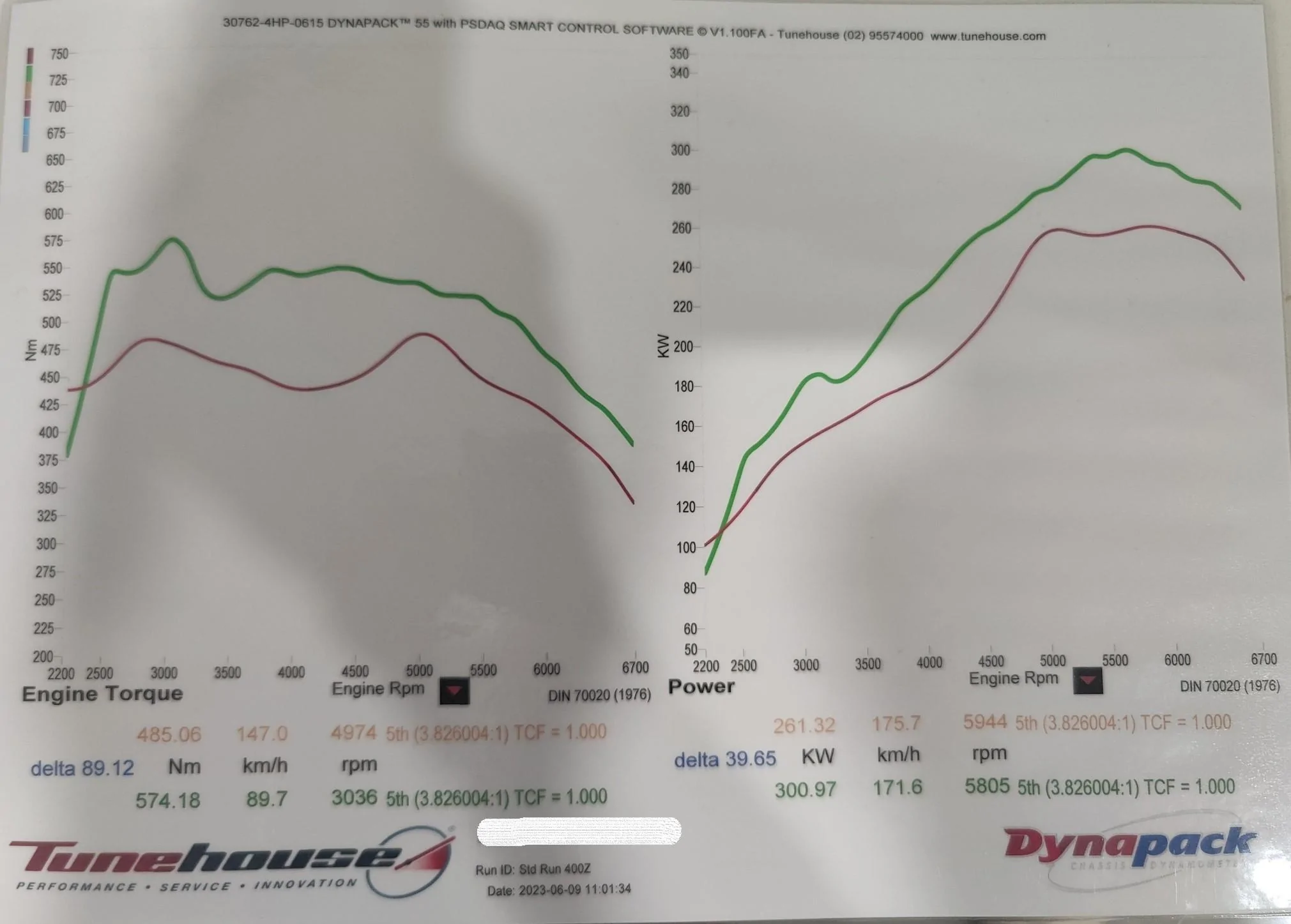

Anyway, the gains seem quite significant. An additional 89Nm of Torque (18%) and 40kw (53hp) of power (15%). It's now putting out 300kw (402hp) at the crank. The only other mod I have is a HKS dual muffler cat back exhaust.
In the graph the torque appears a little choppy but he said it can look like that because their dyno hooks up the the crank directly rather than having wheels on the rollers. I don't really understand but the delivery when driving doesn't feel choppy at all. I haven't driven it much yet but if anything the car seems to hook up better than it did before despite the additional power and torque.

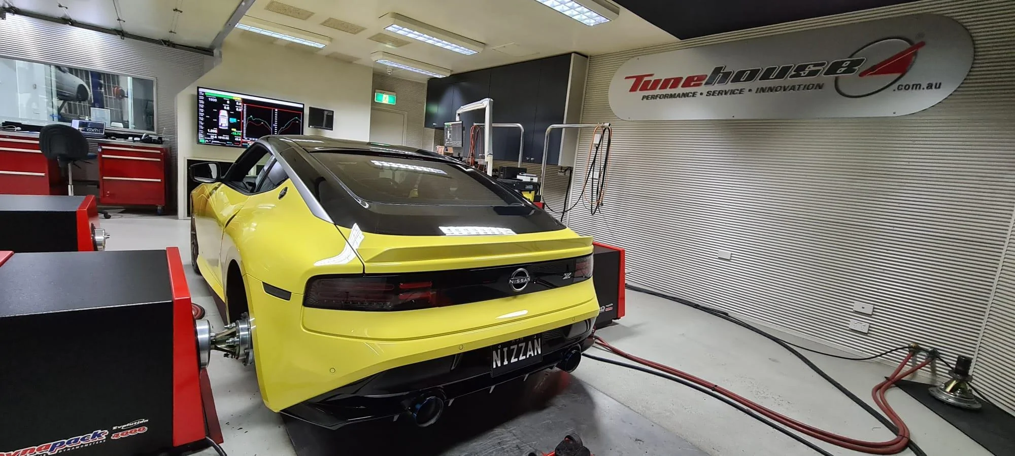

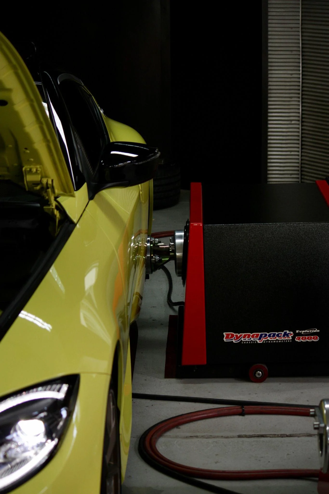

Some pics from the dyno. Wish they got a video for me. These guys have the cleanest workshop I've ever seen. Not just the dyno room, but the workshop itself is spotless.
The pics in your second post show a hub dyno not an engine dyno which hooks up to the engine's crank/clutch & flywheel

Awesome gains! Using those percentages... the factory power 298kw -> 343kw and torque 475nm -> 561nm would be felt!
