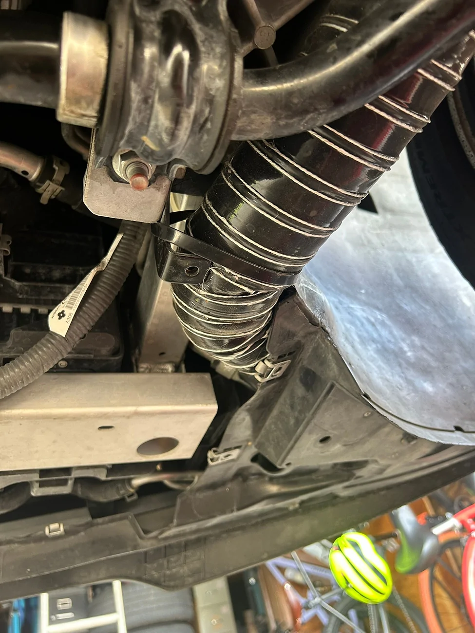

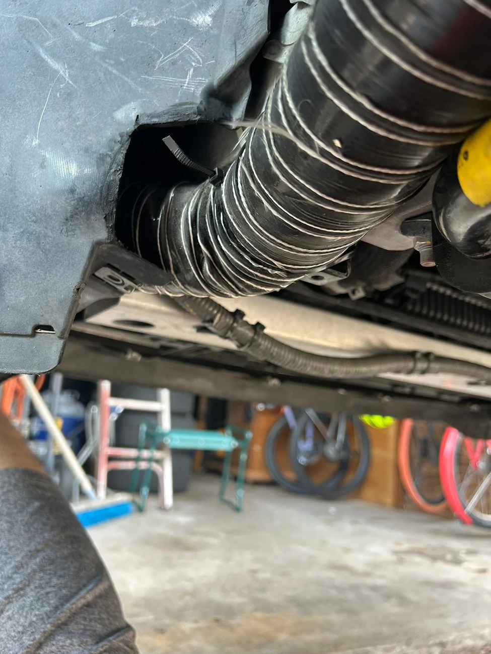

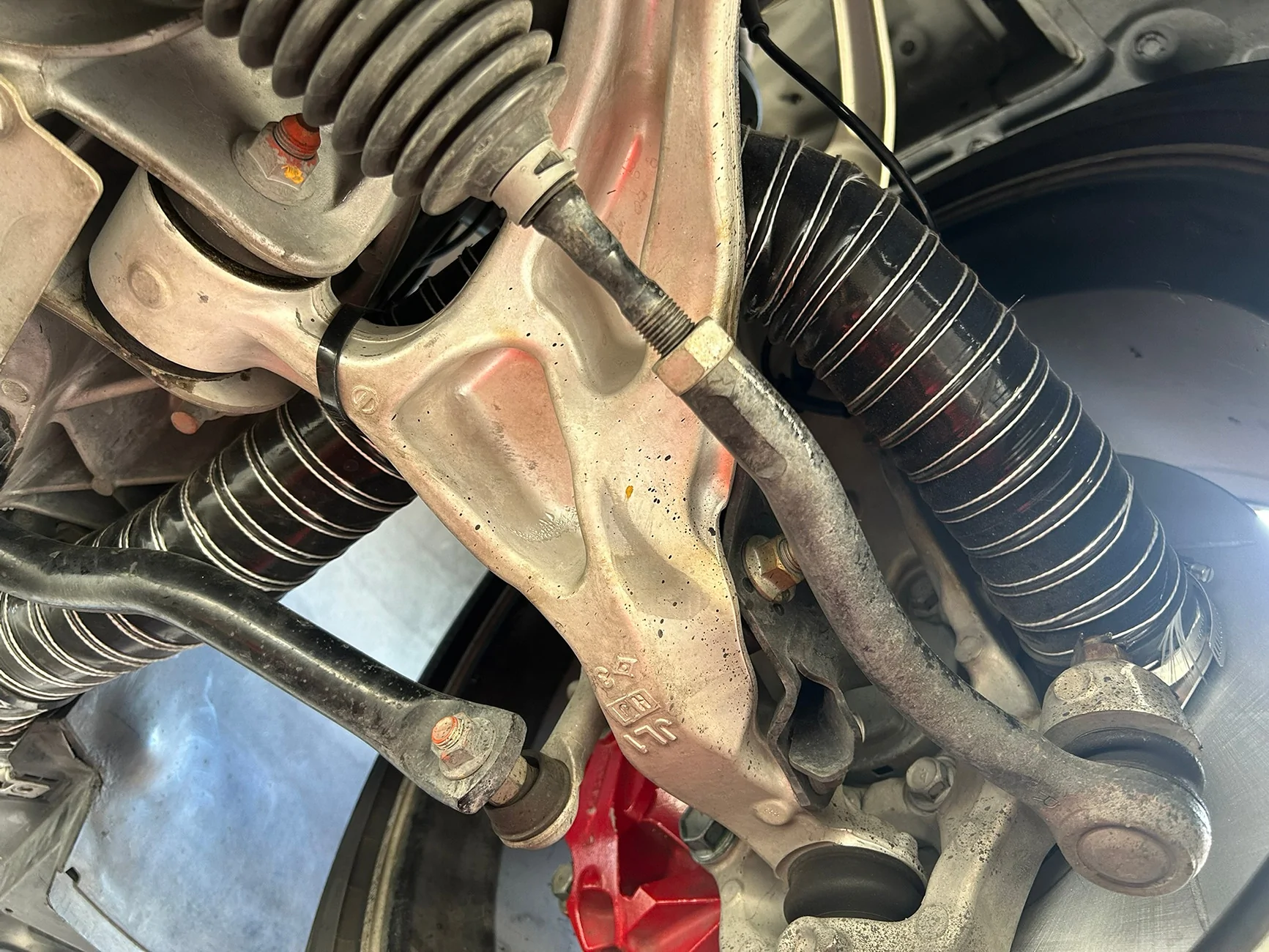

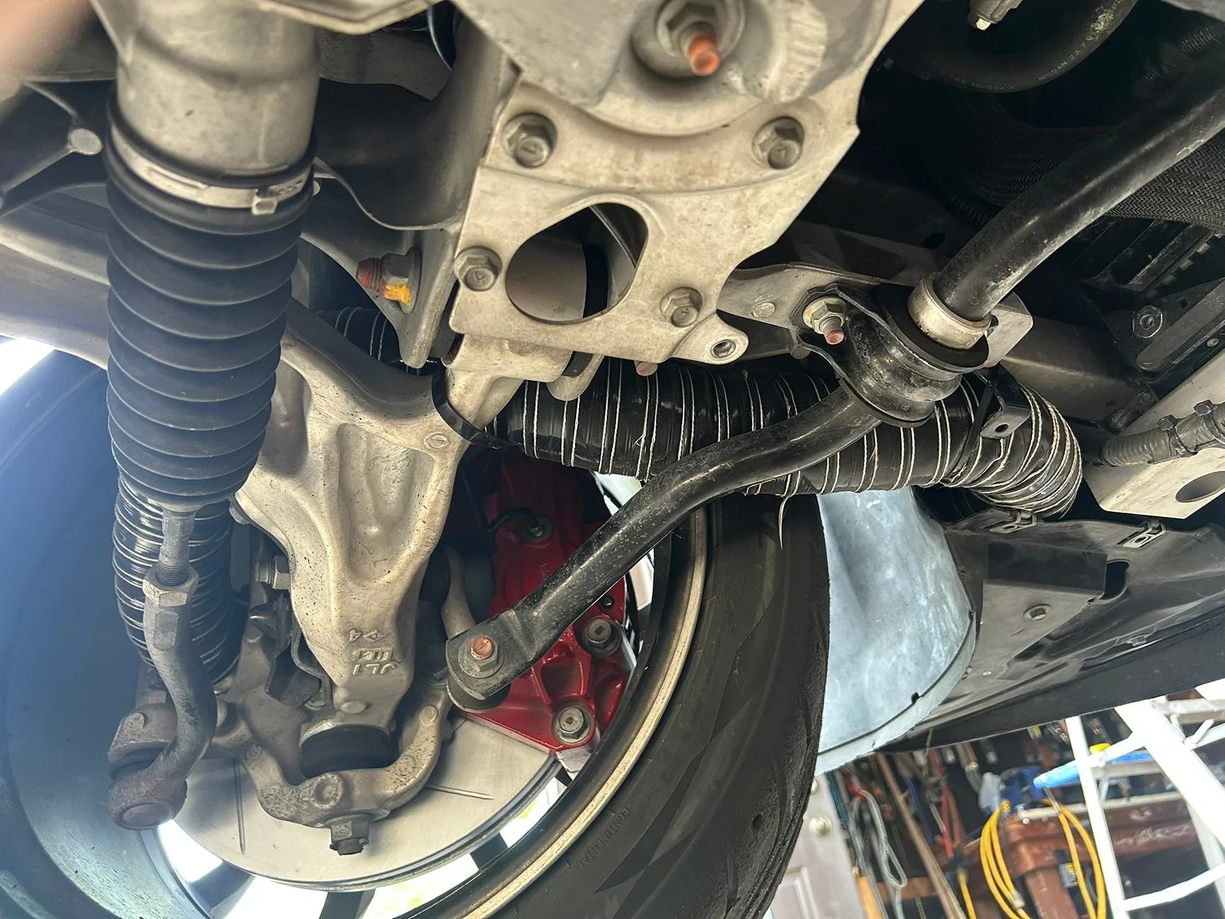

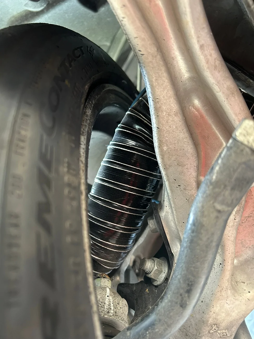

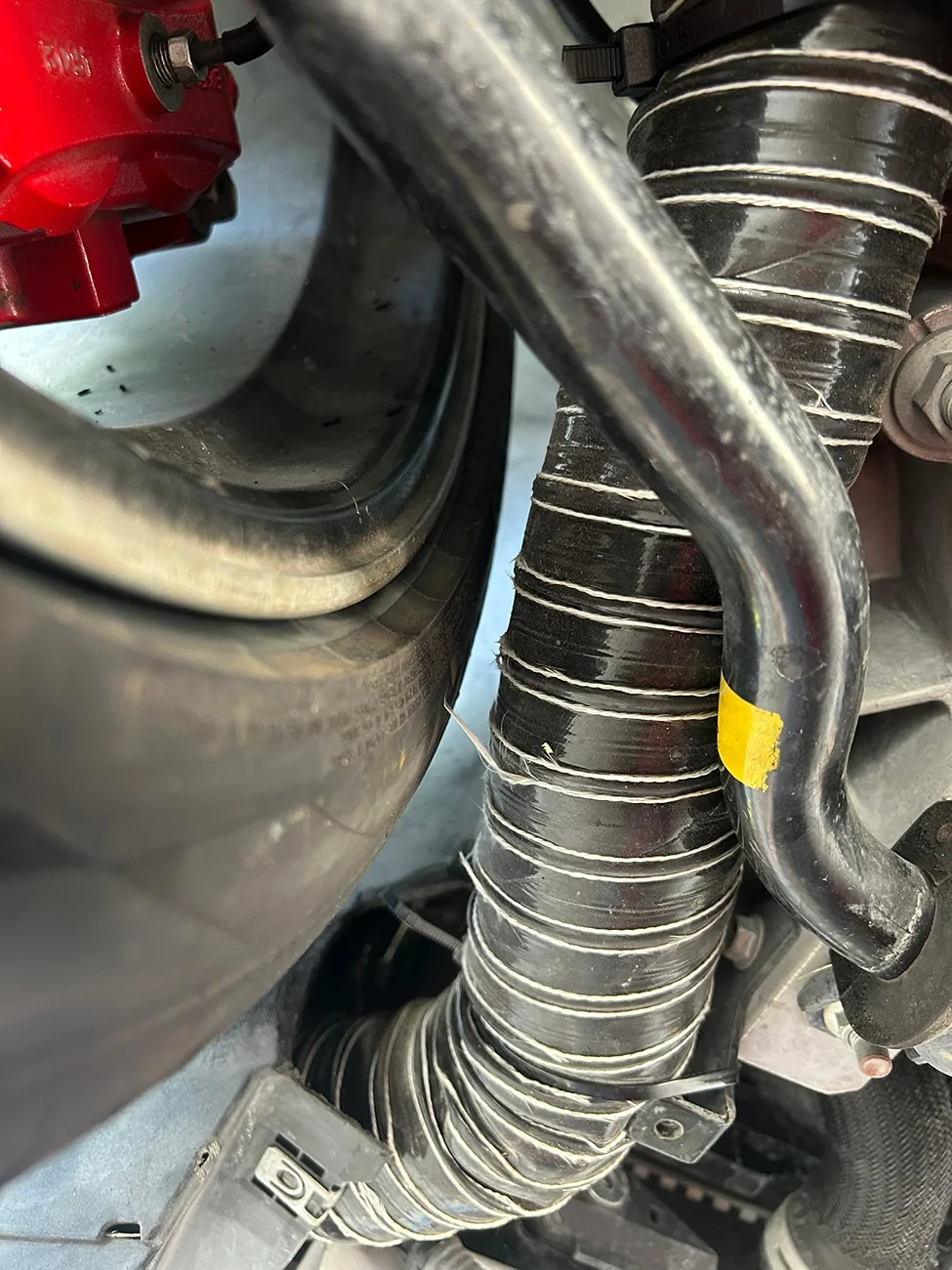

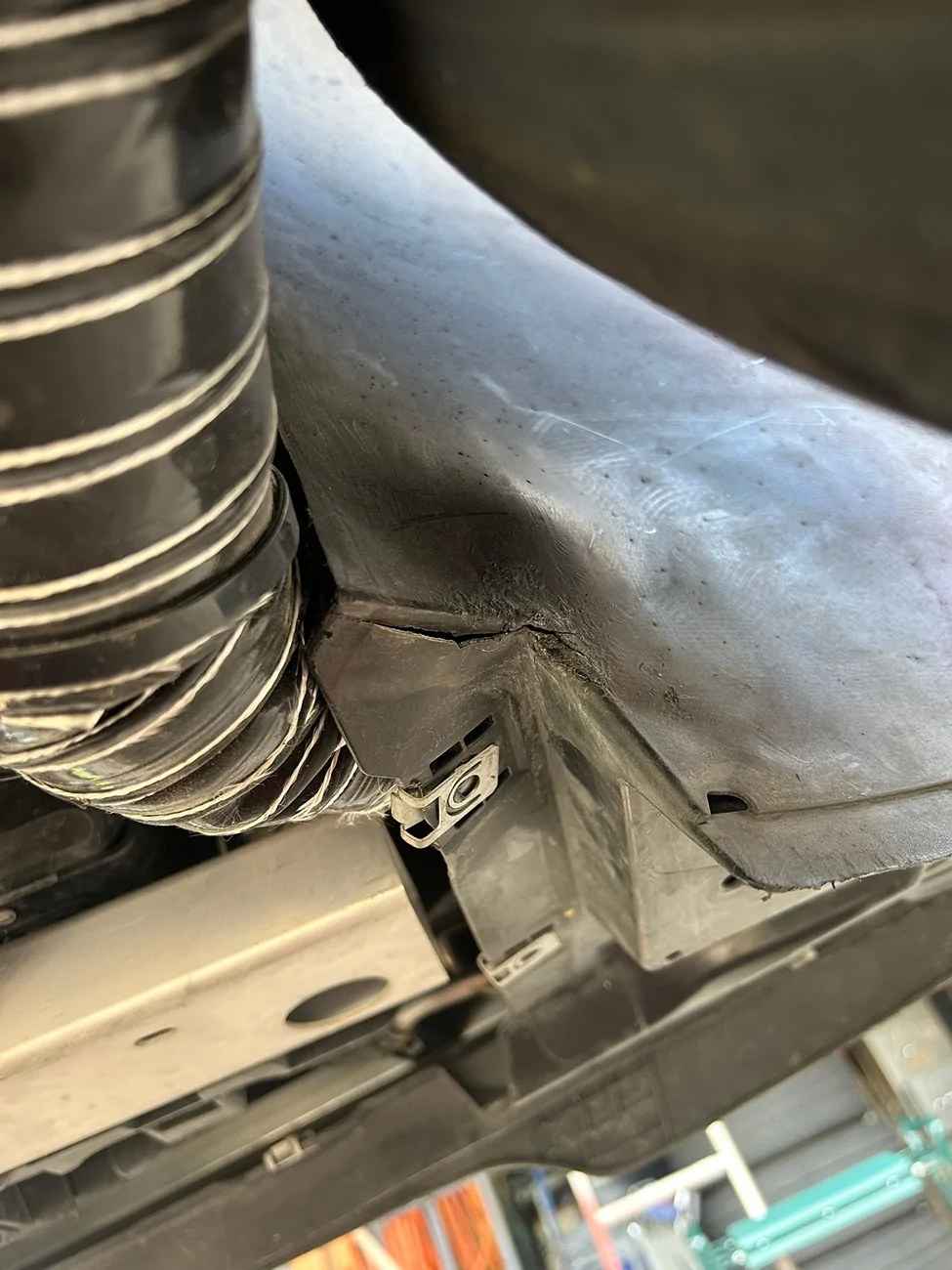

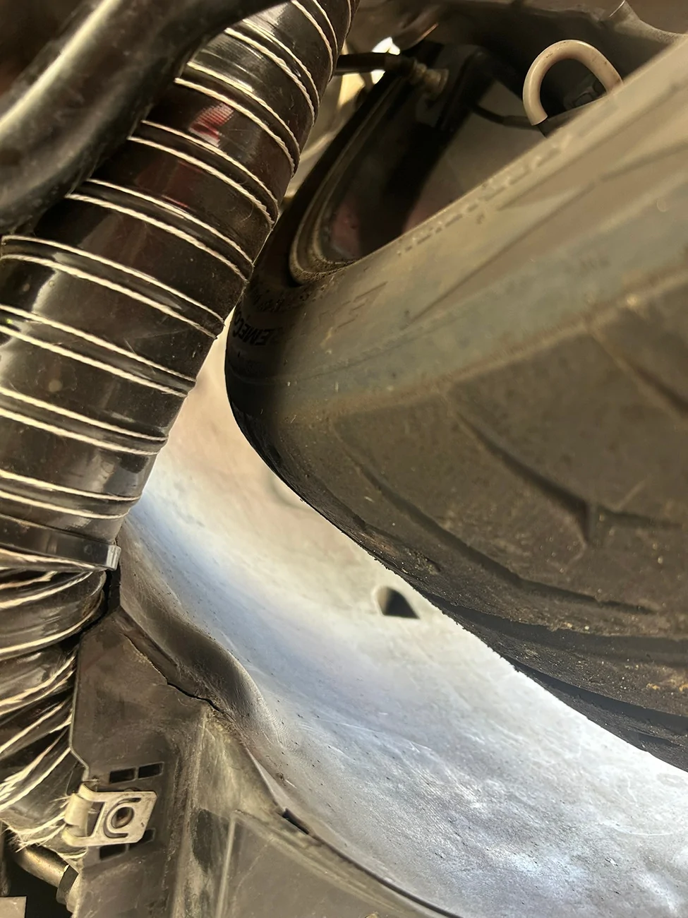

I have Paragon 2-piece rotors and was using Carbotech XP10s with it. Only had an issue with the fronts, and it was the hottest day I've ever ran the Z on the track (90°F ambient temp).
I do not have brake ducts like the OP however.
