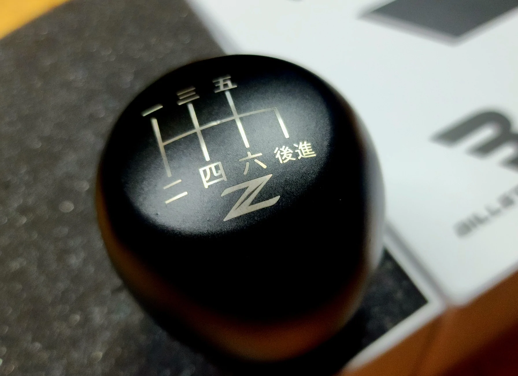

Yeah, I've heard all the horror stories as well about removal from fellow Z owners who have attempted it. In fact, I had already made an appointment for my dealer to remove it because I had resigned myself to not tackling removal myself due to all those reports for fear of damage. Anyway, I got curious (and lucky it seems) before my appointment to give it a try using a rubber strap wrench with a microfiber towel in-between it and knob as a buffer. Surprisingly the factory knob came off for me with just a moderate amount of force, and with zero damage (as shown in OP pics).

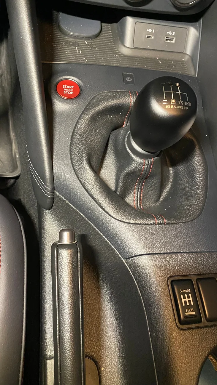

No need to, thankfully. I did order Billetworkz aluminum boot retainer along with the CHONK, but because of the way the CHONK is design with large opening in bottom it allowed the OEM boot trim to mate perfectly with it inserting inside after just a slight modification to its inner threads, so the Billetworkz retainer was not needed. I added a few more photos to OP to help show how all that goes together.

Simply drilled out the threads a bit on inside of original plastic trim piece with a large unibit so that it fit around the Billetworkz thread adapter. The second photo in OP shows that piece installed over the thread adapter and on top of boot after the internal threads were shaved, and the third photo shows the CHONK installed on top, exposing about 1/4-inch of the trim piece once everything is tightened down.

Curious about your photo above; It looks like your CHONK may be sitting up a little higher than mine based on how much of the plastic shaft trim piece is visible compare to mine. Is this true, or just an illusion?

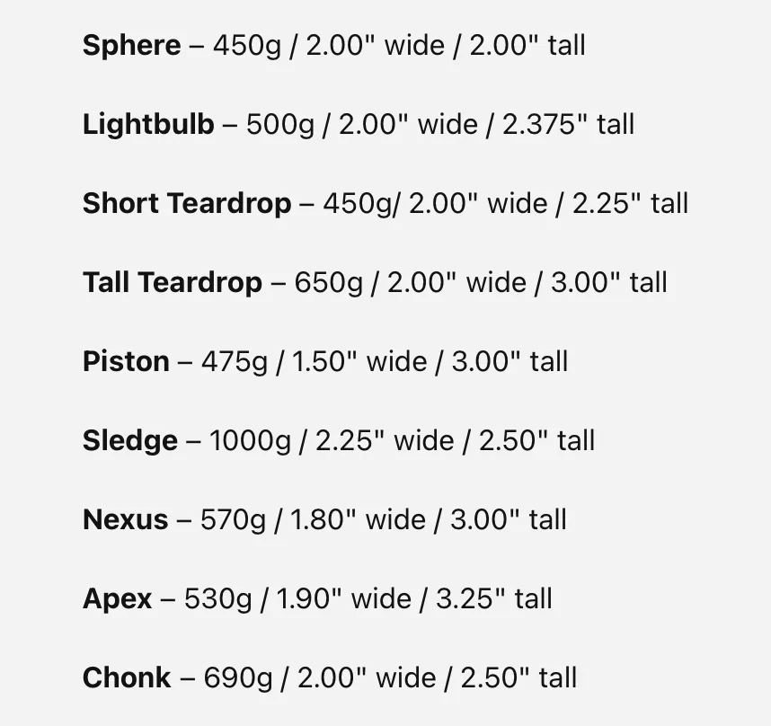

Yes. the adapter converts the knob's internal thread to whatever the shifter lever thread happens to be for whatever vehicle it's being mated to. Here's what it looks like. It
I wonder how the Short Teardrop would work.
Should work fine if that's the aesthetic, dimensions, weight, and feel you're after. Here's the comparison chart for the various Billetworks shifter knobs to help you decide.

It is true. It is tight. But I couldn't figure out what you did. So I screwed it until it got tight enough. :oops:
