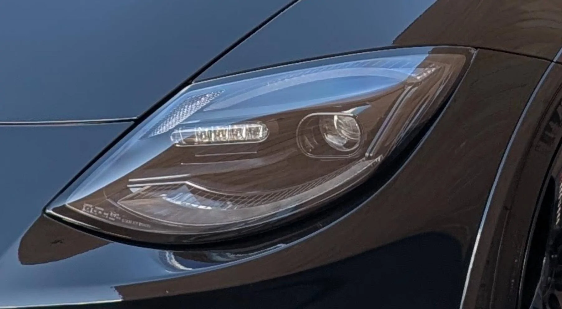

I ended up ordering the Japanese headlights. The high beams don't emit from the main projector. The high-beams only emit from the 4-bulb side pod, which seems to be different that the US spec.

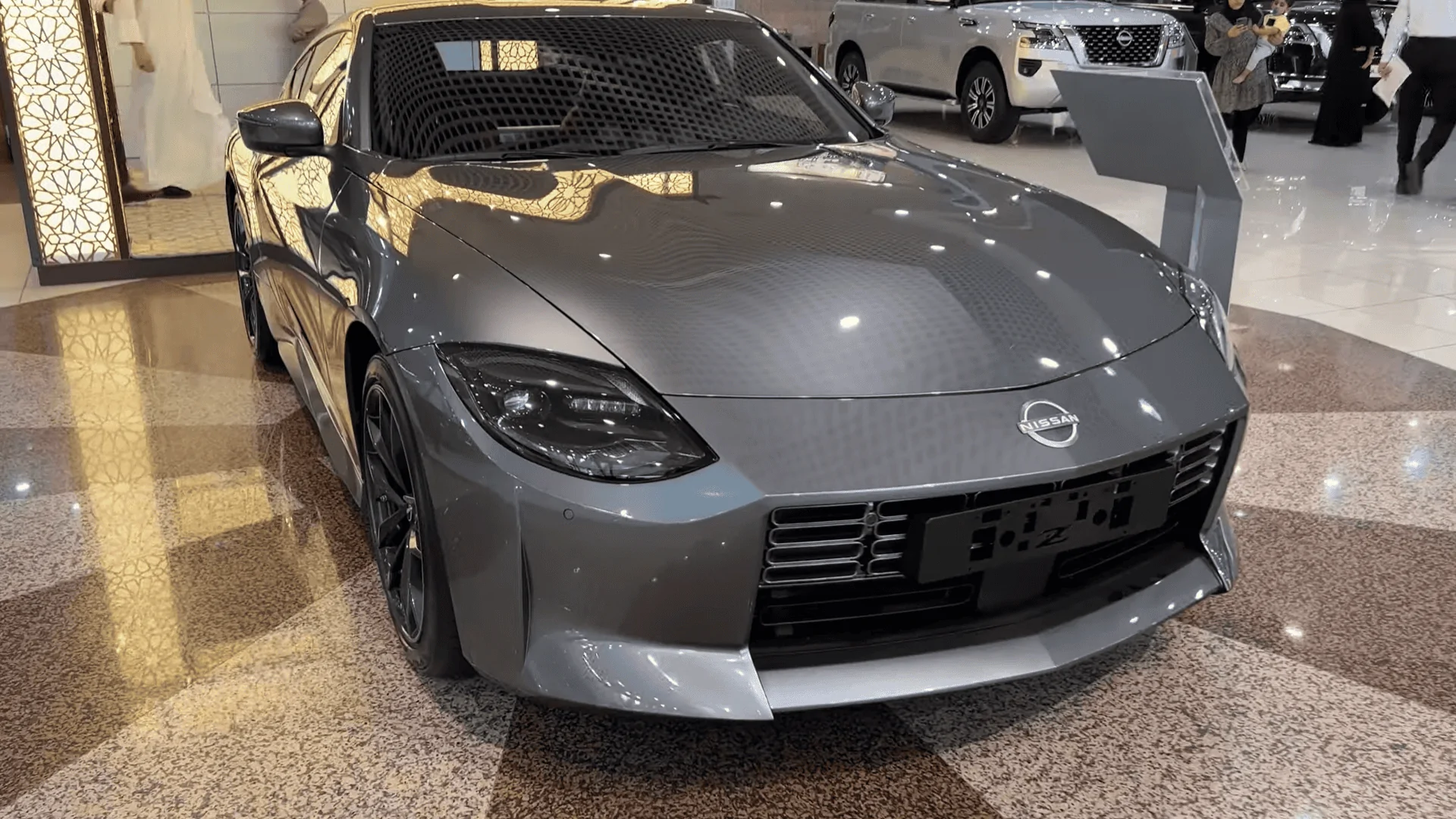

Midz10
May 30, 2025
86
86
Saudi Arabia
I got the price. It's $1,554 per side without VAT.
They gave me a weird part number.
1- M N260106GR0C. RH
2- M N260606GR0C. LH
It might a little bit cheaper in Qatar or Kuwait.

If you have one of the newer Z, can you check if the main projector changes when the highbeams are enabled?
On my JDM headlights, I can see the cutoff is still in place on the main projector. The highbeams appear to be emitted only from the sidepods.
EDIT: I asked because I still the blue light cutoff with my highbeams. However, this video shows the same blue light cutoff effect on USDM lights, so maybe they are the same.
