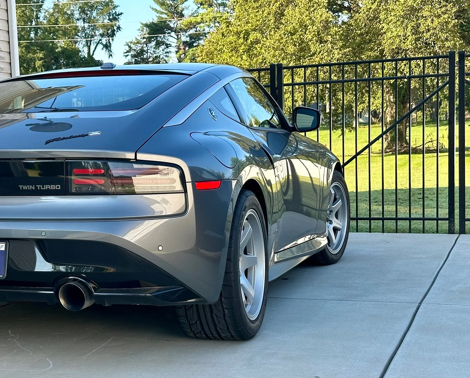

This is a 295/40/18 on a 10.5 +22, stock suspension. Fronts are 275/40/18 on 9.5 +35. You'll have a couple millimeters less clearance on the inside rear, but I don't think that will make or break you. You can get away with a lot of tire at stock height.
