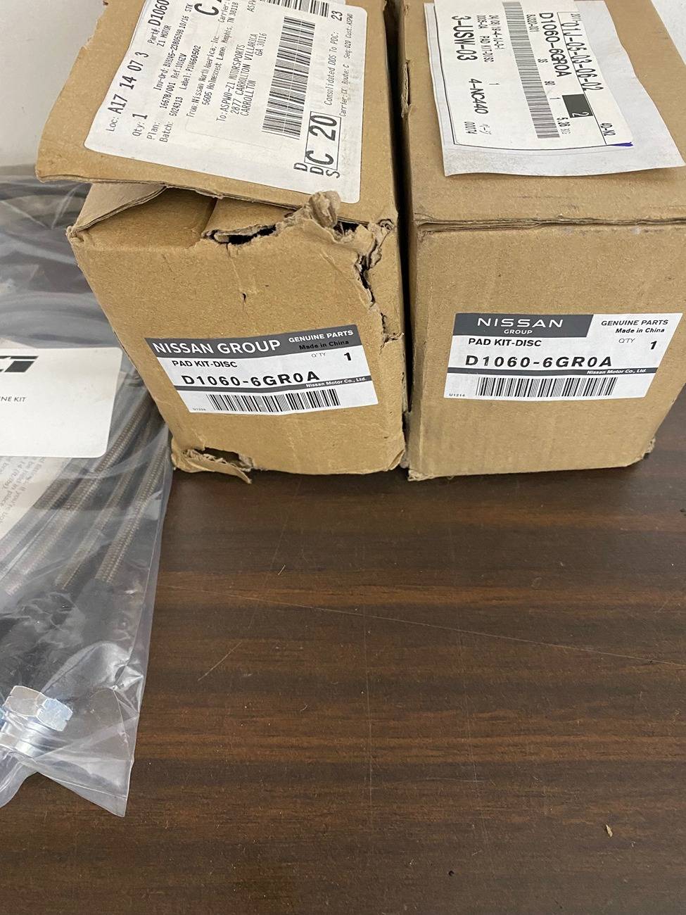

I have a Nismo with 6K street miles and my front pads are already %50 worn. I could see myself blowing through a set of pads in 1 track day. Luckily they are cheap. I haven't found any performance pads or rotors for the Nismo yet, so not tracking this car just yet.
Check Z1 Performance in Georgia
D2M
Jun 14, 2024
279
423
NJ
Nismo Z, Veloster N, Ram 2500
I bought the last 2 sets or OE pads Z1 had in stock. Also got a set of lines as well. Im ready for next season, Im only planning to do 1 track day in this car next year.
