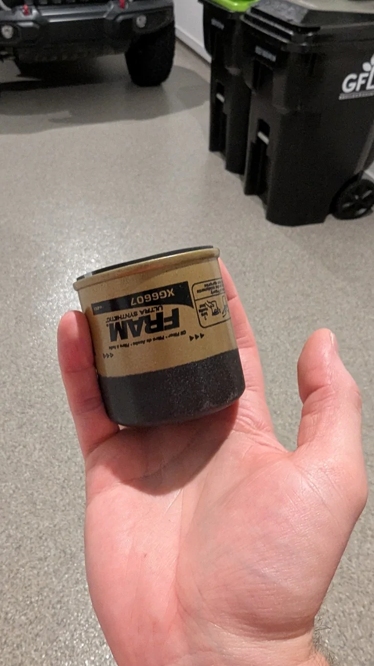

I wish there was a top shelf aftermarket oil filter available for the VR30 that utilized the correct bypass pressure... 99% @ 20 micron, preferably. I originally bought a Fram XG to use until I discovered it was the incorrect bypass psi.

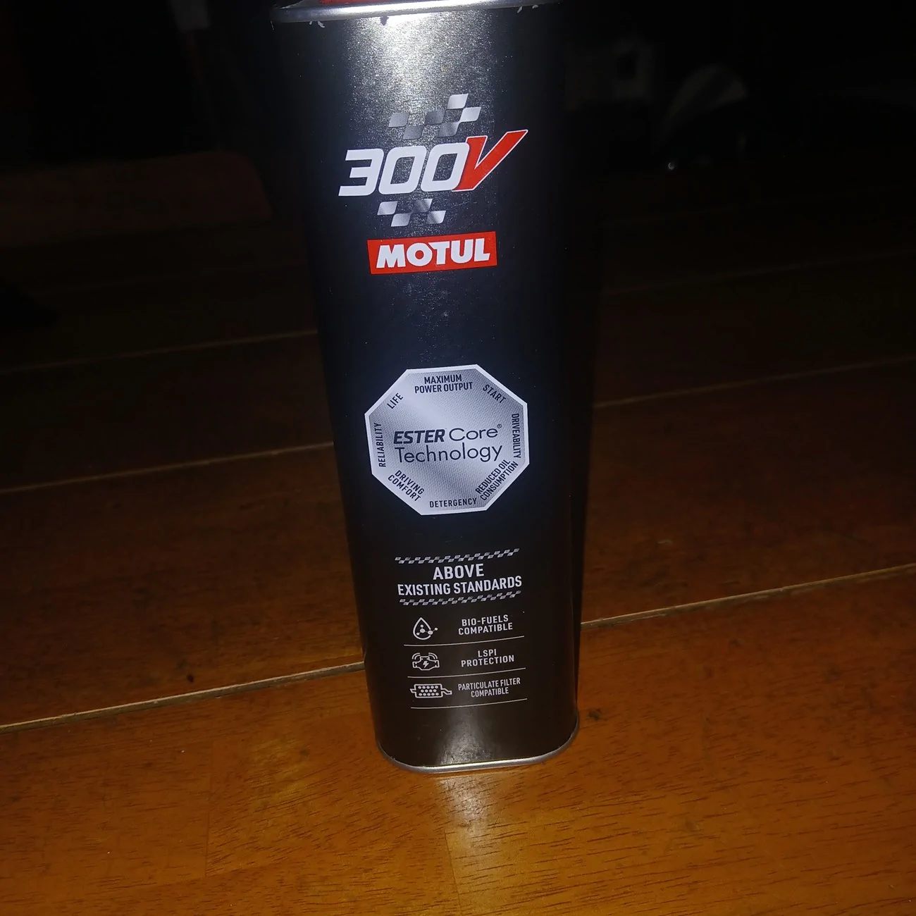

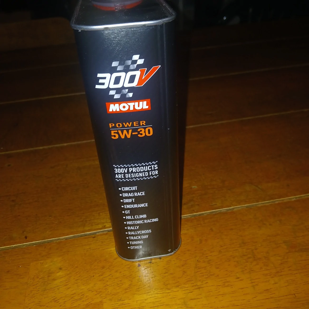

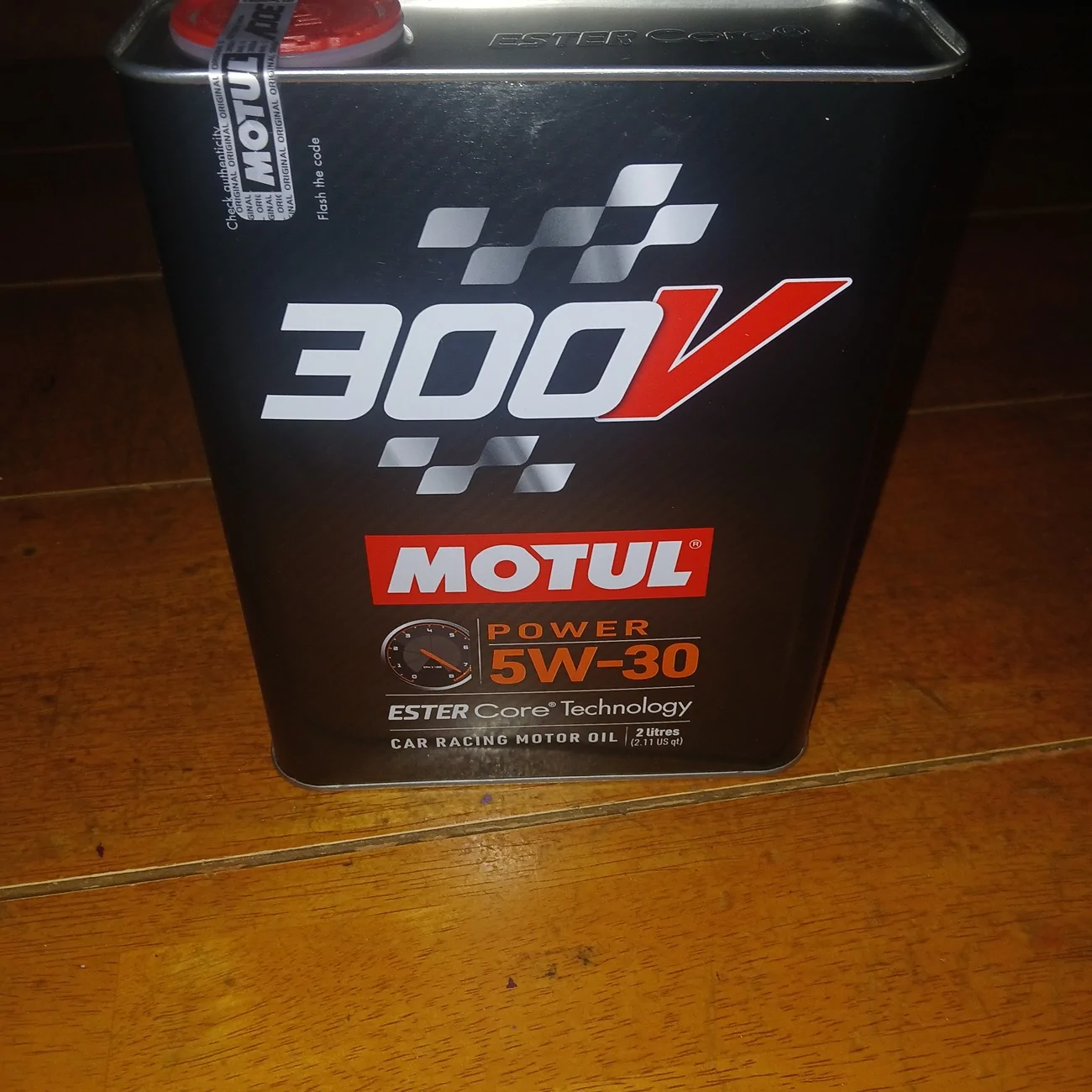

What i use. Im at 9009 miles and just did my 4 th oil change. No sludge can result when using this synthetic cuz this is PAOs and ESTERS tech
