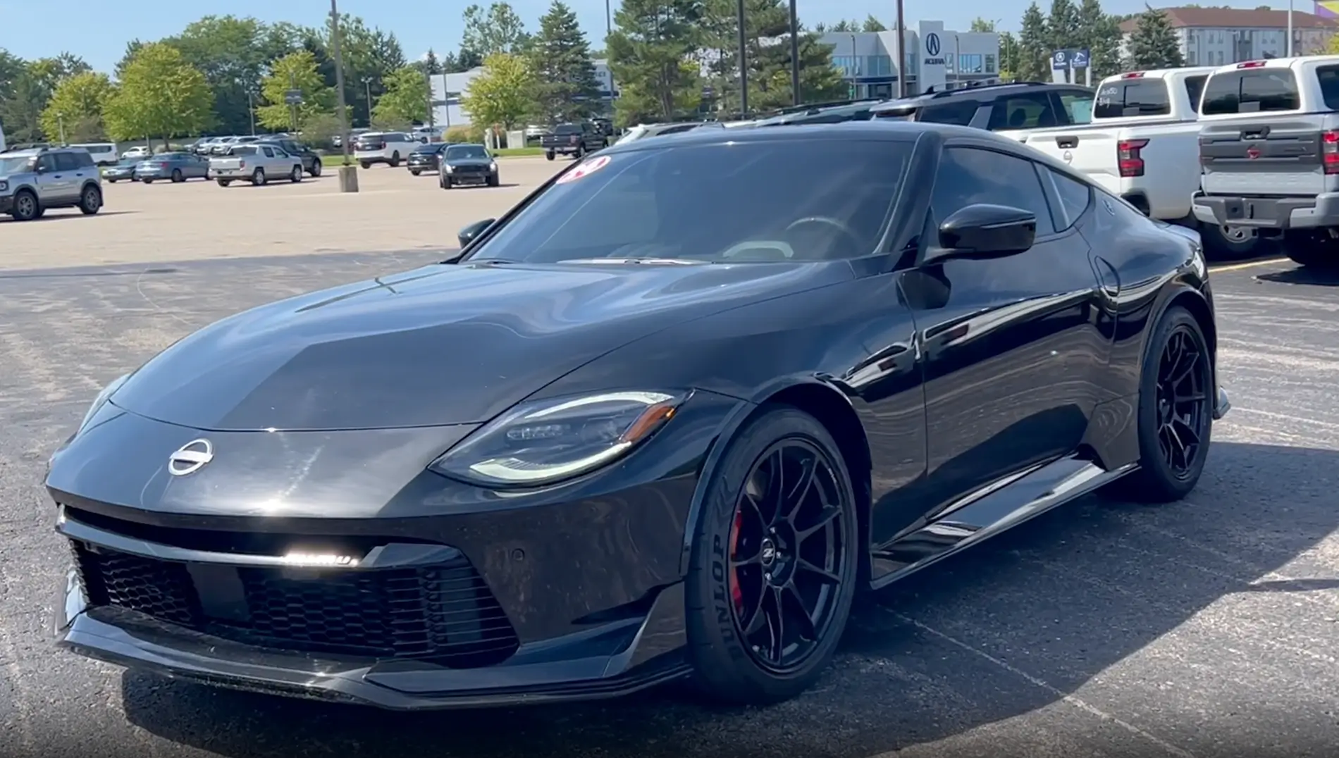

Taking delivery of a used '24 black diamond nismo z and I'm looking forward to sharing the build.
The mods on the car already include a SOHO custom 3" exhaust, Boosted 6 full downpipes with high flow cats, GoRaceBox off the shelf tune, and AMS 80mm intakes.
I have ordered the following parts, and will be looking to focus the build on being daily drivable, 93 octane fueled, properly stanced, and set up to go fast around corners rather than just in a straight line.

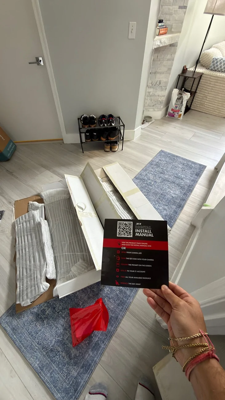

Mods starting to come in! This is the aluminum undertray specific for the Nismo from Z1.

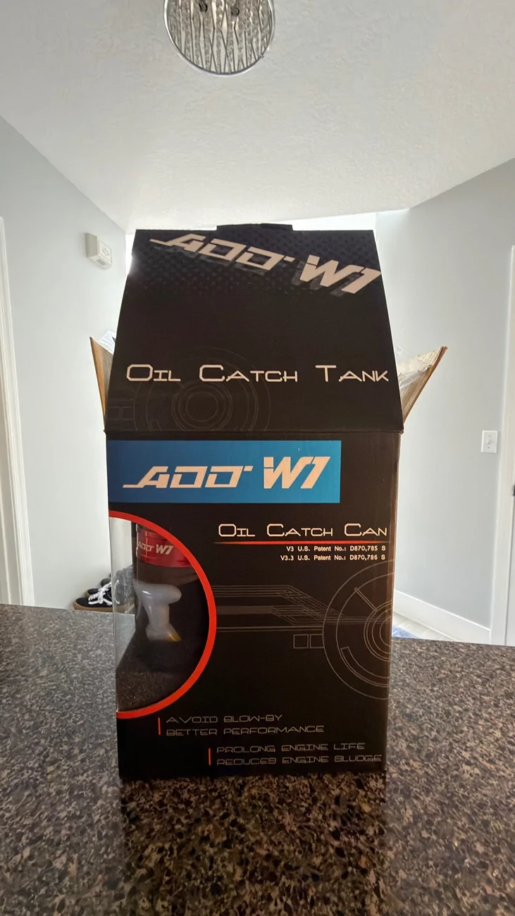

ADD W1 v3.3 oil catch can kit is here
