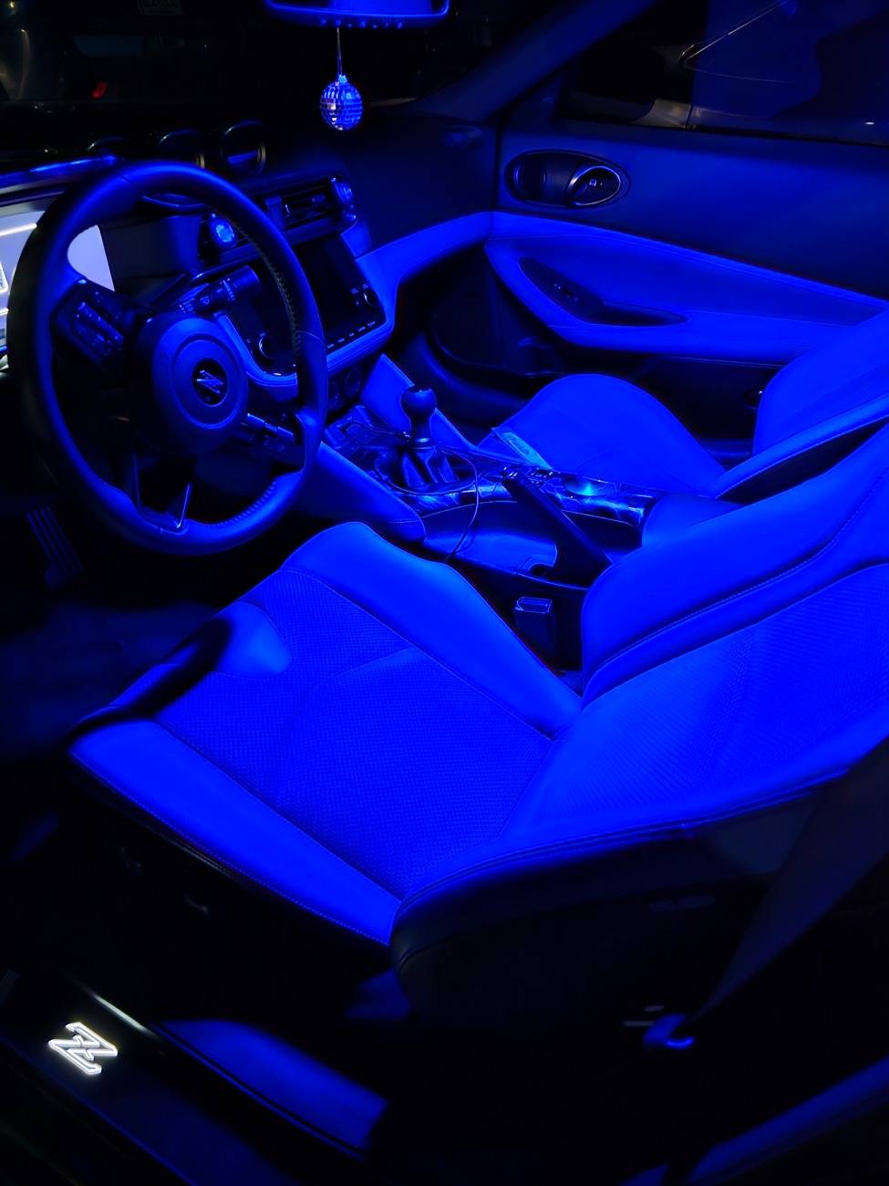

🔴 LED interior lighting swap. No more blinding white reflective light in cockpit at night.

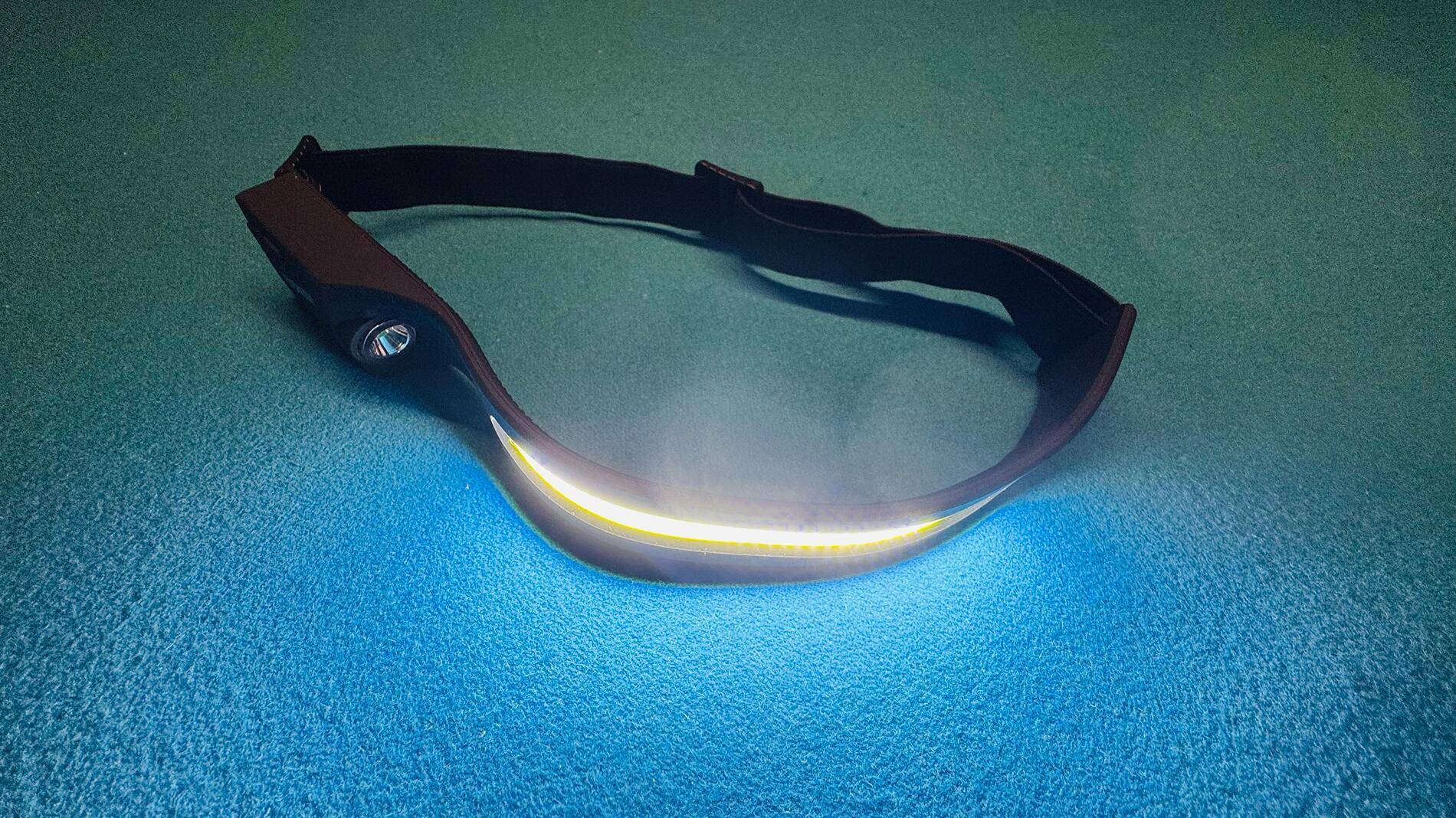

Funny you should mention that because I just bought a few of these silicon headlamps off Amazon last week. Super bright, compact, lightweight, USB-C rechargeable, and inexpensive too.
PS: Here's link for anyone interested. Currently just $36 for a 5-pack.
https://www.amazon.com/dp/B0DG27JCCG

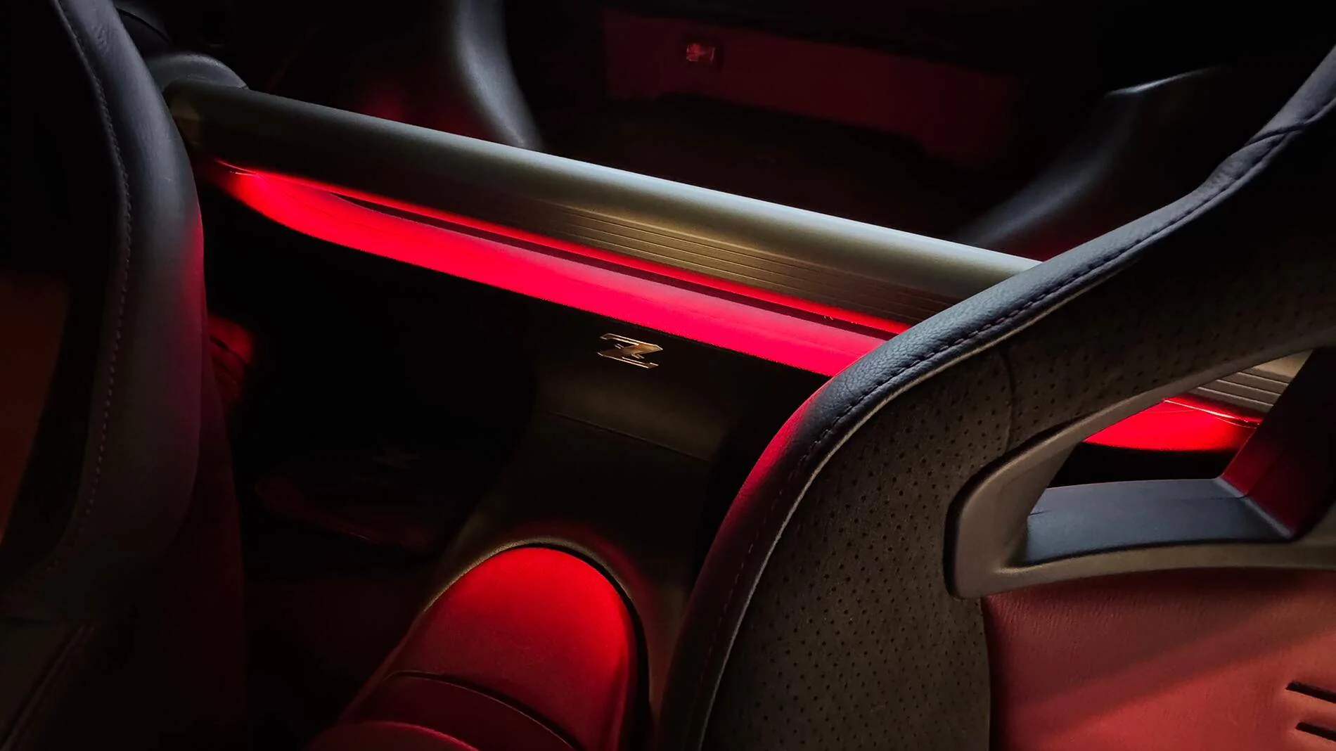

UPDATE: Homogenous red LED strip has also been mounted hidden underneath the rear strut support brace that provides just the right amount of indirect ambient interior lighting at night without being distracting (it has a hidden dimmer control as well to dial in the desired brightness level).

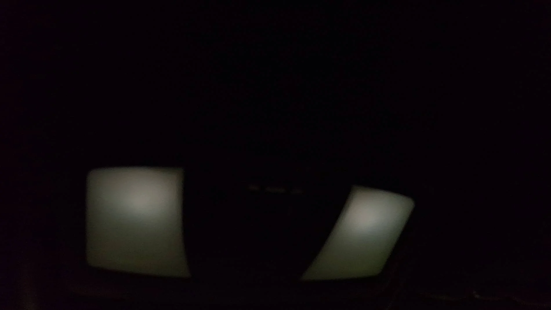

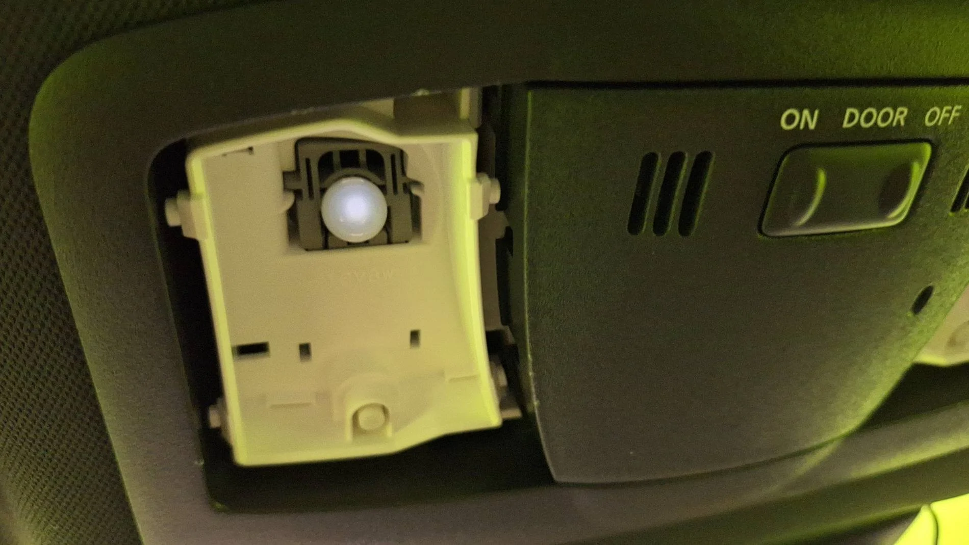

I just confirmed this issue after installing the White Sylvania bulbs. If you have the ON-DOOR-OFF selector in the DOOR position and let the lights all turn off, they will stay super dim and eventually flicker a bit. I noticed the two green LEDs on the S.O.S. button also flickering. They stay dim while driving as well.
I replaced just one of the Sylvania LEDs with the regular 194 halogen and they started working normally so it obviously needs a load on the circuit (looked weird with one yellow and one white bulb). I replaced the Sylvania with a cheap LUYED 194 CanBus bulb and it's working correctly again. Unfortunately the Sylvania one doesn't have a proper setup for CanBus circuits.
I used the sylvania bulb in the hatch and didn't notice any issues yet. I will advise if I notice anything.
These bulbs have mixed reviews but I used them for over 8 years in another car and had no issues. I'm gonna put two of these in and see if I have any issues.
The LED I put in the hatch area is also staying on while driving. Swapped it for the Halogen bulb. Waiting on some new CANbus LEDs.
Really cool! Gives it a modern look ! Any details on install?
