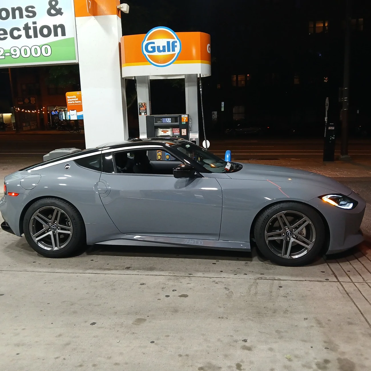

I went with 25mm rear and front and I've sped up to 110mph with no vibrations. I decided to go with Titan Wheel Accessories made here in the USA at a better price . Had them in for two and half months. Im lowered on Michelin A/S Pilot 4 265/45/18 oem wheels til I purchase upgraded aftermarket wheels.

That's correct. We have the same trim(Sport). No lugs nuts to purchase. The hubcentric spacers come with steel lug nuts to bolt into hub wheel. Then u place wheel flush to hubcentric spaces after they are torque to 85ft/lb to hub of wheel. I was flying today on turnpike where I reside 115mph no vibrations. As long you follow torque specs and re tighten after 100 miles of first drive

25mm front and back. Now this was my last fitment. Now im gonna upgrade to
fronts 265/35 19X9.5 +22 and Rear 305/30 19X11.0 +15 (5mm spacer to touch it off) will be my fitment with aftermarket wheels in two weeks. But yea the set up i had previously is 265/35 Front and Rear with 25 mm spacers.
