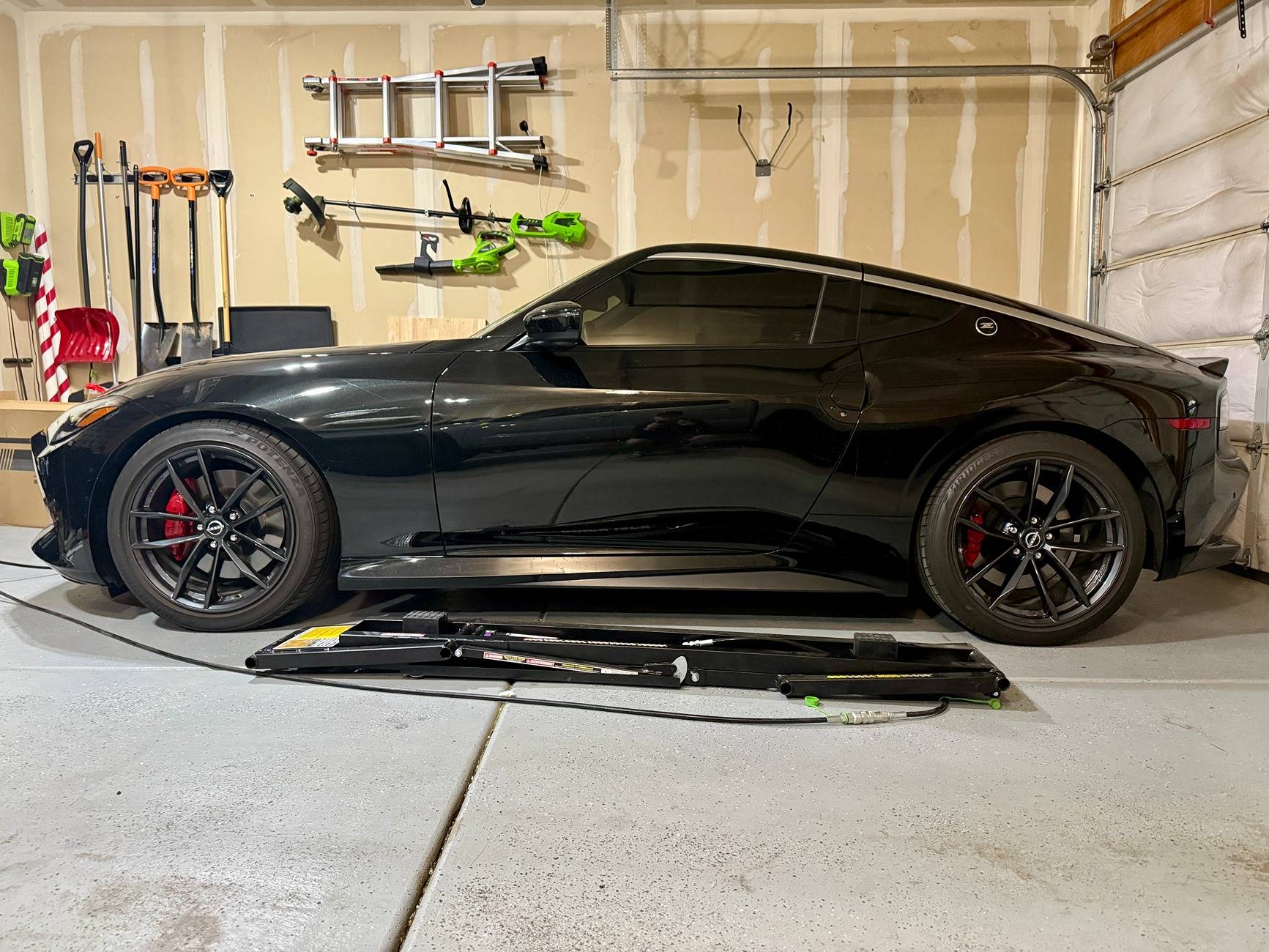

Had the same clunk in the rear after installing my S Pros. Adjusting the preload on the back fixed it no more noise at all. It’s a common issue with these. Before swapping parts, try dialing in the rear preload. Made a huge difference for me, been noise-free for over a month and 800 miles.

Step 16 forward in the Z1 instructions covers it, but yeah it’s a little confusing. You set the spring preload, use a second jack to lift the spring into position, then adjust the shock length. I had to extend my rear shocks a lot before everything lined up, but once I did, the clunking was gone. If the shock isn’t extended enough in the rear, you’ll definitely get that noise. Here’s the install PDF for reference:
https://cdn.z1motorsports.com/upload/Install_Z1_Z34_S-Pro_Coilovers.pdf
Also, here’s my Z with the ride height after adjusting preload. No more clunk and it sits right where I want it for daily and spirited driving.
