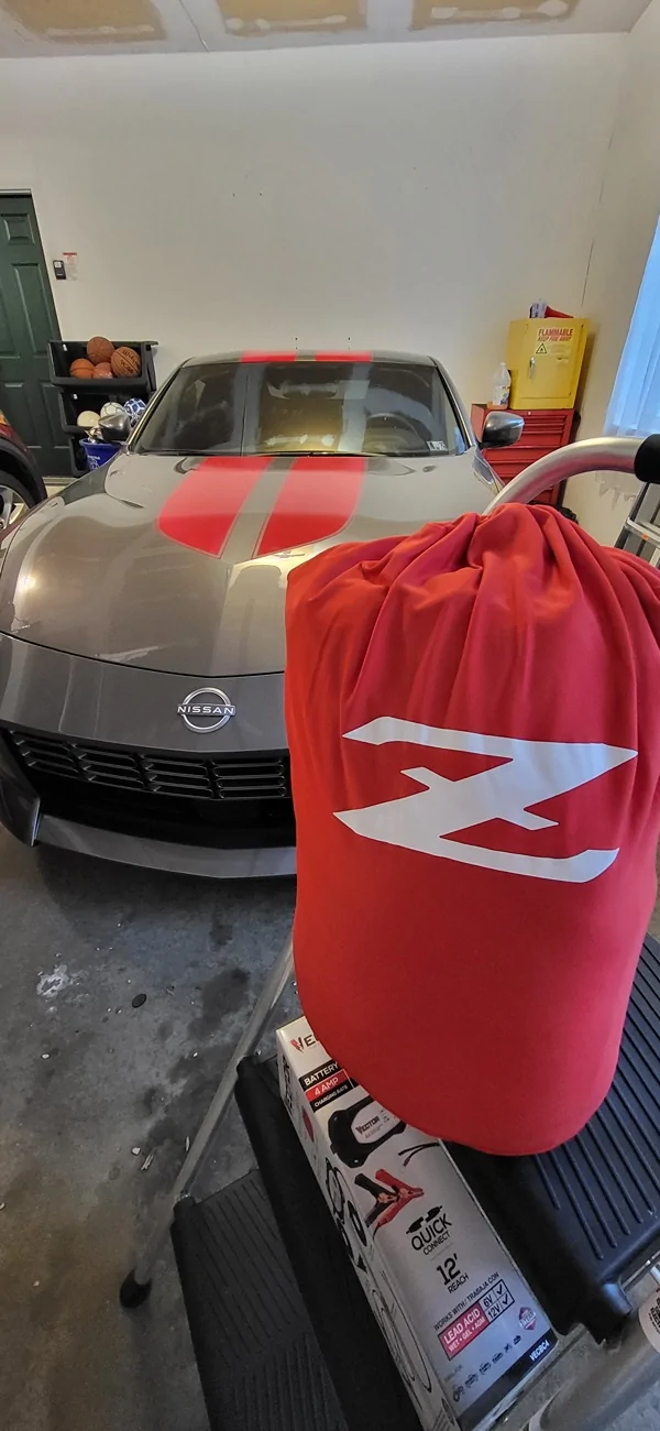

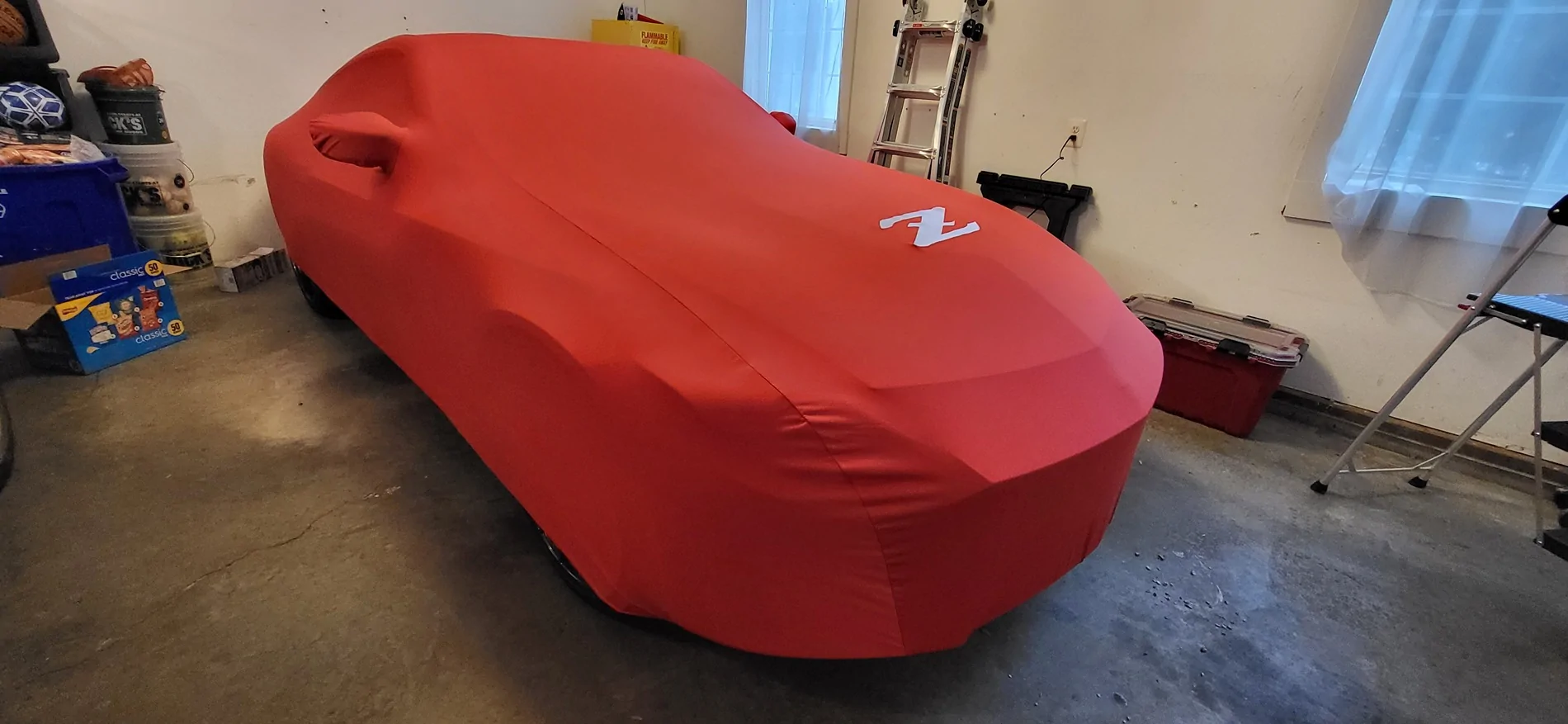

All good advice!

Correct. My cover in the picture is an indoor cover. It’s custom fit, with no strings or bungee cords required. It was elastic sewn into the bottom perimeter of the cover and fits like a glove.
Where can I order this cover?

Got my OEM + design cover today. Took about 2.5 weeks to arrive. Looks good quality, very soft, and fits perfectly. Great indoor cover.
OEM + Design, premium, embroidered
