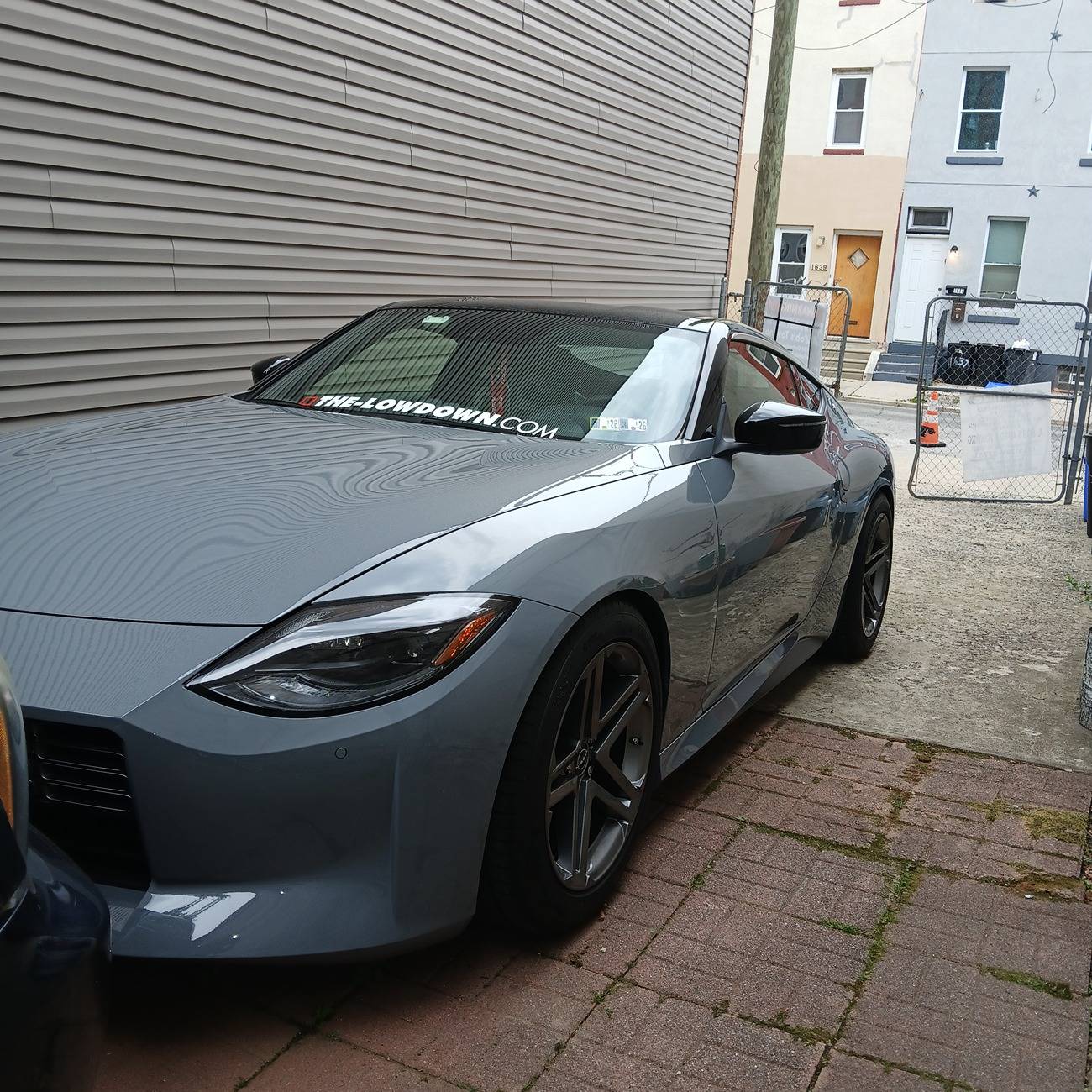

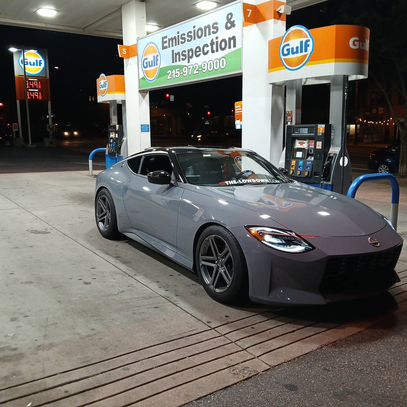

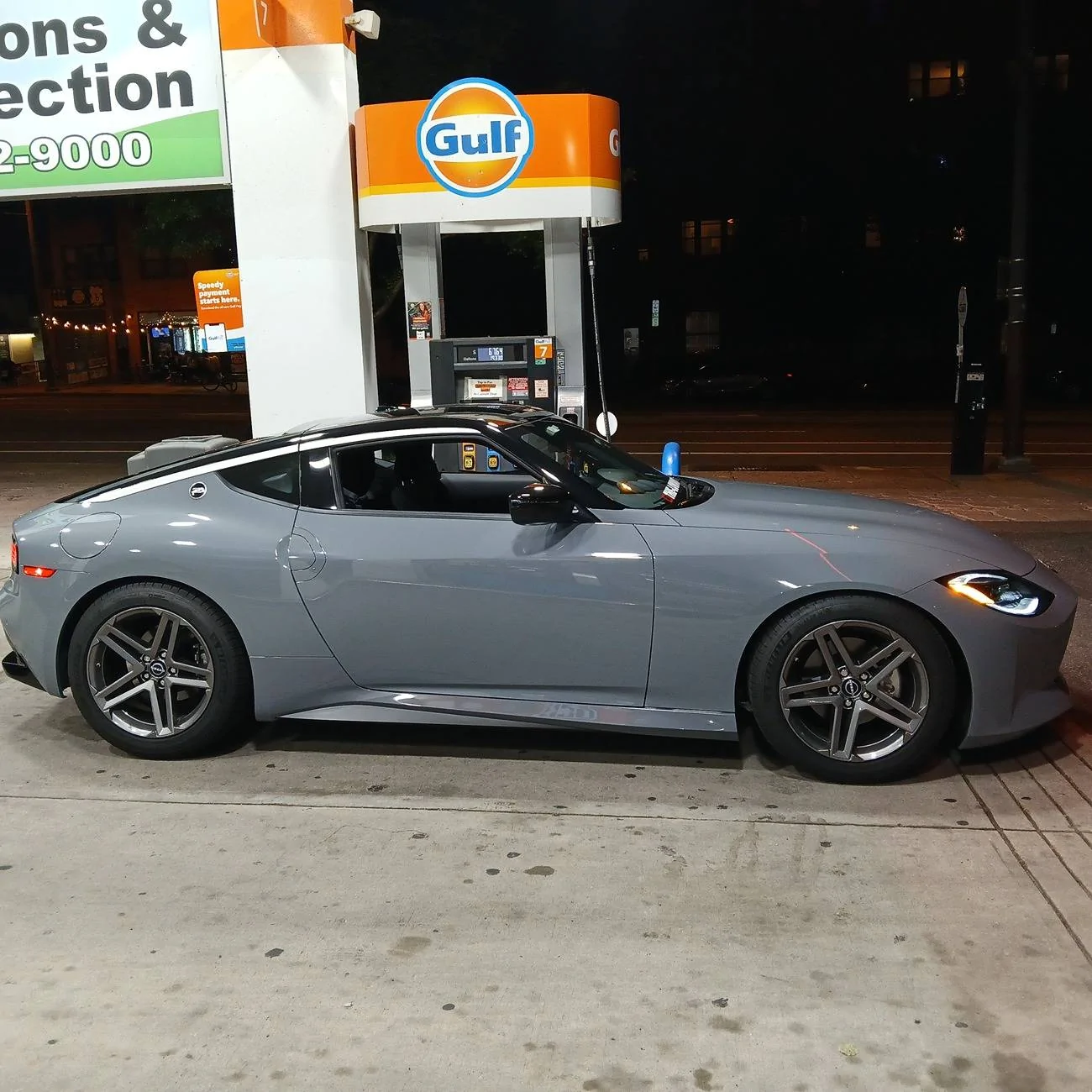

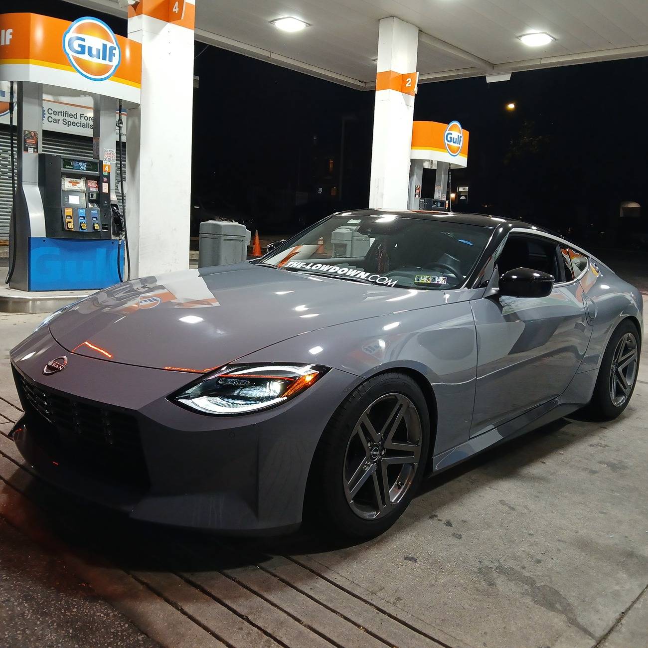

I have Titan Accessories Aluminum Hubcentric 25mm spacers with Swift spec R Springs .

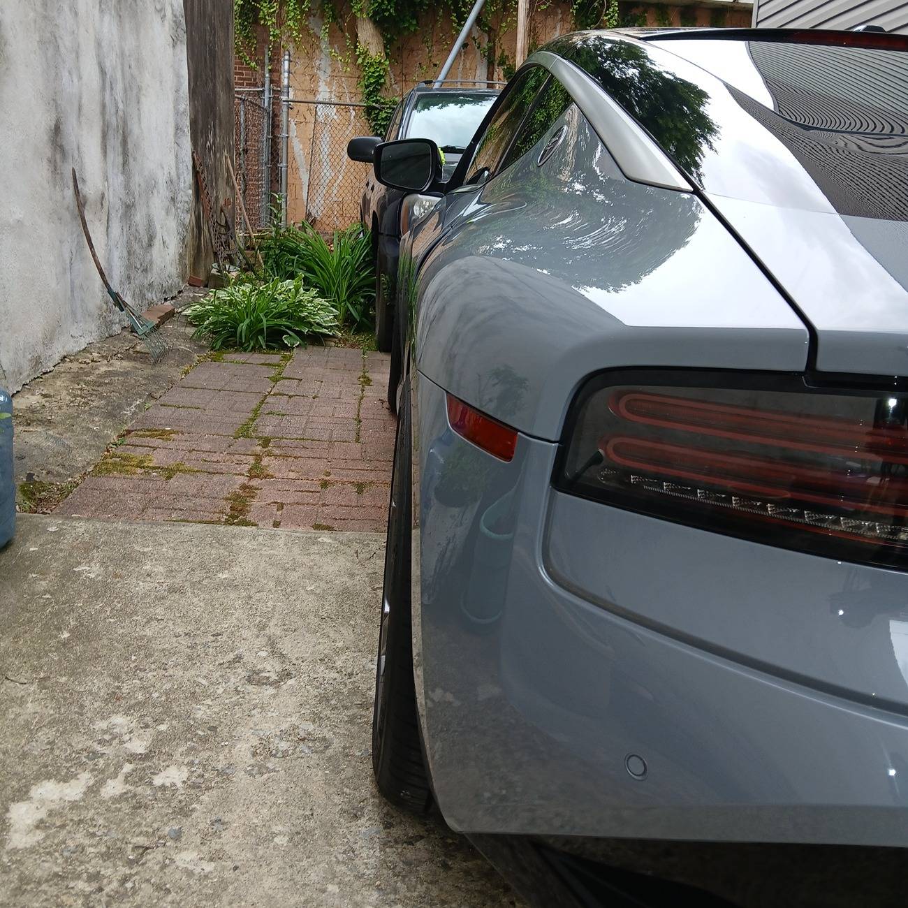

That looks incredible. Your rears look like they protrude out a bit. Ever have a tire bite the inside of that fender?

Thanks !! I like that actually! And no rubbing.
