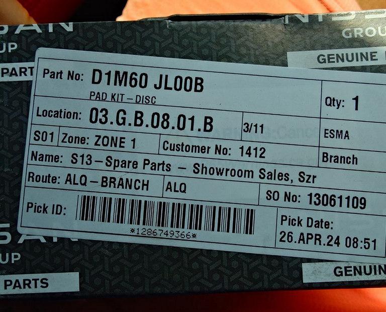

Ended up buying them from the dealer directly, cost me 106 USD for the pair of the front pads
