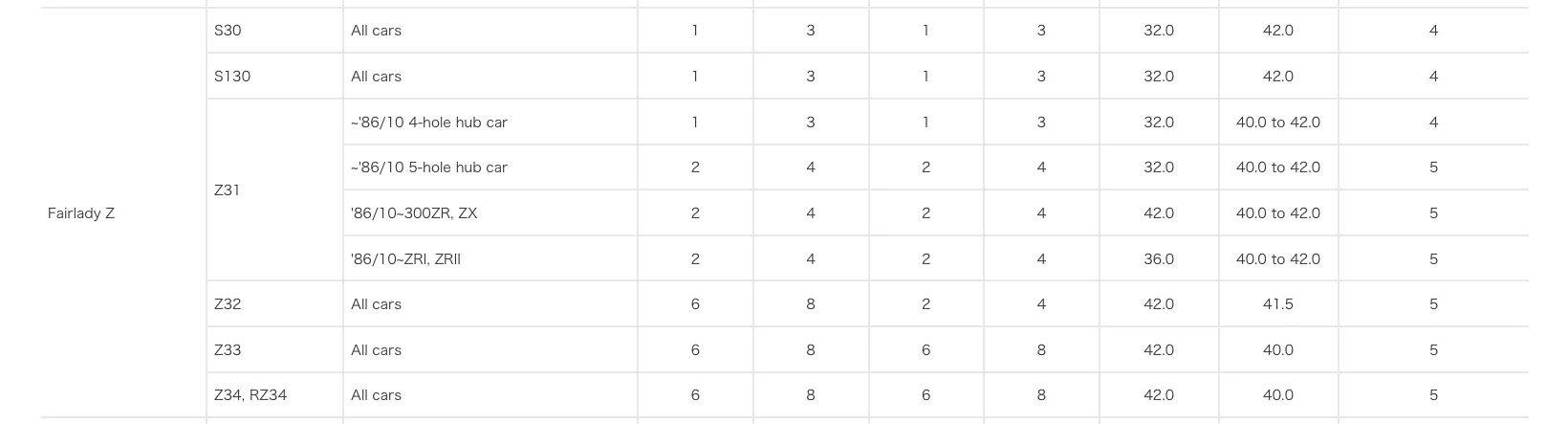

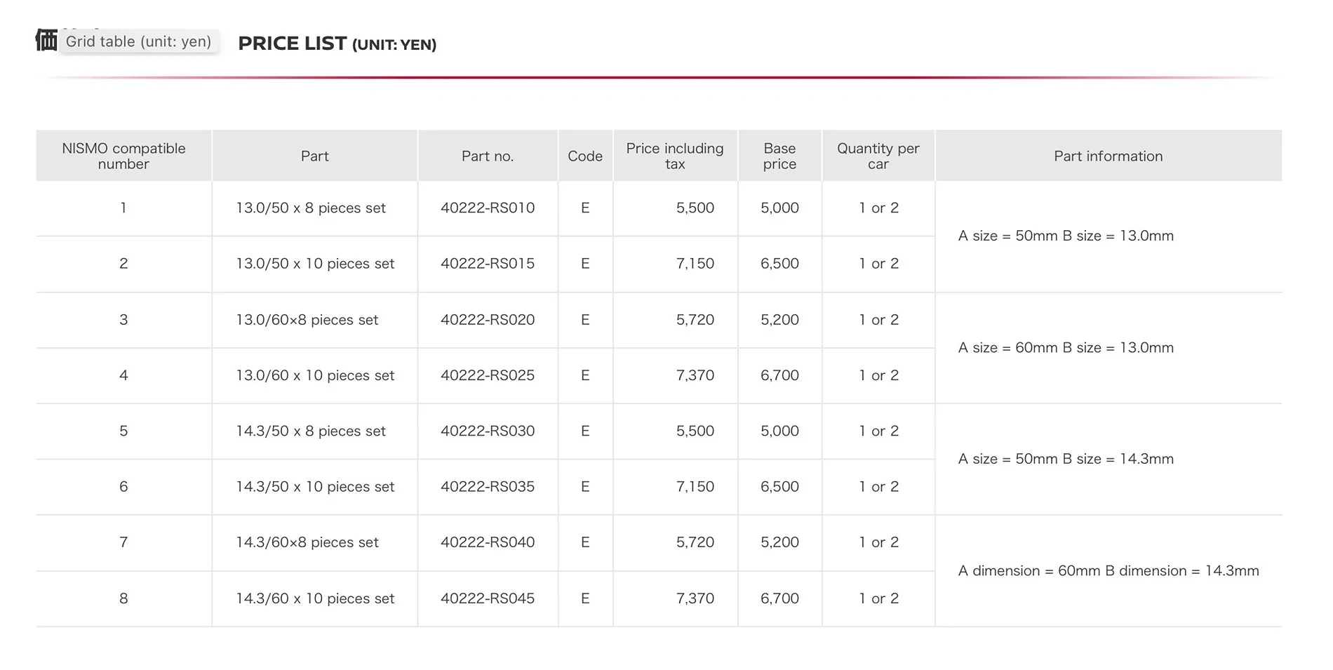

However, this is the NISMO extended wheel stud matrix from nismo.co.jp.
Z33, Z34 and RZ34 are all #6 and #8, depending if you want +10mm or +20mm, and ARE 14.3mm knurl.
Couldnt get the header on the model matrix, but the center four columns reference the top list ā€œ6, 8, 6, 8ā€ for front and rear and length.
