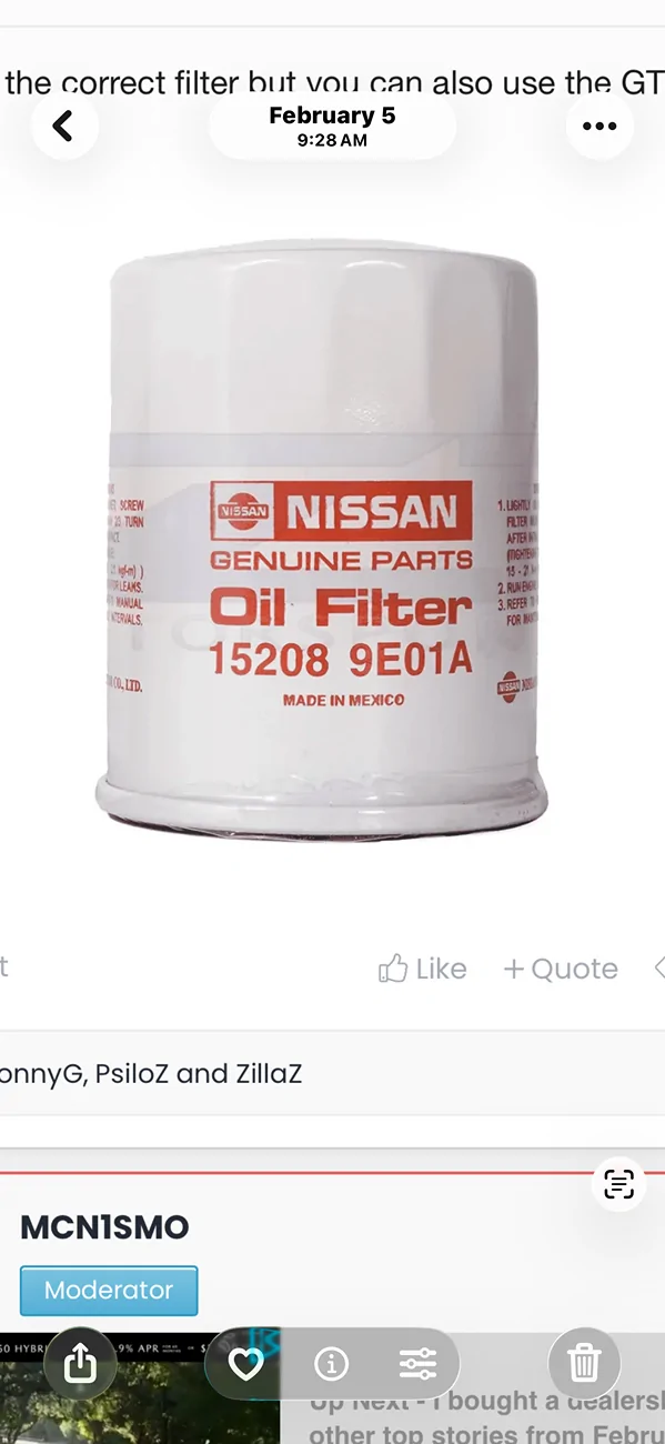

As weather warms up in ny I want to switch to using thicker oil. Is 5w-30 good enough or should I go for 5w-40. As of right now I’m using the oversized filter. Can I continue to use the same filter for thicker oil or is there a specific filter that accounts better flow of thicker oil.

Used the 9E01A on an Xterra w/ 5w-30 for a decade as it was the prescribed oil weight & p/n. Worked fine.
