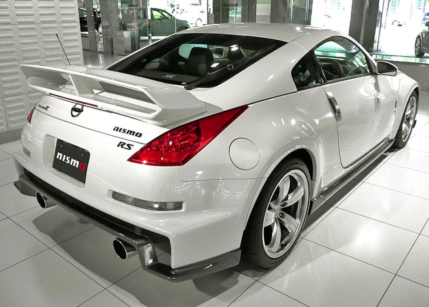

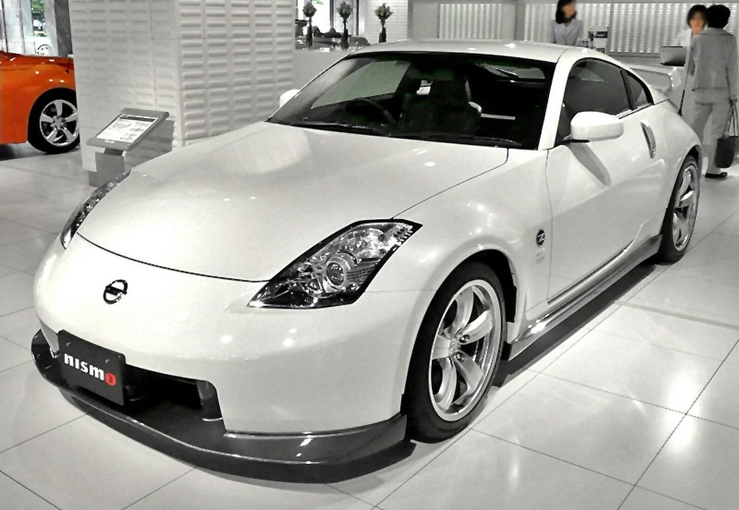

Flares have been a thing for a while now. I know everyone remembers the 380RS

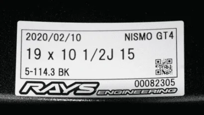

Any news when these will become available?
Also, will the gloss black 19's fit the Z?
19x9.5 +15 pcd 5-114.3
19x10.5 +15 pcd 5-114.3
They've been available for months haha. I turned down a set from Sensei6, you could call and see if they're still available.
Yes, that staggered set you posted will fit just fine. Im running almost that exact setup with my TE37s.

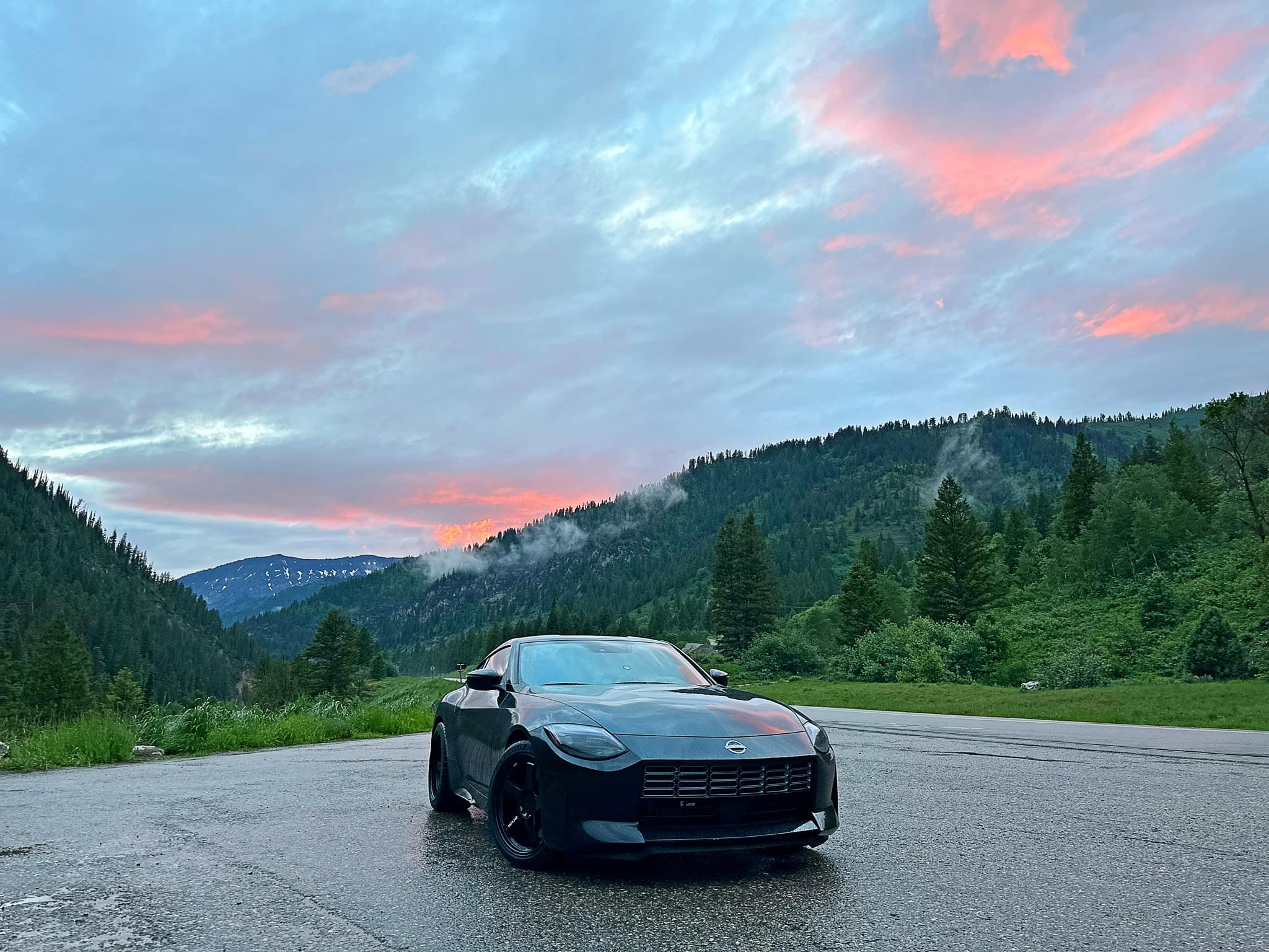

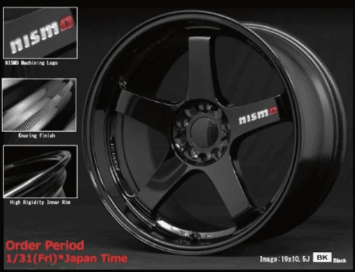

Here's the set I backed out of. Not sure if still available.

Curious about why did you back out?
I got a crazy good deal on my TE37s so it came down to cost, and second I simply wanted bronze wheels more than black.

Thanks! They're a little too wide in the rear, but they'd go great with the NISMO.
That's just the tire he chose. You can still sit flush with those specs we posted.

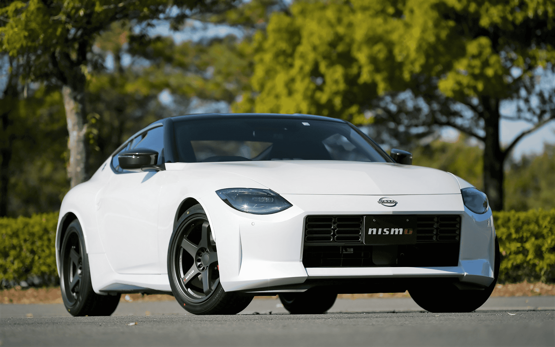

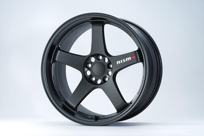

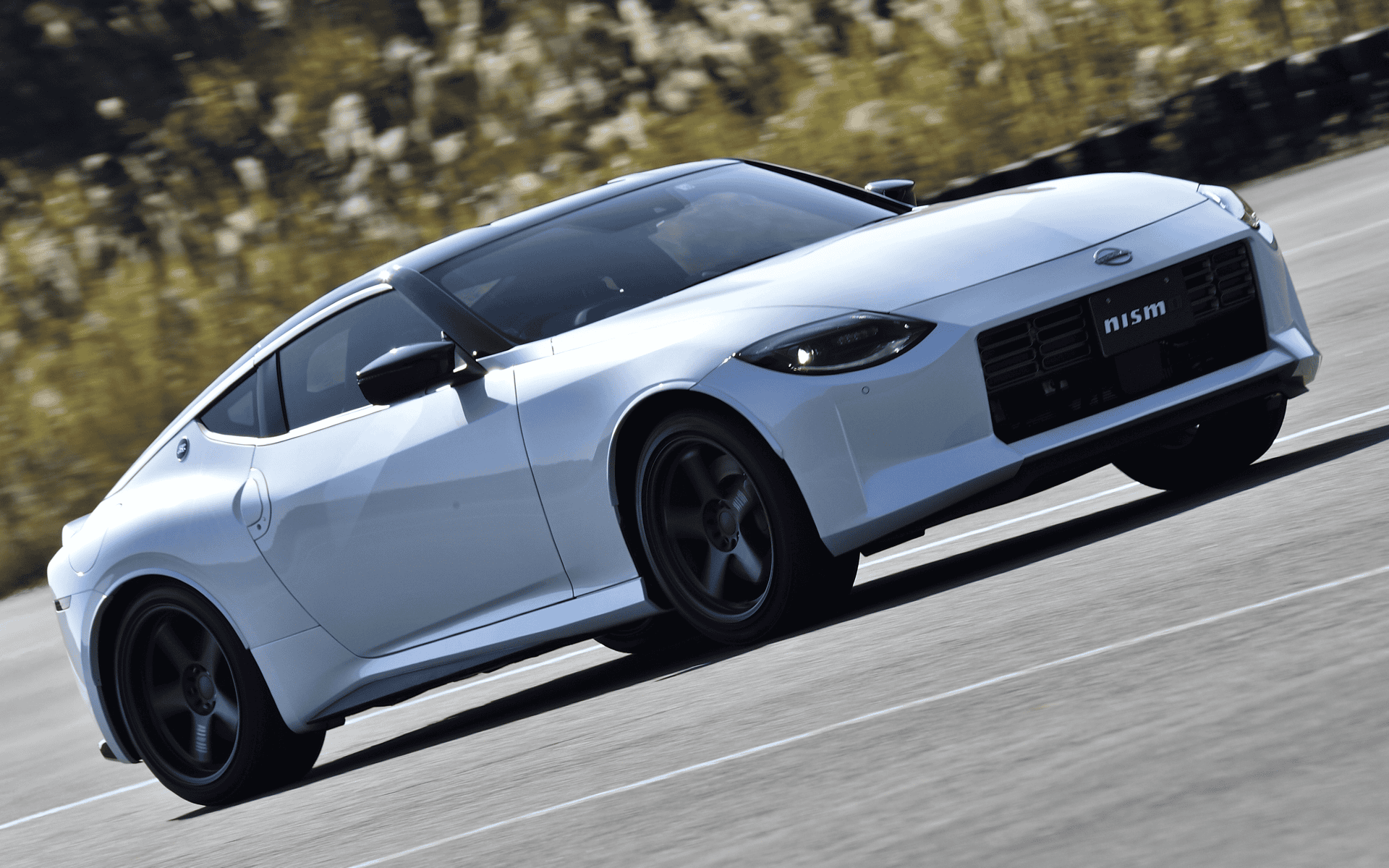

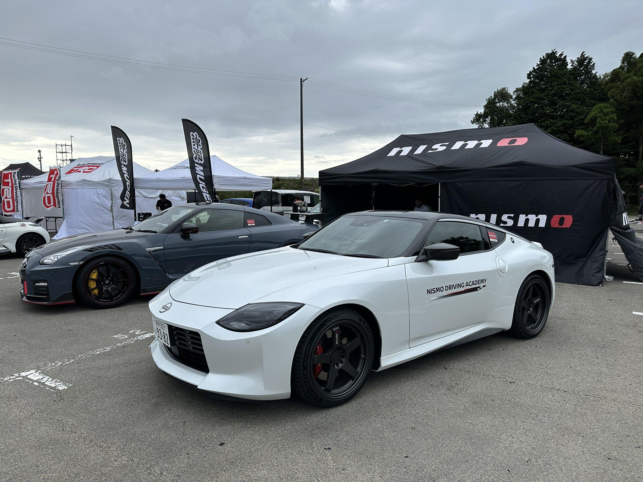

Nissan Motor Sports & Customize Co., Ltd. (Headquarters: Chigasaki City, Kanagawa Prefecture; President: Takao Katagiri; abbreviation: NMC) has launched a tuner-sized "LM GT4 Machining Logo Version" (new color matte gun black) will be on sale for a limited time. (Start of shipment: September)
A new matte gun black color has been adopted for the popular aluminum road wheel "LM GT4 Machining Logo Version" with the machined NISMO logo on the rim. Knurling is applied to the contact area of the tire bead to prevent misalignment of the tire and wheel, which is likely to occur during high-G driving.
Fairlady Z (RZ34)Front 19×9.5J: Reference tire size 255/40-19
Rear 19×10.5J: Reference tire size 275/35-19

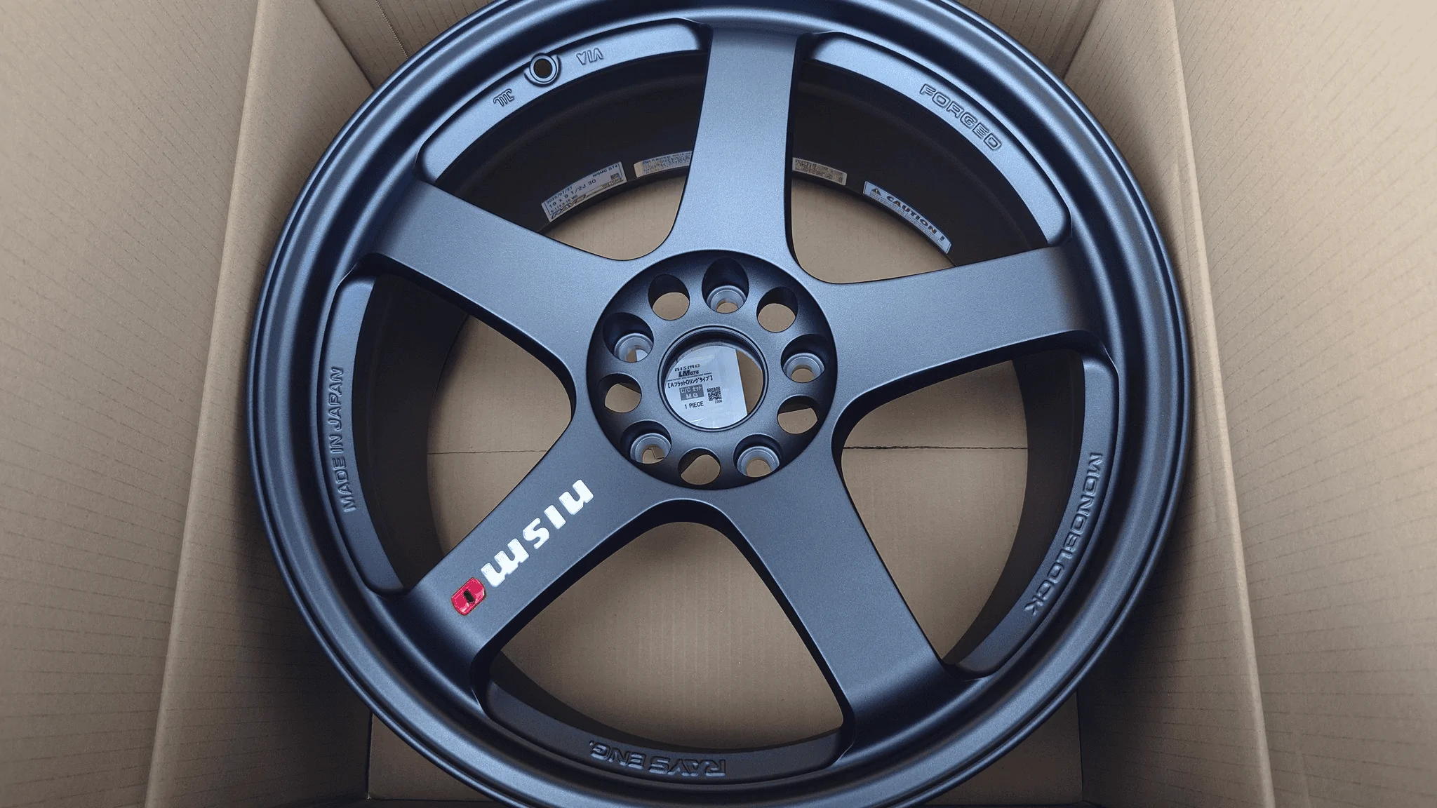

Since the OEM 2024 NISMO wheels have a width of 10" Front & 10.5" rear, I wonder if I will need spacers for the fronts, when I install my LM GT4s?
I also wonder if I should go with the reference 275 tire for the rears, OR the 285 OEM that comes with the Dunlops?
Thoughts?
