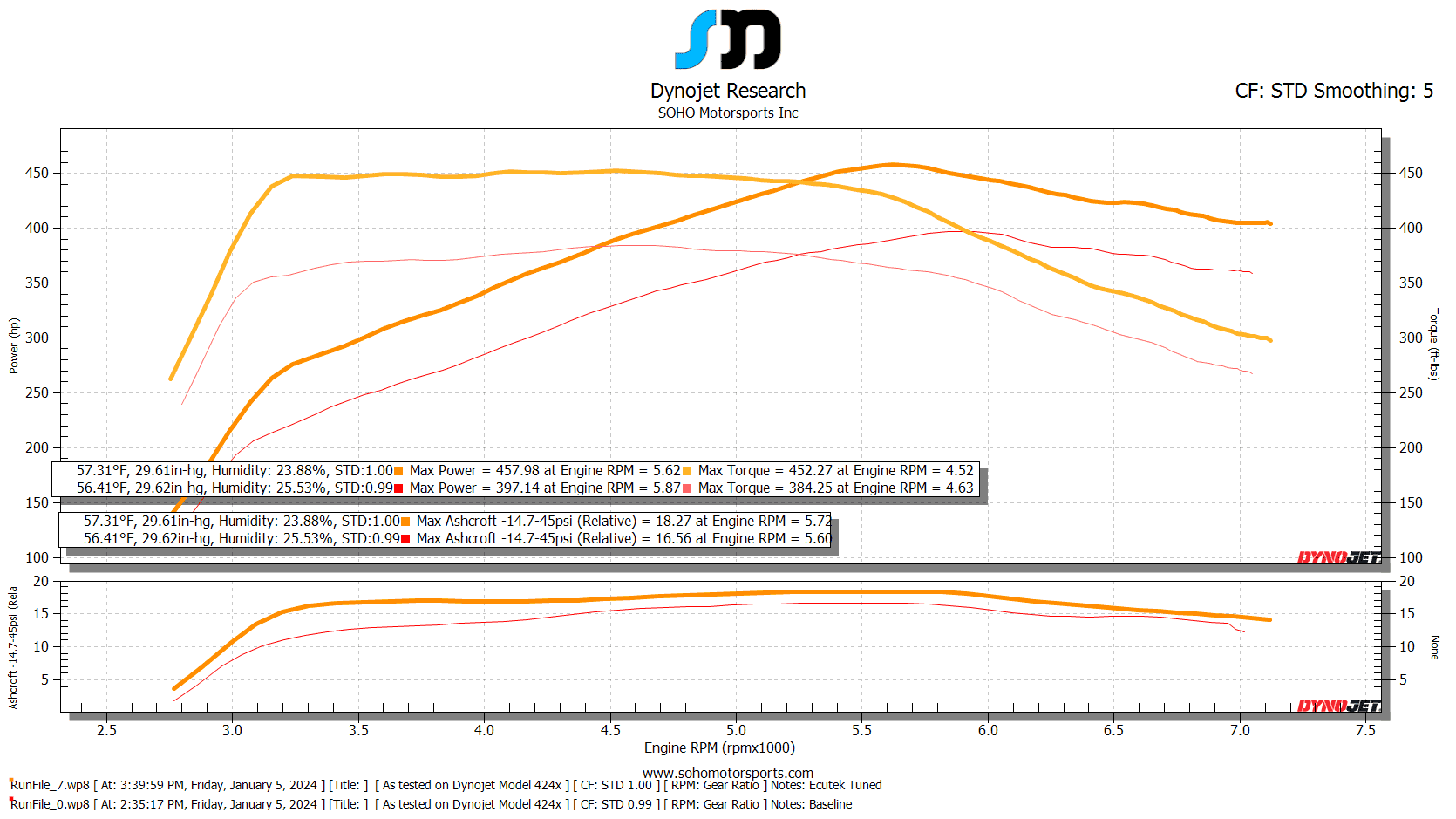

Dyno shows bolt-ons with no tune and post-tune.

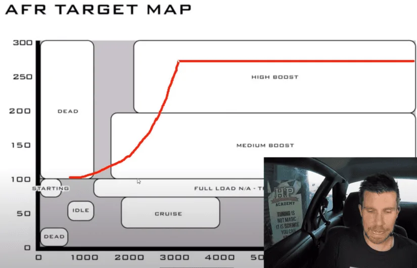

Hi Performance Academy link for the pic below. This video gave me the idea of what I think the issue is. More info to come!

Interesting, how did the AFR look like between that RPM range? Running lean or is it just the throttle mapping on the tune?
TwinZurbo
TwinZurbo
Sep 1, 2023
34
32
North Carolina
2023 Z
I don't currently have a way to pull that data. I bought a license to tune and took it to soho.
I've been wanting an AFR and an intake charge temp reader..
I suspect some of it may be AFR, some may be throttle mapping.
My concern is I'm asking something unreasonable. Would a different boost controller or a BOV instead of the recirculating wastegate change behaviors? Or perhaps make less desirable behaviors easier to eliminate?
