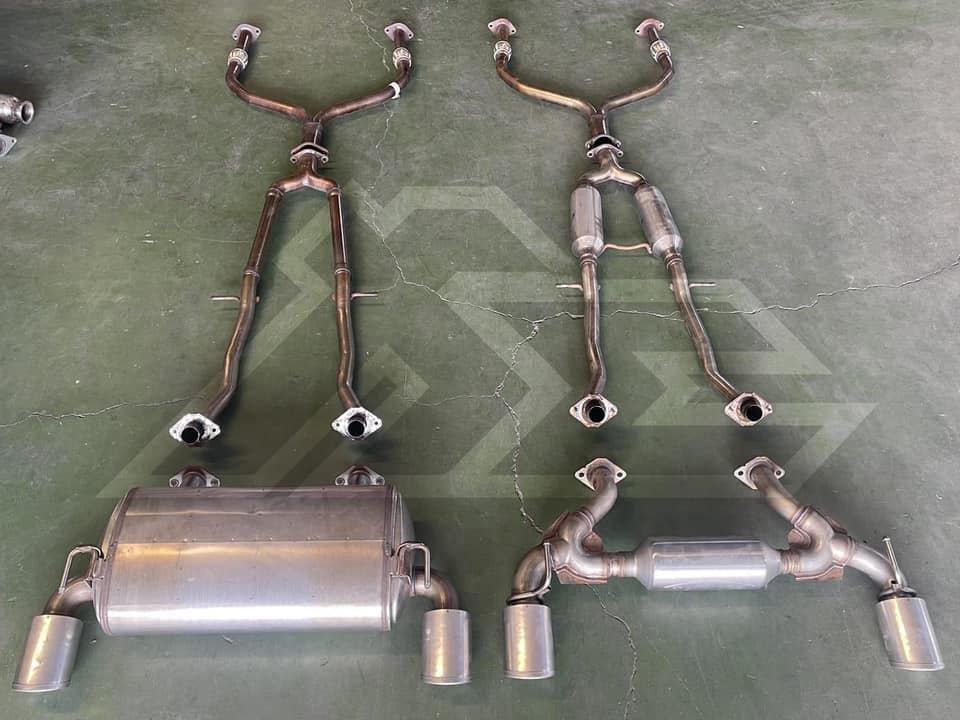

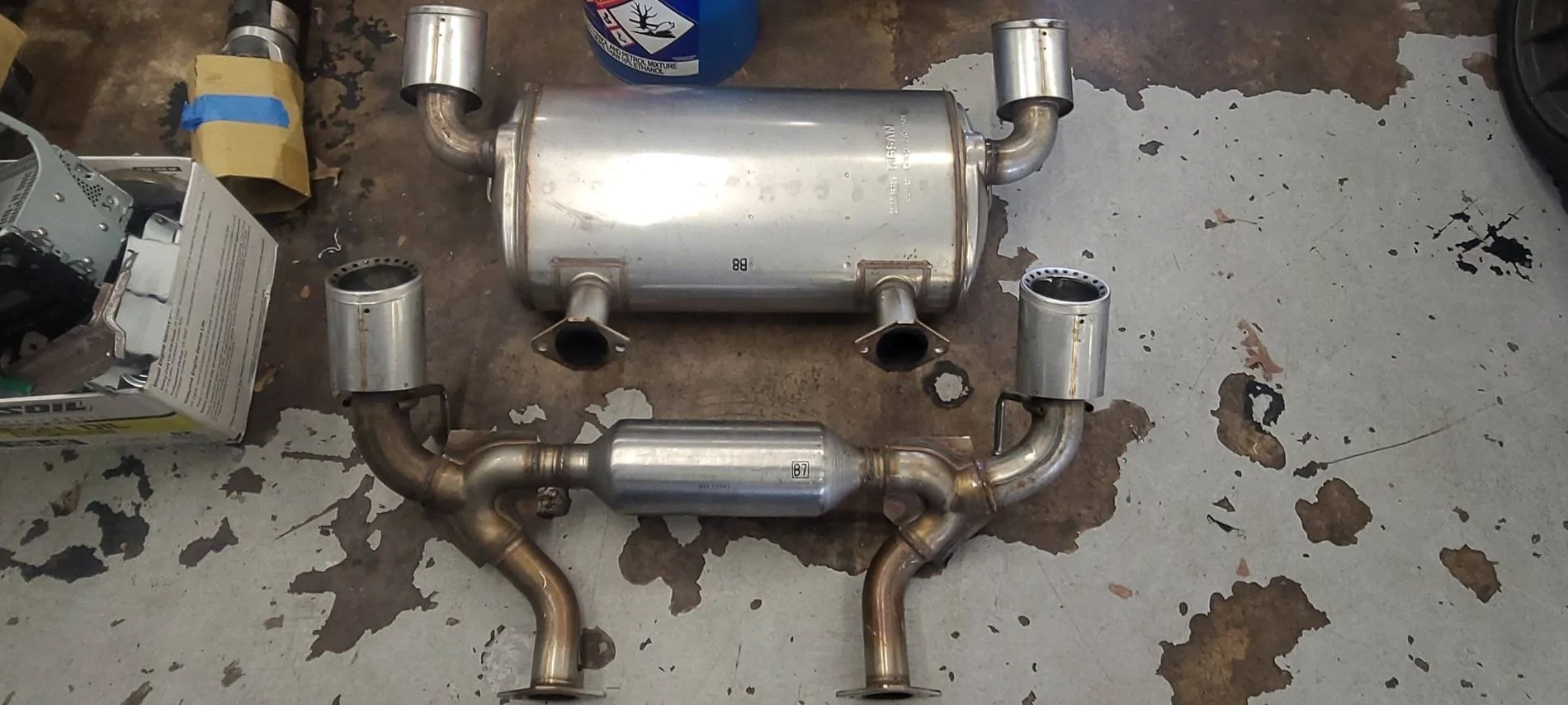

I didnt like how the stock manual axleback sounded like a whisper for a sports car. Pulled the trigger and picked up a used Auto axleback
Sound clip speaks louder than words

Welp... even here our auto models get the fat muffler and the hotdog resonators. It made 0 sound, no literally 0 sound from the factory. Now with the awe touring car sounds waayyy better, but imma get the track conversion to open up the top end sound cause from 3-4k its loudest but anything above and it sounds like air.

Hi All,
I am considering this mod for my Z. AFAIK AUS don't get this part on local (RHD) auto Zs, all are the large rear muffler. It would appear the same rear muffler was used on the Infiniti Q60s, although it is a different part number. I can get one of these at about half the price of one sourced from the US.
The Infiniti part # is 20100-5CF0D, the Nissan Z part# 20100-6HZ5B.
Can anyone confirm it's the same part?
Edit: The more I look into this it seems the Infiniti part is the large muffler version.

So I ended up doing this muffler swap. The shop looked at me sideways for swapping a stock muffler for another stock muffler. But they were amazed at the difference in sound afterwards. I am truly happy with this minor modification as it still keeps my car “stock.” Thank you to the OP.
