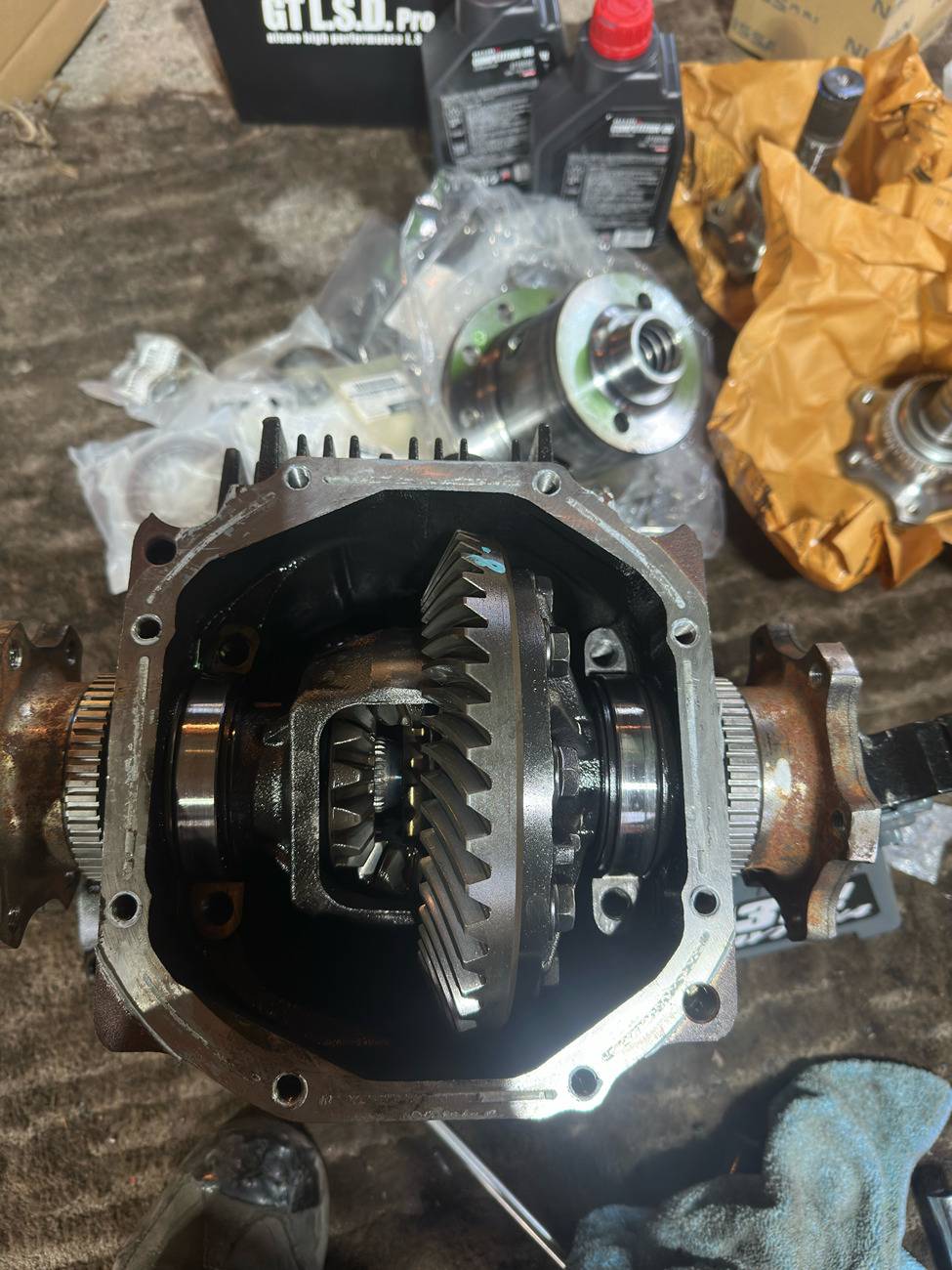

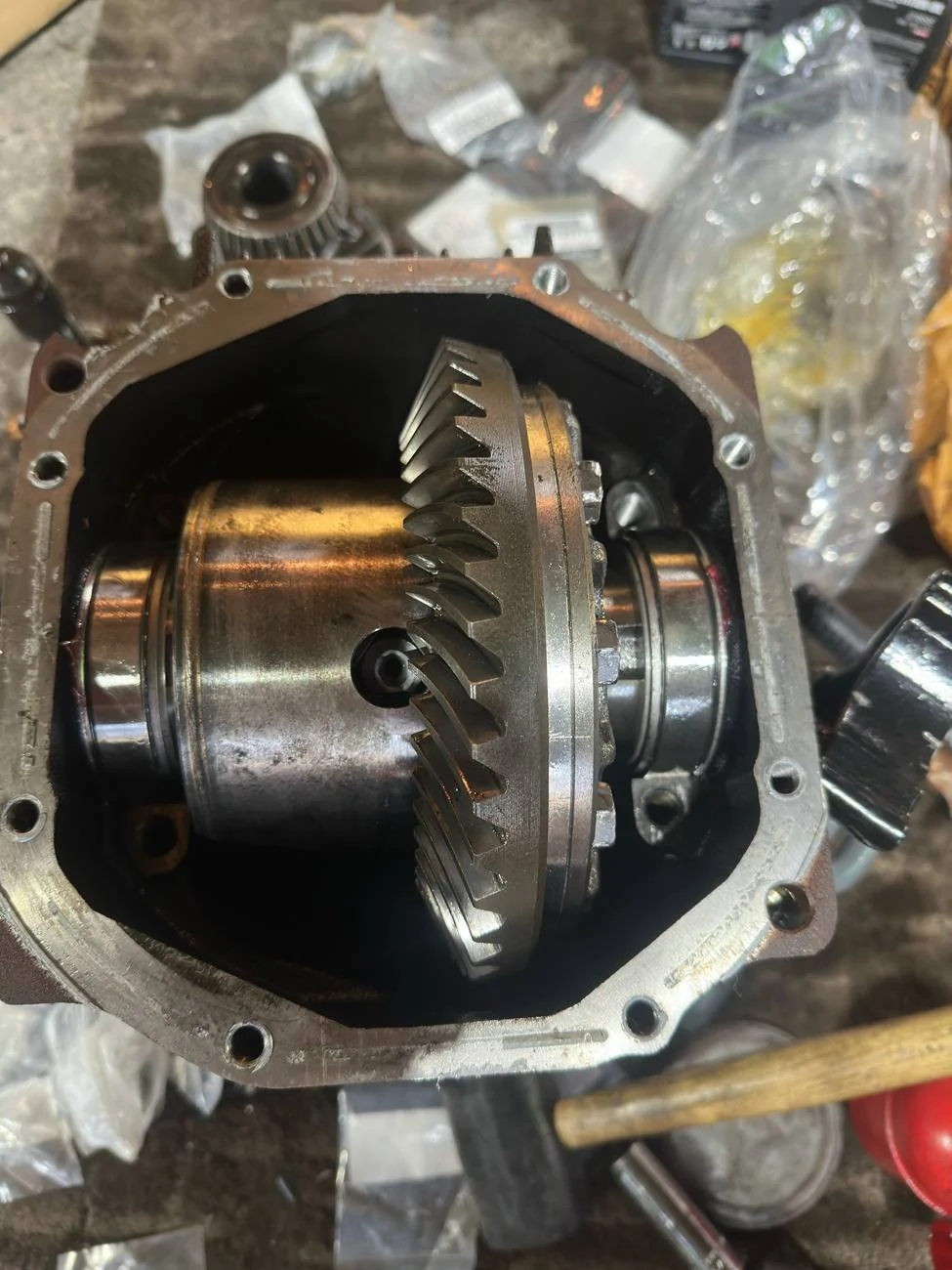

The LSD itself is essentially a direct swap here are some photos : I'm sure the difference is noticeable, the biggest pro to this LSD is not only is it fantastic as was shown in the 2023-2024 super Taikyuu racing; but Nissan offers a warranty on it. It can fit the base sport, and performance. The diff cover z1 can also fit in, it's just a matter of liquid- I'm aware you came from a viscous type LSD and naturally the Clutch type here offers more ease in that sense. I have the stock diff cover, and it's a huge NOTE for the first 600-1000 miles. The car will jitter in extremely small parking lot turns and u turns, if you manage throttle input you'll be fine. The jitter will go away and what comes is like a light ringing with a slight engagement "knock" it's perfectly fine and normal as the LSD is aggressive. I would personally say I am knowledgeable for the most part upon this so if you have any more questions be free to ask.
With Nismo LSD
Without Nismo LSD (Open)

Fantastic info and images, thank you! I'll try to be less concerned about the noises the new LSD will make lol. Are you running the Nismo competition fluid perhaps, the 75w140? I've seen people discuss using a friction modifier or something like that to help keep it quiet, what are your thoughts on that? While I don't have the LSD installed yet so I can't hear it, this won't be a daily driver so I think I might be able to manage without caring about the noises too much.
Are you using the factory diff bushings or did you go to solid bushing from z1 or SPL? They put together a quote for me with their diff brace, rear subframe tie bar brace, solid bushings, and the larger diff cover. Wondering how much of that is actually needed seeing as I only have 23 miles on the car
