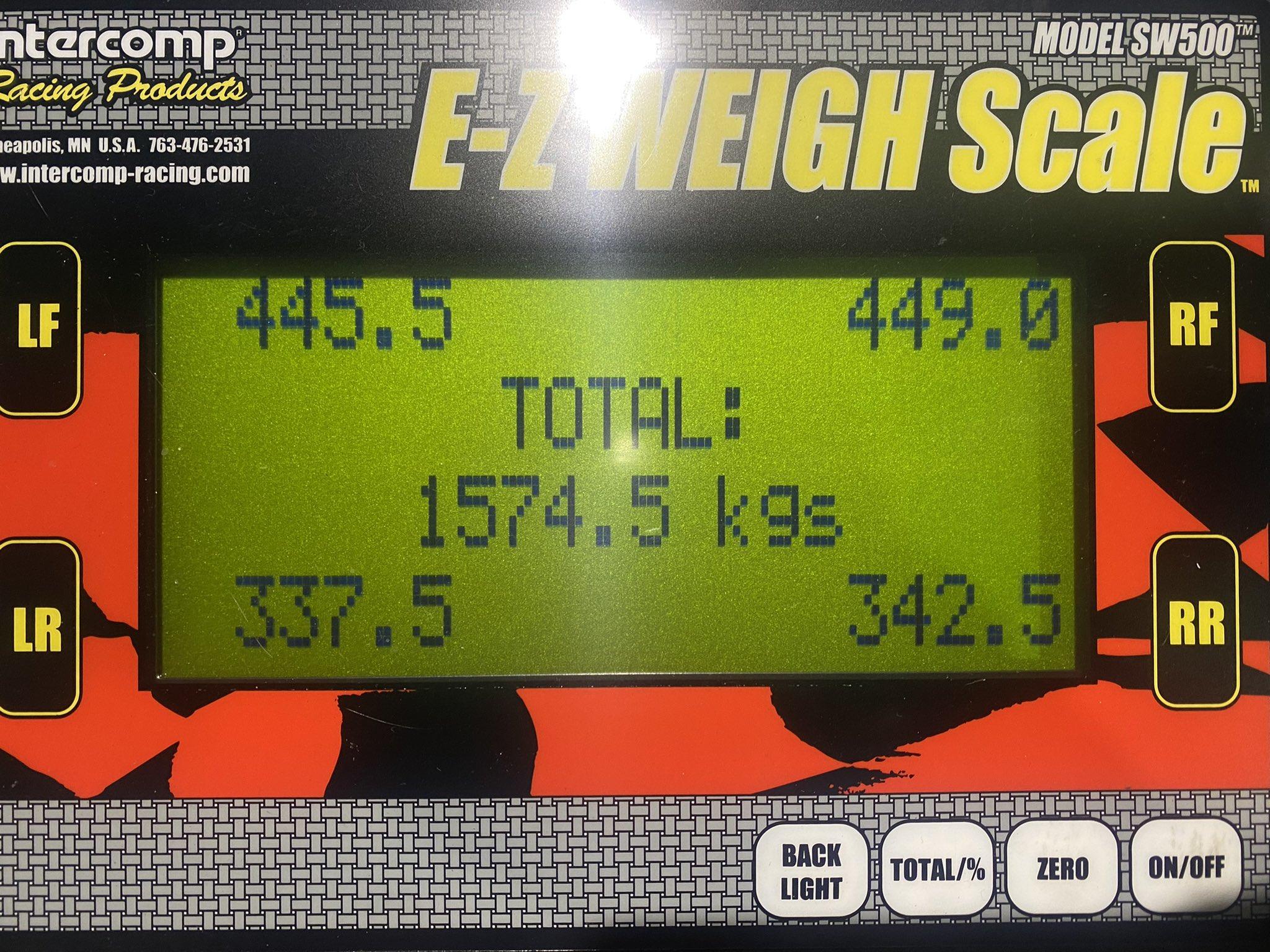

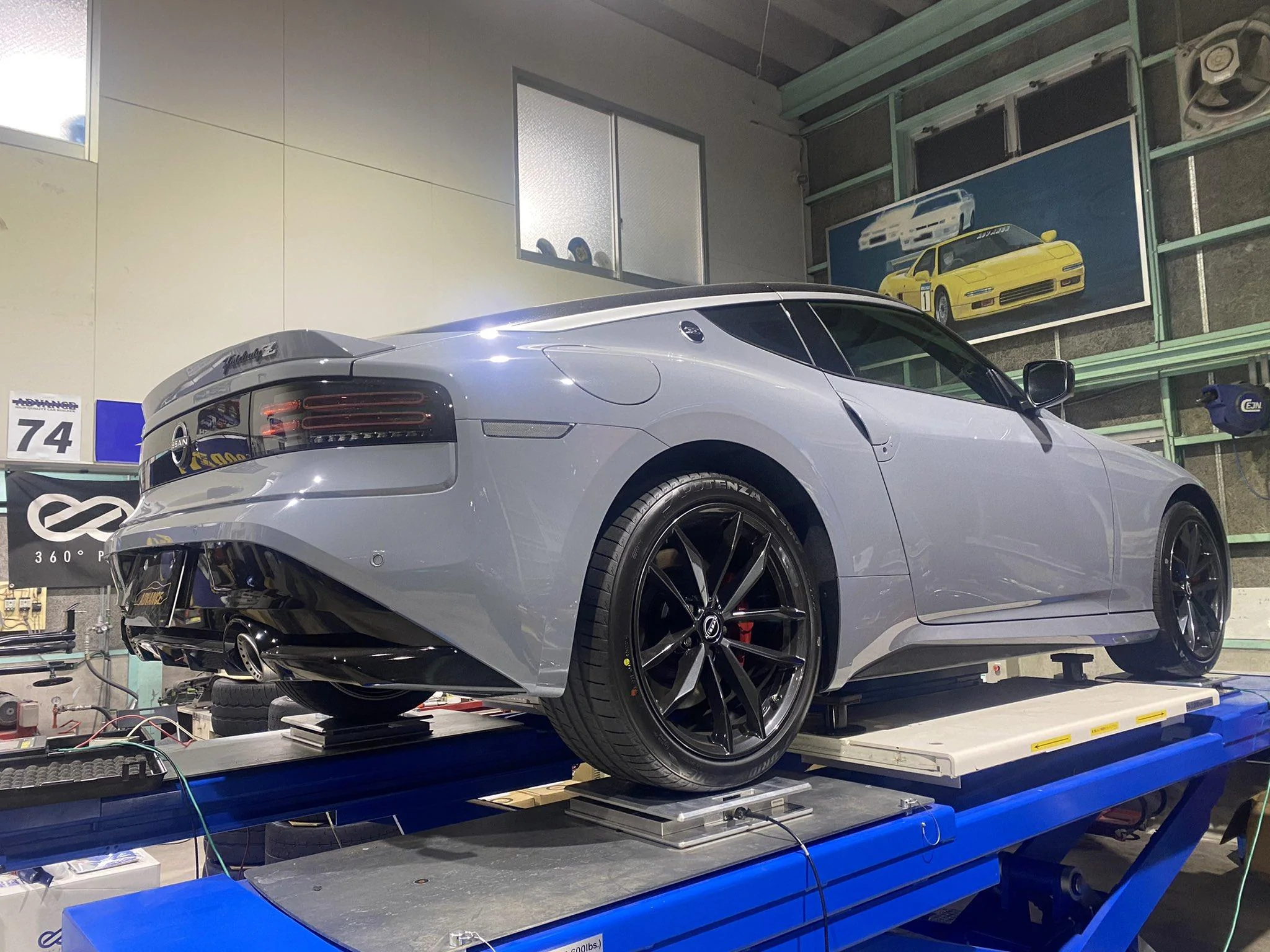

1,574.5 kilos or 3,471 lbs with a full tank of gas
Looks similar to a NA spec Performance Z, though based on that rear badge I’m guessing this is a JDM spec car?
That weight is significantly lower than the official Z Perf weights, but if this is actually a JDM car, it could be the intermediate “S” trim which would be like the NA Performance trim, but excluding the touring equipment

Yes sir
