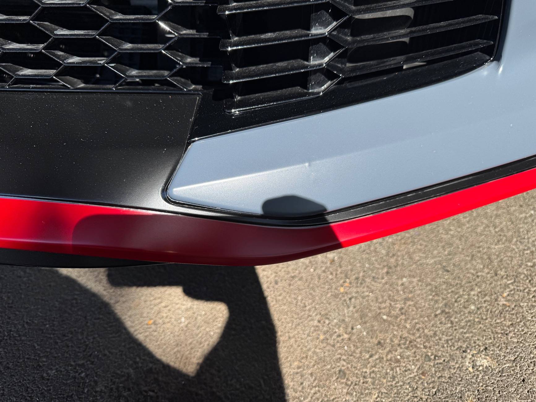

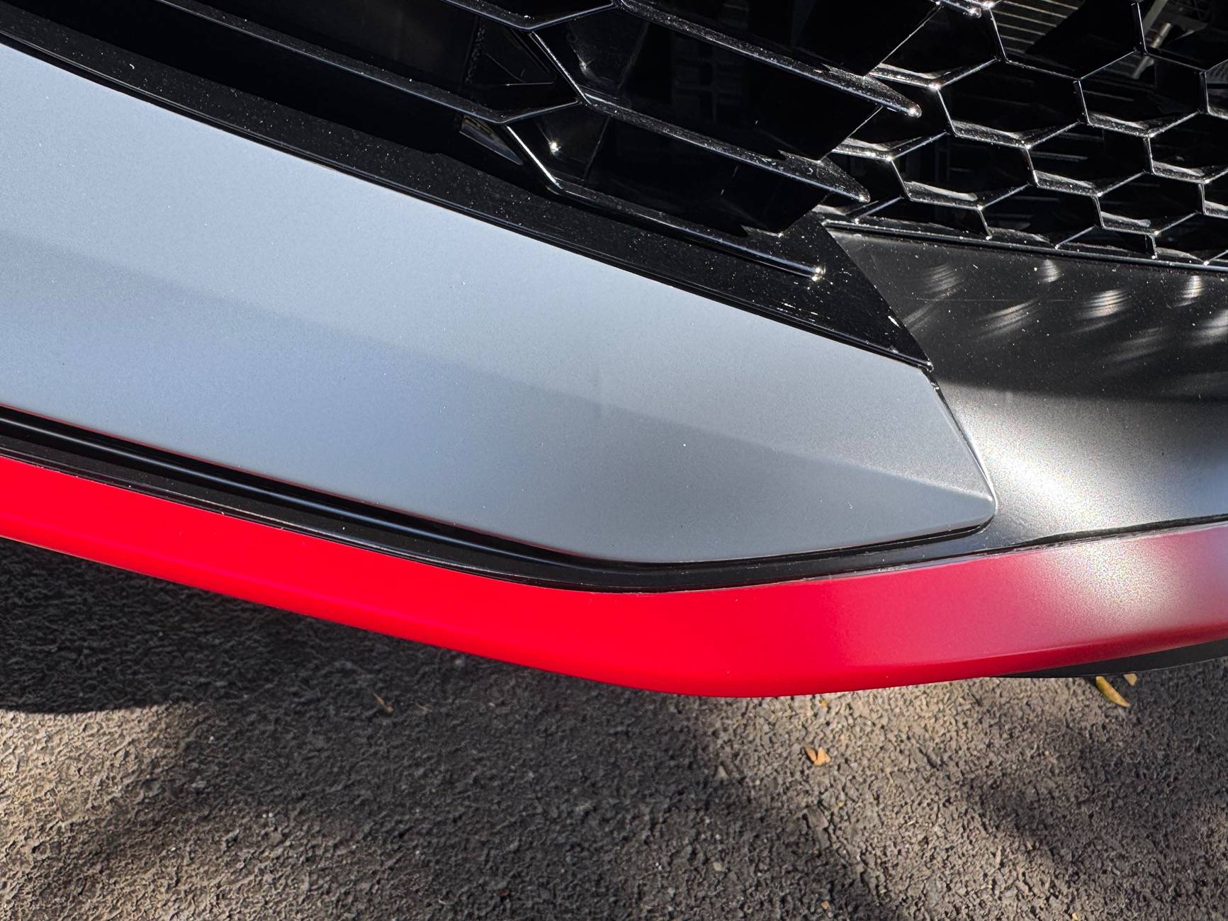

Speaking of Nismo’s….to those owners. Recently noticed what appears to be bubbling under the PPF on the front bumper. was never there before, and oddly it’s almost in the same location on the other side of the bumper. I don’t think it’s a defect in the bumper itself, but be curious to hear anyone’s thoughts on the matter.
Apologies if this is the wrong thread, but hoping to catch the eye of all the Nismo owners. Thanks!

Do you know it’s bubbles? You can smush them?
Whether it’s air or trapped application solution (don’t know if they use that for PPF) poke a little hole straight down into it with a small syringe needle and bleed whatever it is out. A pin or sewing needle could work too, but you’re more likely to see the spot you punched after it’s flat. If PPF works like vinyl wrap it shouldn’t come back.

Copy…I wanted to throw the ask out there before any poking and prodding. Hoping there wasn’t a larger OEM defect at play, but definitely bringing her back to the installer if it is a defect in the PPF product or install to get after.

How recently was the PPF done and assuming it’s garaged or stored, have you had a chance to let it bake in the sun? They almost look like creases that haven’t worked themselves out yet. 100% of the PPF I’ve had applied is filled with visual anomalies for about a week until it can cook in the sun for at least 20-30 hours spanned over many heat cool cycles. I intentionally park in the sun as much as possible post install so I can get it back quick if there is a real problem that hasn’t healed. This is the case for bubbles or creases. Was the lower portions done in track armor oriented PPF? If so, double the time above as it’s very thick.

PPF has been on there for a few months now although I tend to keep her in the shade or covered when home as my daily she’s always outside.
The entire job was in XPEL stealth PPF but I have some time this weekend for a few pin pricks while I keep her in the sun. Thanks!
