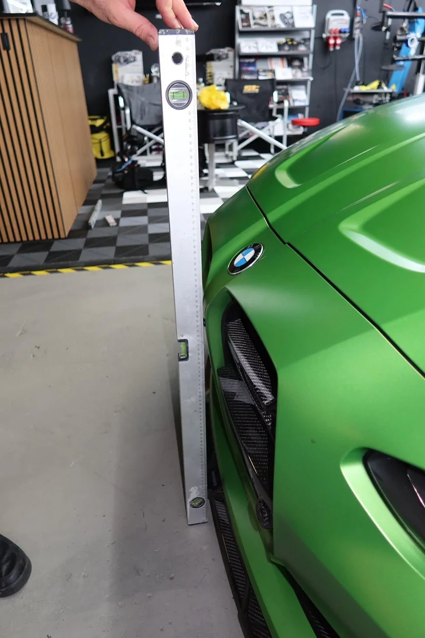

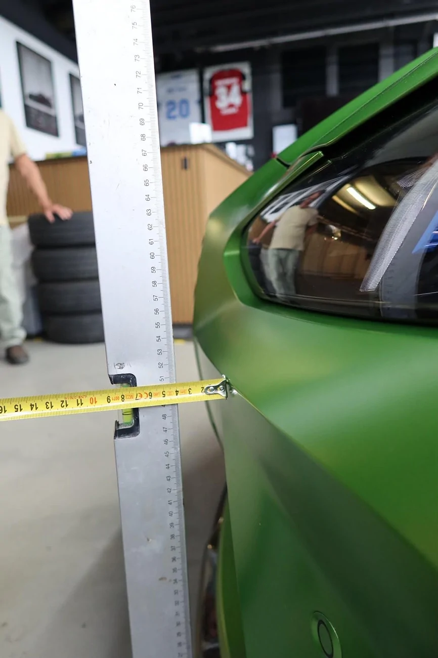

The front lip cannot protrude more than 5cms / 1.97 inches from the most outward part of the bar.
The measurement is to be made in the center of the front bar with a level and then a ruler or tape measure to see how many (preferrably) centimeters it protrudes.
The next measurement is to be made further over the side of the bar and measured the same.
The very side of the bar near the wheel does not matter only the front of the bar where youre most likely to hit a pedestrian head on.
I attached an example of an M3 how to measure. As you can see, this cars front lip is in range.
