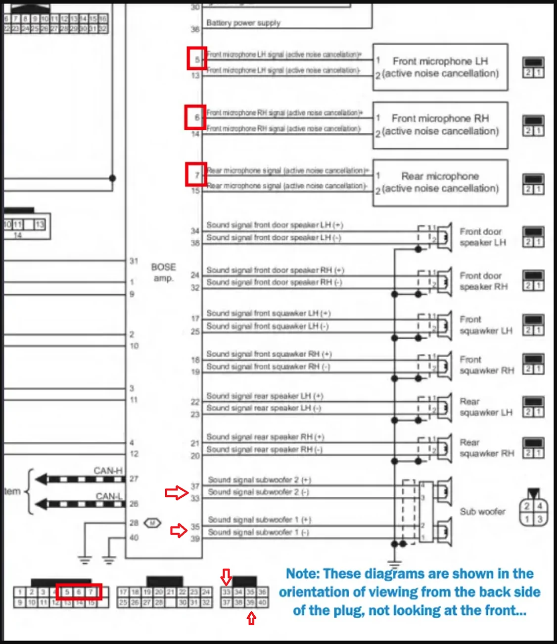

I only got my powered sub to work by pulling the low signal before the Bose amp. Tapping the connector for the passive OEM sub either got silence or just a rythmic thud sound. I used some RCA connectors with wire pigtails to run the signal to the new sub. Finally works. See the red arrows below for the sub low signal, borrowed this image from the manual ANC disconnect thread.
thanks I'm going to give this pic to the shop. I have an appointment back there on weds. The guy thinks that he'll have to disconnect the ANC mics, so hopefully this will avoid that.
