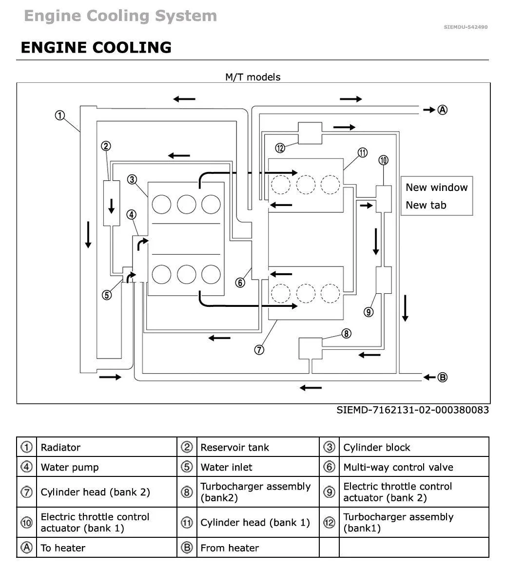

I looked through the service manual hoping to find a diagram of this area, but the closest thing I could find was the engine cooling diagram.
I guess there must be a valve and a radiator from point A to point B in the diagram that is incorrectly open for the HVAC mode you're using.
