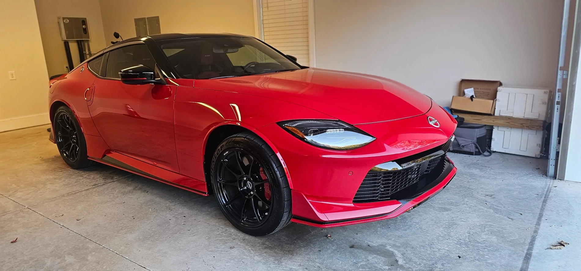

Nice z👍, I would like to see, first I’ve heard of spacers, thanks
