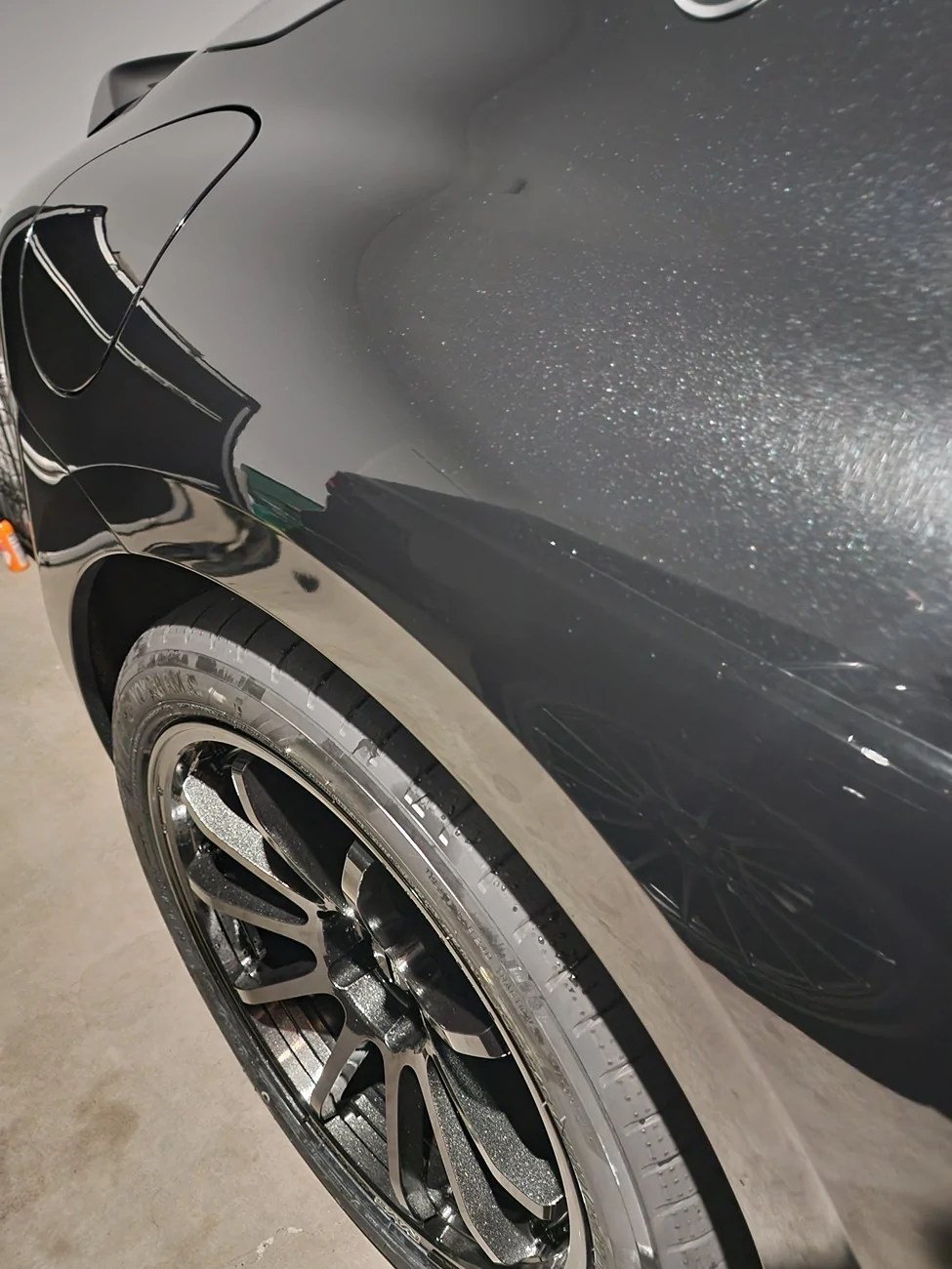

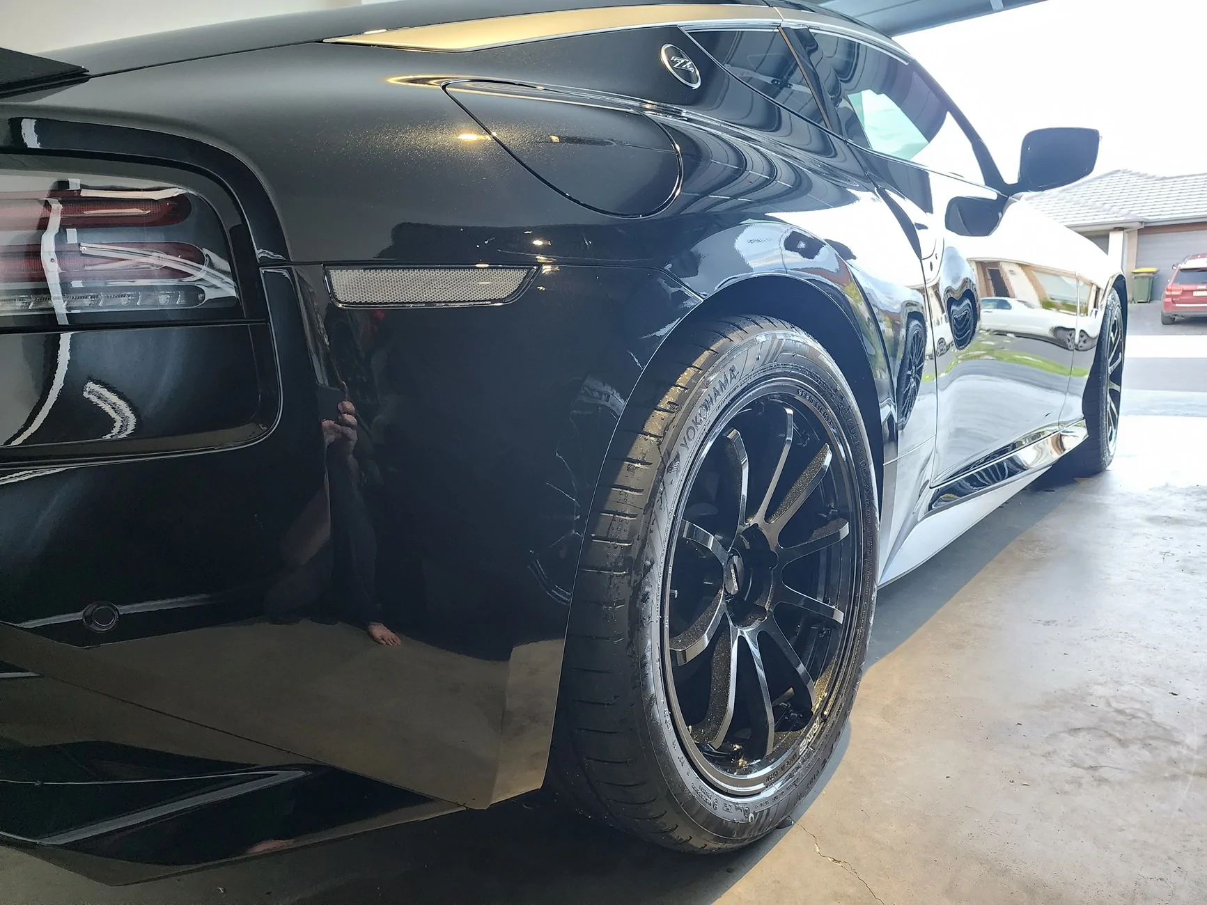

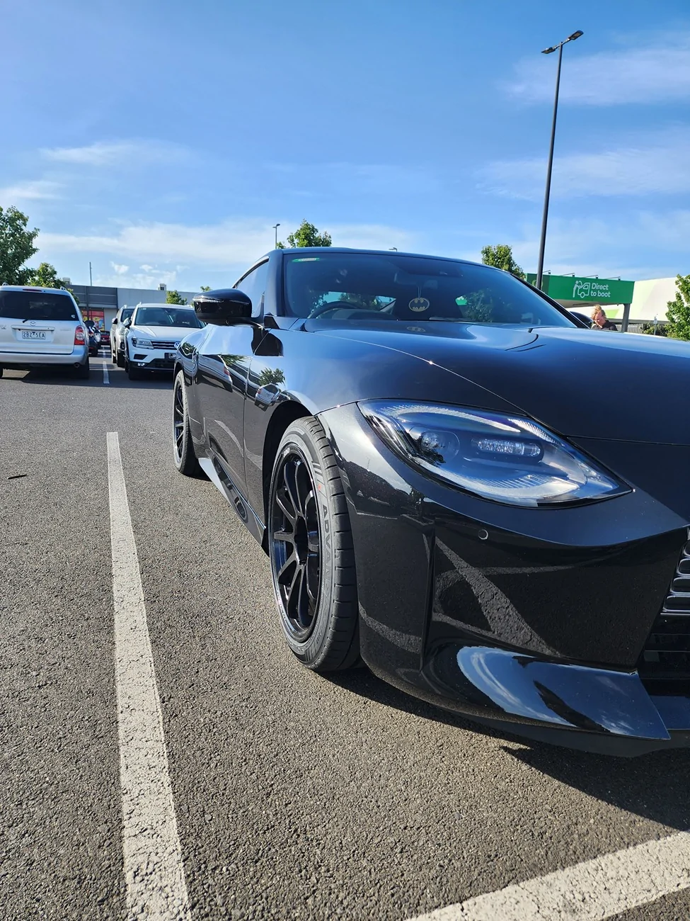

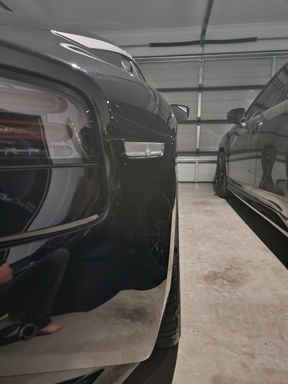

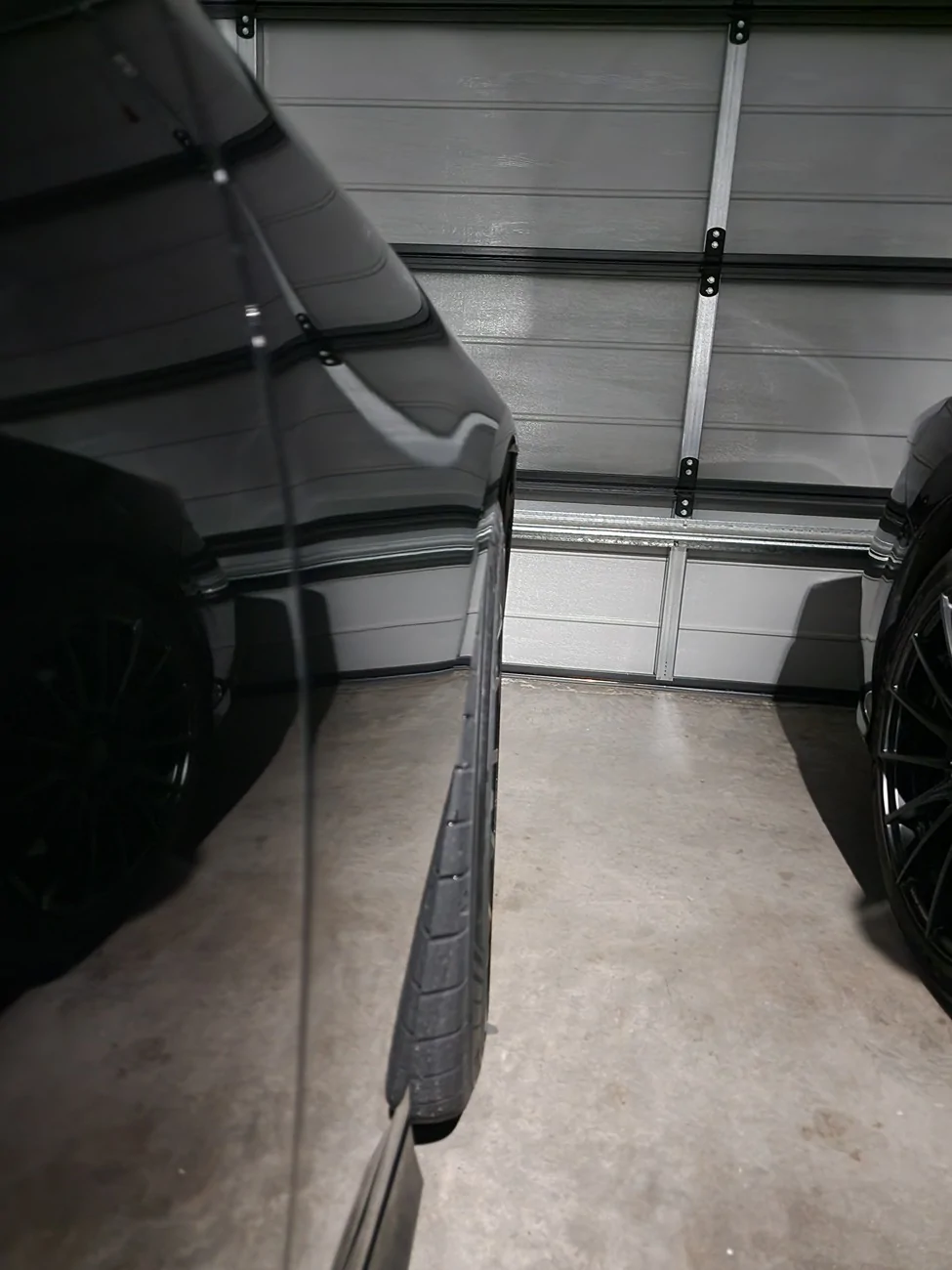

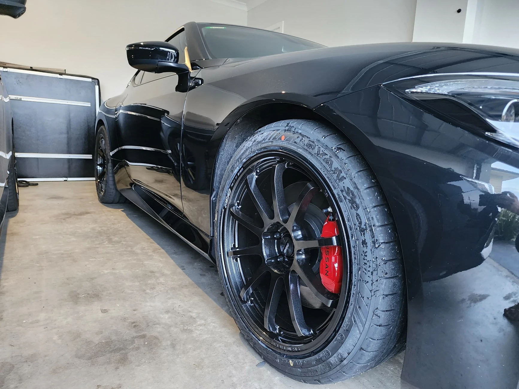

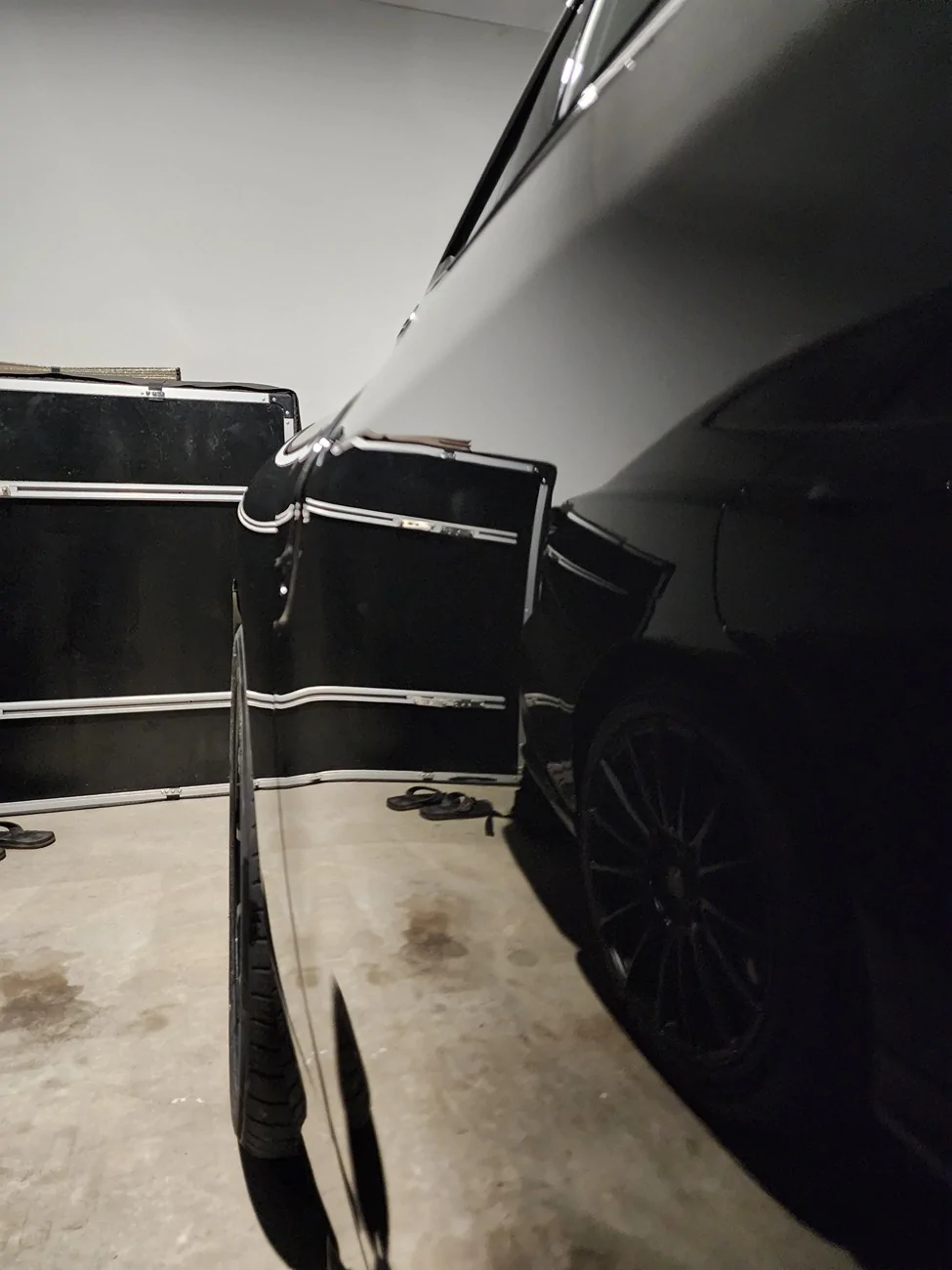

Same size as a lot of other guys in here, and I'm extremely happy with the look and offset. I couldn't get a photo to do it justice, the paint is almost colour matched to the Z, but the wheels have slightly more metallic shine to them.
I was thinking of going to 11" rears, but I'm stoked with how this came out.
Fronts 19 x 9.5 +25 with 255 x 40 tyres
Rears 19 x 10.5 +22 with 295 x 35 tyres

Also the alignment results surprised me, it had quite a bit of toe in the front and rear before. Almost at 0 now, with what I believe is the factory camber of 1.6deg front and rear.

The offsets and tires look perfect for those sizes and stock alignment, and I’m against spacers to fit any wheels. Nice job!

Thanks man! Couldn't agree more about spacers too.
It's funny, this is the first car I've ever owned where I quite liked the factory wheels, but the offset was terrible, and I wanted a touch wider in the rear anyway.

Batmobile, nice. The wheels look great.
Is it lowered?

Haha, I thought it was the perfect choice of air freshener.
No, it's stock suspension. I'll start looking at Coilovers when I eventually move. I had to buy ramps to stop from scraping out of my driveway as it is.

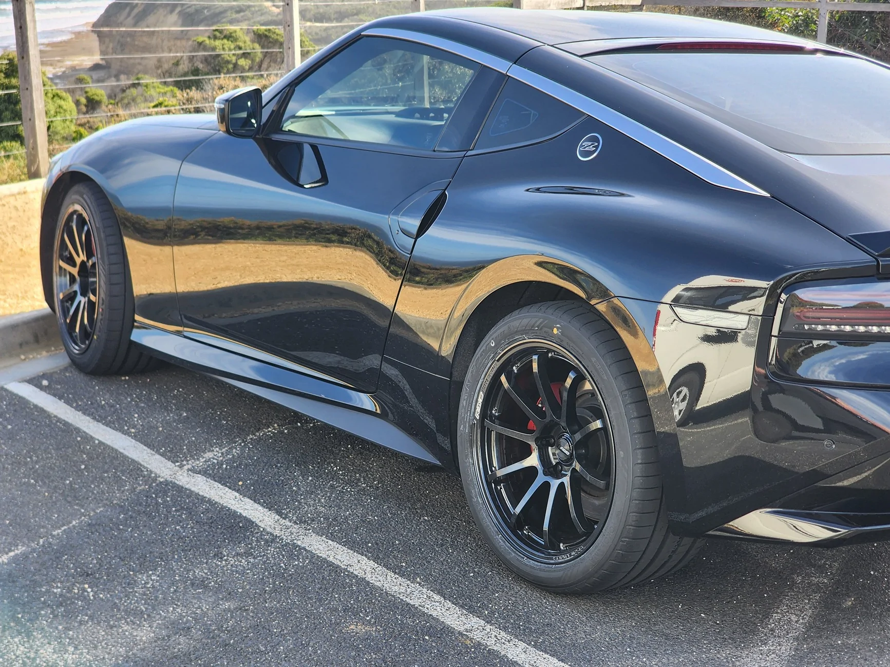

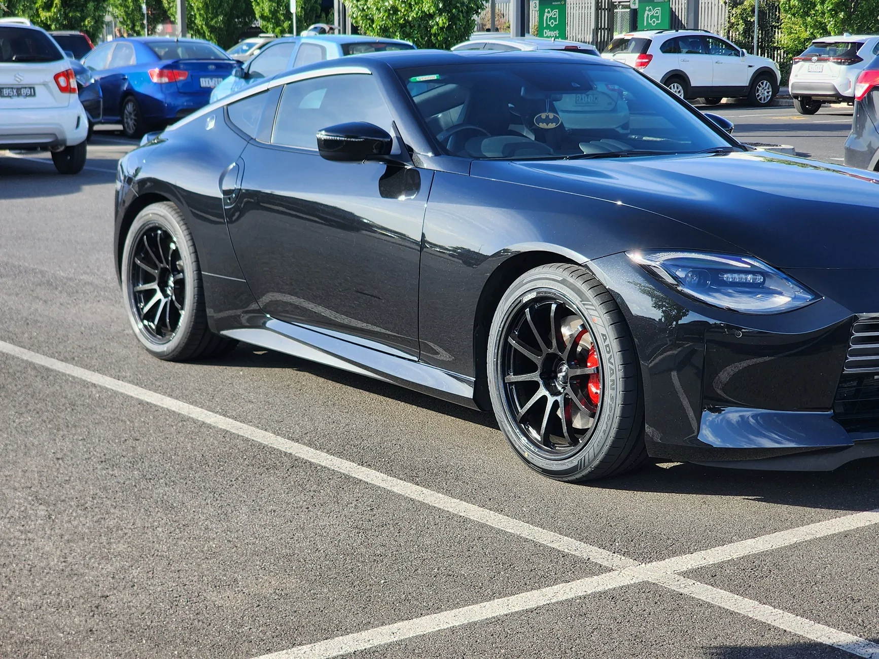

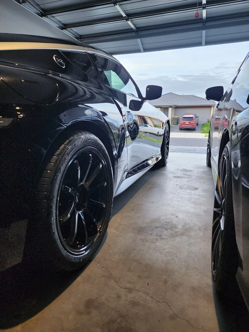

Some better shots with an actual blue sky for once.
Now just to paint the calipers black, and she's done.
By any chance have you tried putting the rears on the front?
Im looking at getting these wheels but 10.5 all around, and wondering if they will hit the caliper :S

I have not.
Fitment would be horrendous with the factory suspension, but I've seen plenty of posts in here from people with square setups. Also, not sure why you think they would affect the Calipers?

Thanks for the quick response!
Just going off the rays website, they say it may not clear the calipers with the F3 face,
Was looking at going 19x10.5 +35 F +12 rear
