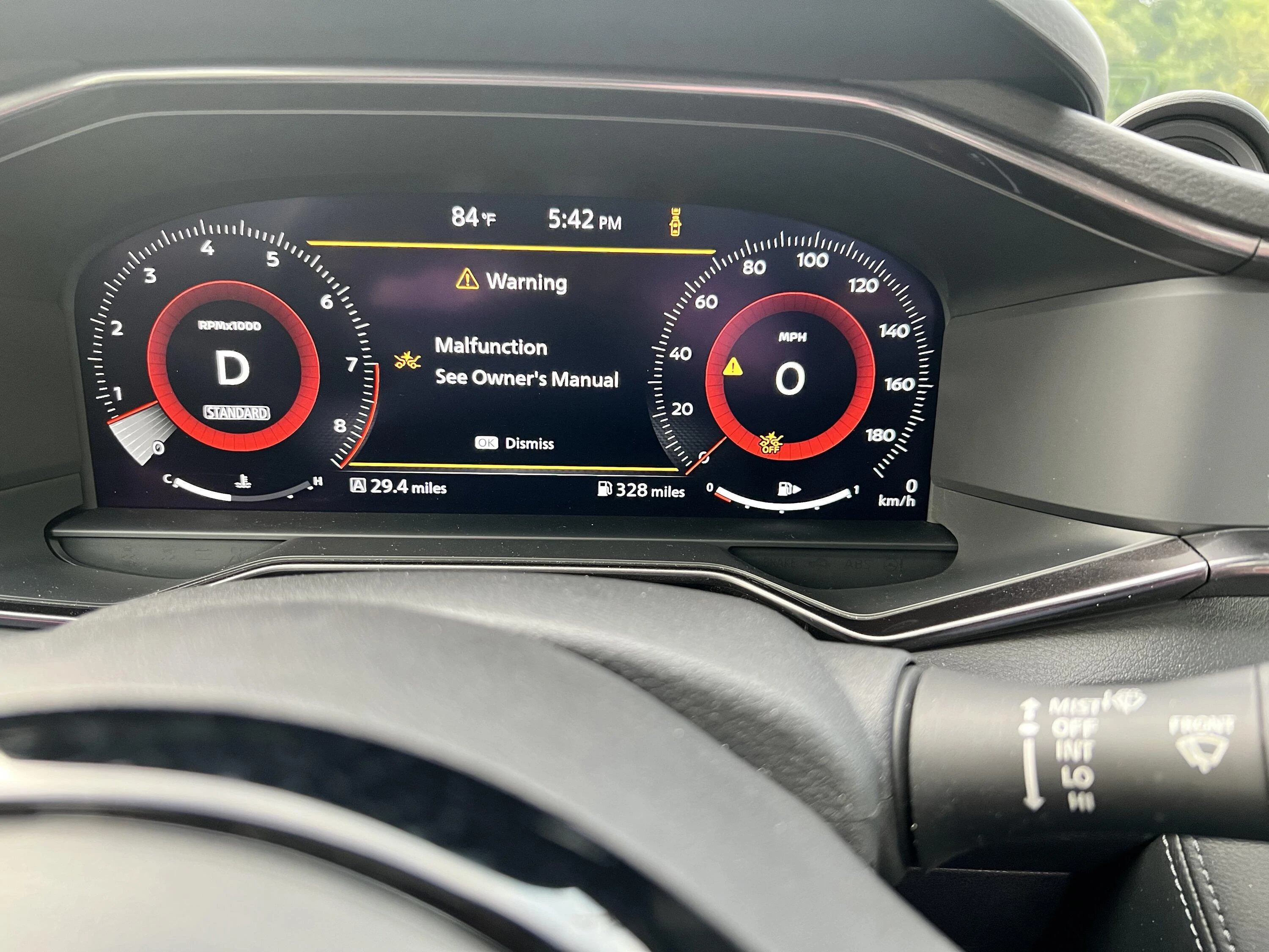

Error every time I drive. The car starts without issue but within 5 minutes This error message is displayed. Can anybody help!

About 3 weeks ago I started getting this error message every time I drive the car. It stays displayed until I turn off the car.
Any suggestions to get rid of it?
If I had to guess based on the dash indicators, it looks like the forward collision warning system has an issue. I'd make sure the sensor isn't blocked first. If still having an issue, take it to the dealer.

There’s nothing blocking the grill or front bumper. I’ll call the dealer to make an appointment

the Z was recently added to this technical service bulletin
https://www.tsbsearch.com/Nissan/NTB19-033
also had this on my wifes 2022 pathfinder occasionally and it was driving into the direct sun a certain times of the day that would obstruct it
