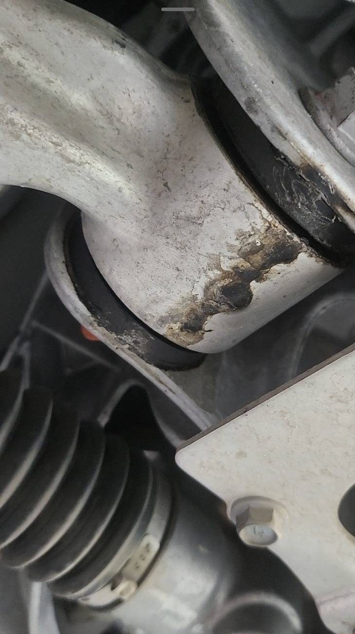

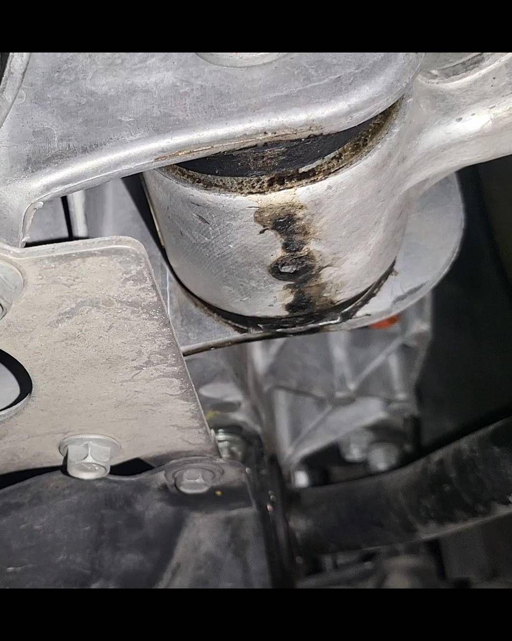

Had a steering issue in my car for a while and still have it unfortunately after taking it to try and fix at the dealer and different garages mutliple times. So I took it another time and noticed a black liquid substance at the right control arm bushing. Not too sure what it is but it could be the reason for the steering issue? But yeah the left bushing is clean in comparision. The movement in both are kinda the same when steering, maybe the right bushing a bit more.

I don't think the small bushing on the front arm is oil filled so that probably just some residue from the rubber or road grime, I wouldn't worry about it. If you are having a steering issue have your alignment checked. The alignment on these cars seems to be all over the place from the factory. They basically phone it in..

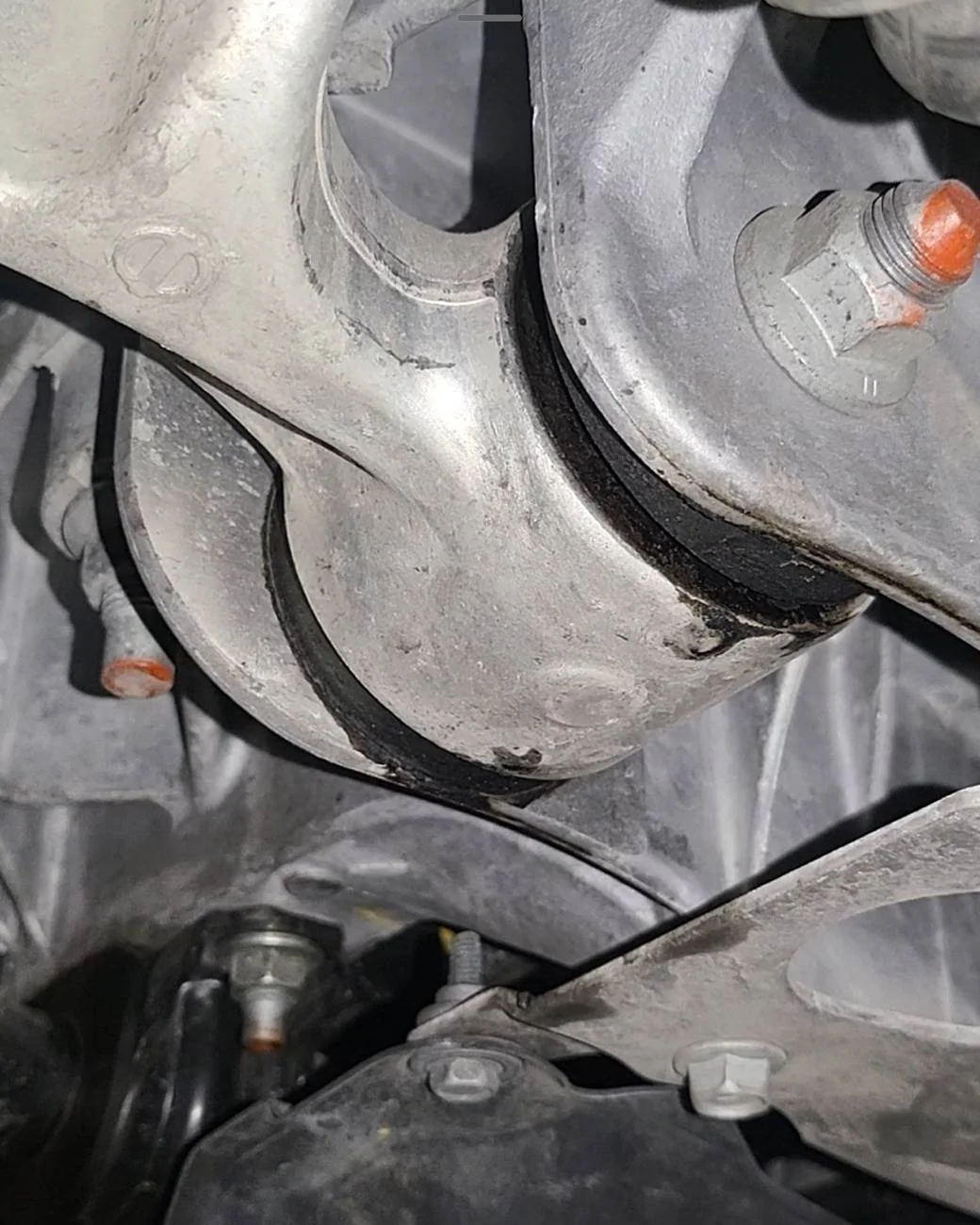

Heres the left vs right control arm bushings.

Those black rings on ether side of the control arm are not the actual bushings, they are rubber washers that are paced over each side of the bushing. Nissan also puts some lube on the washers ( most likely lithium grease) It may be the residual grease getting squeezed out.

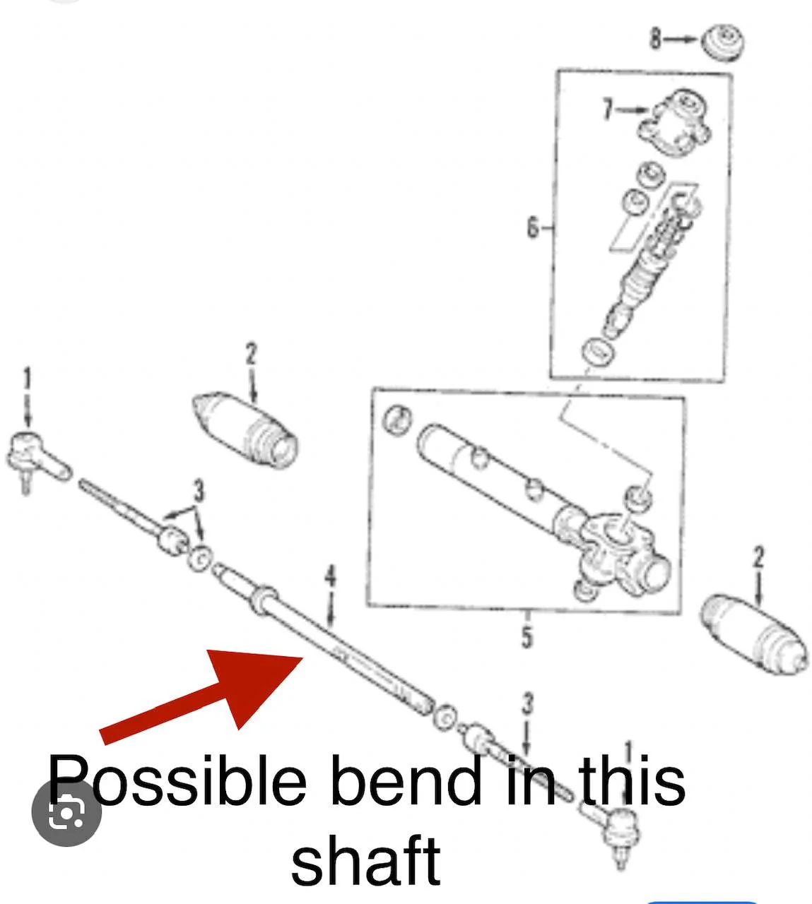

This is not a Z rack but an example pic, they are all similar. That shaft ( #4 ) is the main shaft that sticks out of the sides of the rack and swings left/right that the inner tie rods are attached to. The tolerance is very tight in the rack housing, so if that shaft is just slightly bent it will bind on that side when it slides into the rack. You will not have any electrical faults as it is a mechanical issue. The shaft is usually made of steel but its definitely possible to bend it with an impact. You can try to disconnect both tie rods at the knuckle and steer the rack alone to see if you still feel the bind.

Ill try and see but its stupidly annoying. There are no mechanical sounds or any indication or hint of where the issue might be. Not just that, but there arent any visible signs of damage under the car, even after taking it to multiple garages.
