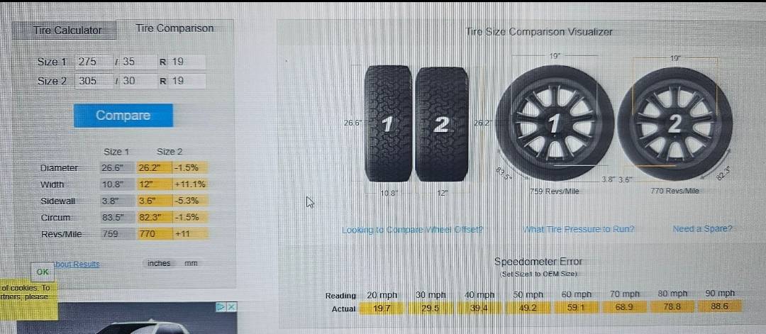

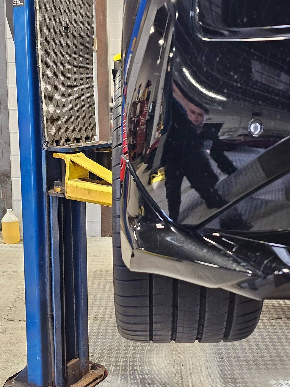

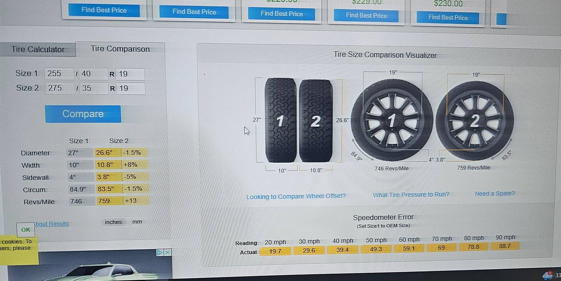

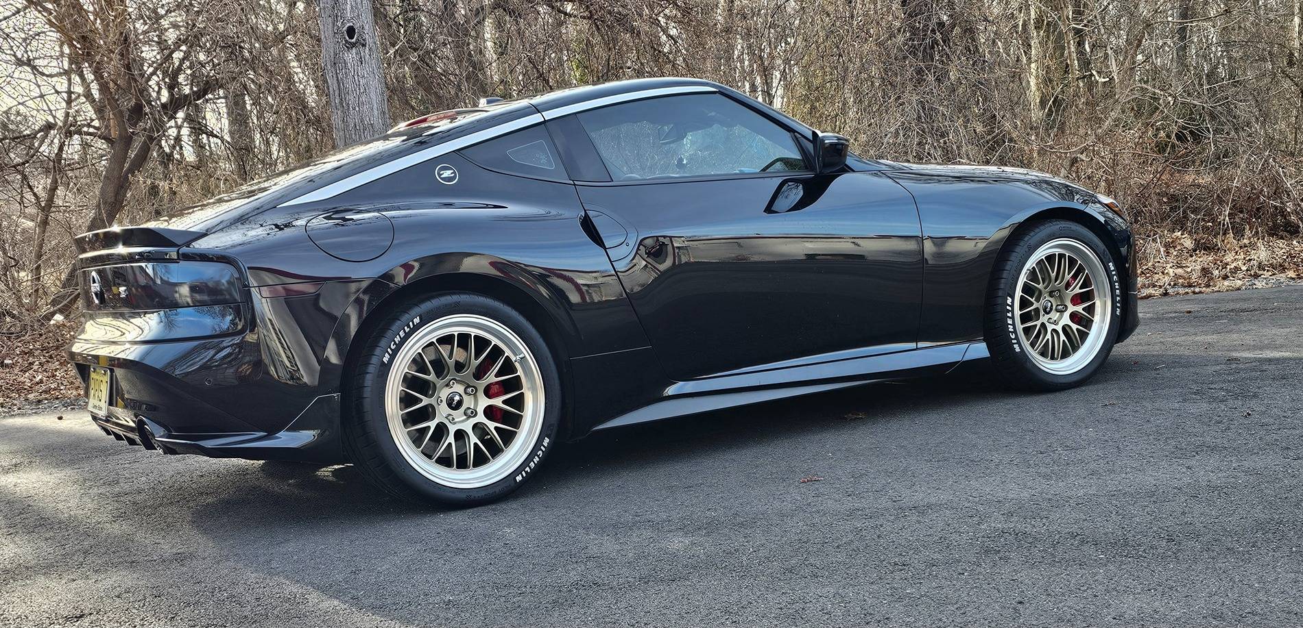

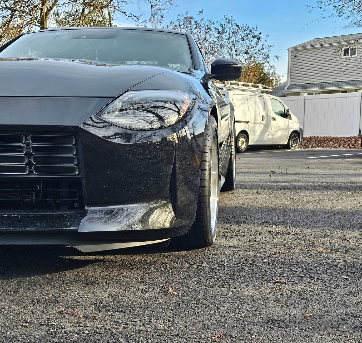

Spacers compensate for offset. Tire size is relevant to wheel depth more directly. A 305 would fit on a 10.5" rim - that is what mine is. With a stock rim you will need spacers. I worked with APEX and they nailed the offset so no spacers. Also, they knew what the backspacing would be for performance calipers. The attached pics show you dimensionally what happens from stock tire sizes to at least my tire sizes and effect on spedometer. Its a tire size calculator

So 20 mm spacers front and back should be good enough to clear 275/35 and 305/30

She look good! We gotta cruise together this summer one day!
