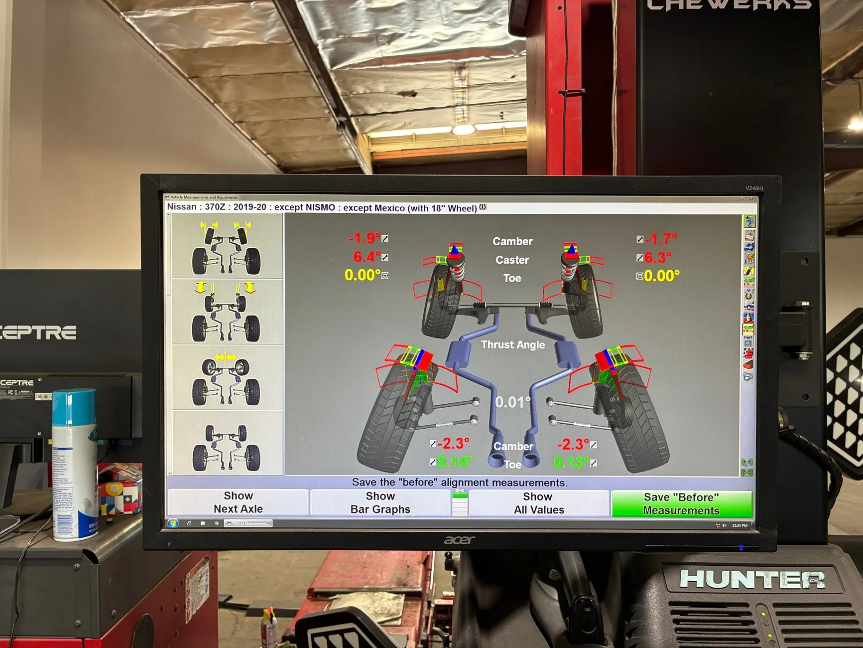

Misconception on premature tire wear isn't camber. Its the toe that scrubs the tires and wears them down fast. You wont be changing tires every 5k
You will be ok with -1.6/-1.7 camber. When you look at those charts, you notice the green bar in the middle. Those are tolerance bar. Anything in the green is good. Now that you know that info, you will only be -0.1/-0.2 outside of the green bar šŸ˜‰
I tell my alignment shop to make the camber the same on left and right. Its not a big deal for anyone, but I sleep better at night 😓

When you look at the alignment sheet for your car, the green is what is acceptable to be close to what Nissan has dictated for a factory alignment. A BMW M3 or M4 has a target of -2* front and rear without having excessive tire wear. Geometry is geometry. You’re not going to have a situation where car A can have -2 and have no wear but car B will wear out with -1.8. That’s not a thing. Nissan has the specs set up for the car to understeer in a corner so your average joe won’t spin out as easily by mistake. That’s why the Nismo has a 10ā€ wide front rim but still has 255’s. Nissan knows their target. They know that most people will stay stock and go get some groceries and go to the local cars and coffee but they know that enthusiasts want more so they gave us the bones to work with easily. BMW on an M car (being the ā€œultimate driving machineā€ cares more about putting down numbers on a test to prove what they have engineered) for years people have used M car alignment specs as a great starting point for an aggressive street car. They are a double wishbone front and multi link rear just like the Z.
