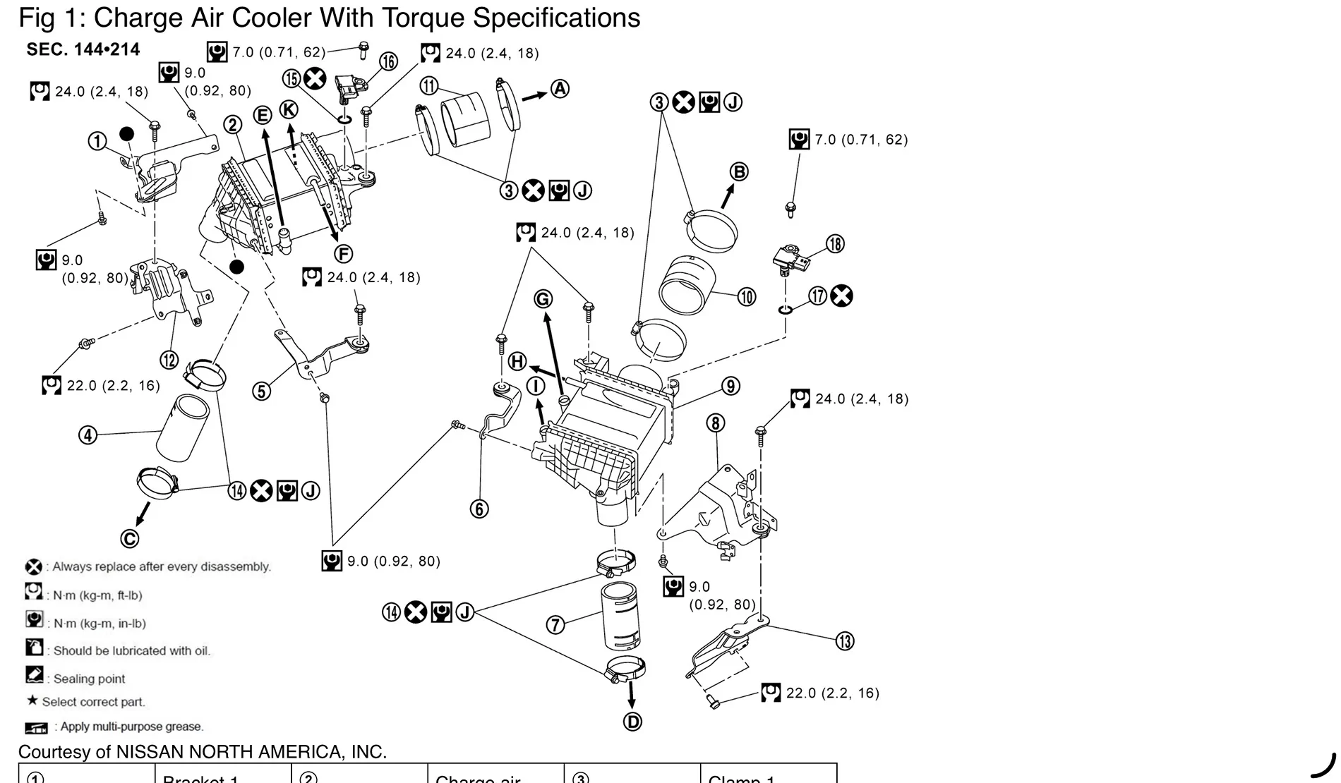

Wondering if anyone in the community has a aftermarket gauge setup to read charge air temps. I have a gauge to read oil psi utilizing oem oil temp sensor via t-fit adapter so I was thinking if there was a sensor out there to read charge air temps as well for the Z. In the pic 16 and 18 is the boost air sensor and similar to how I have my oil psi setup I wanted to see if there’s something out there to make this happen.
