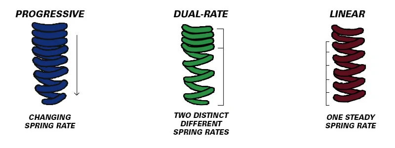

The ARK springs appear to be linear rate as they share the exact (linear) spring rates. The website states "Each spring has been engineered and tested with the best progressive/linear spring rate..." which isn't exactly clear.
alutwon
Jun 27, 2025
88
148
usa
best I could determine is that they mean dual rate springs, its just worded poorly

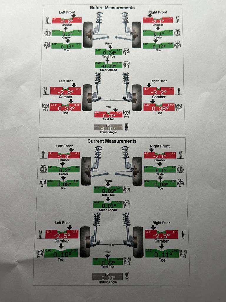

@wisner99 how are you liking your springs after a month? Did you get an alignment after or no?
Still really enjoying them, been daily driving with no issues. I did get an alignment, just on stock arms.
Before and after here, done with me sitting in the car. Definitely get an alignment to not kill tires!
