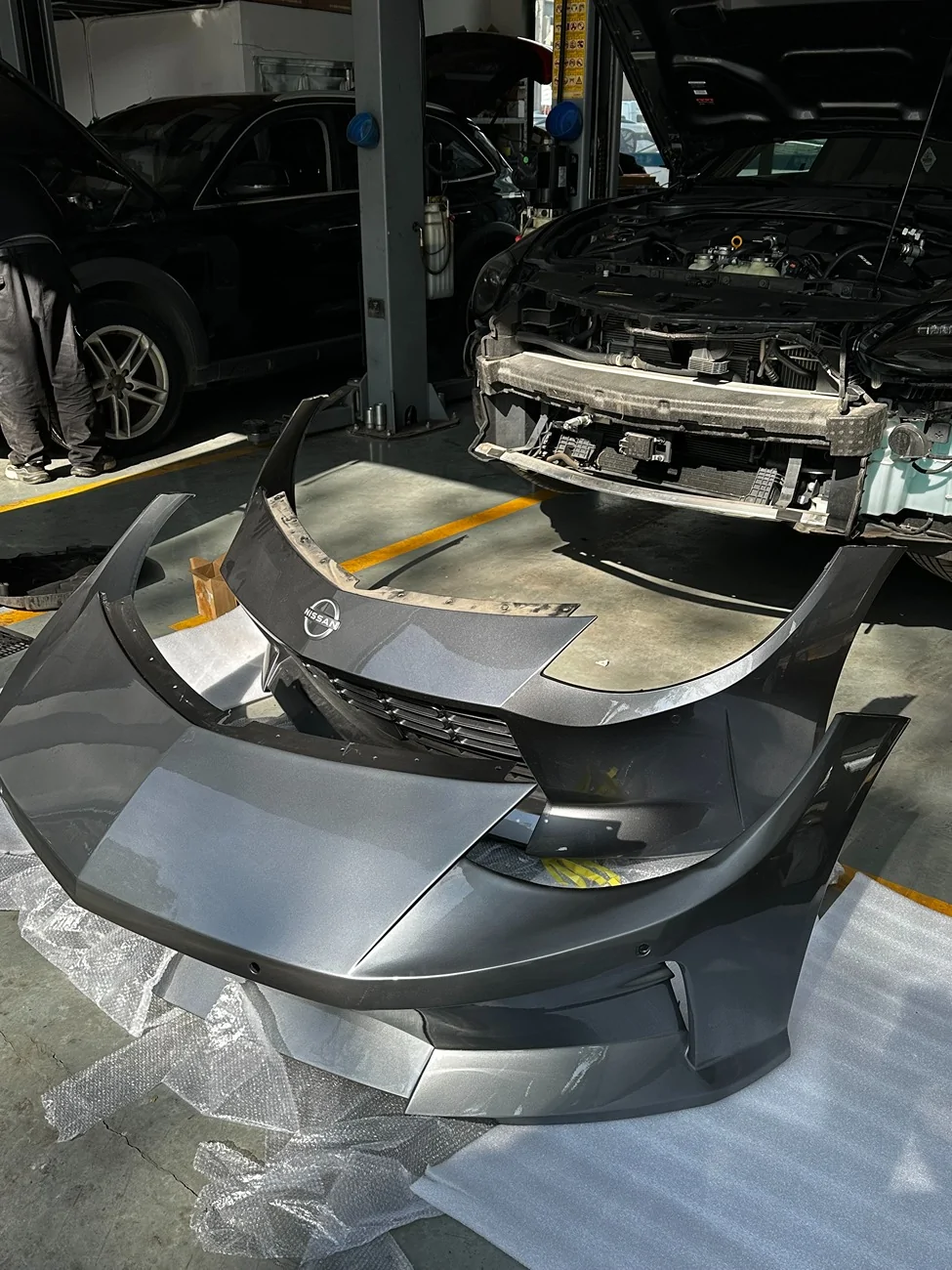

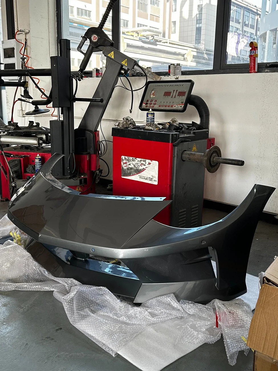

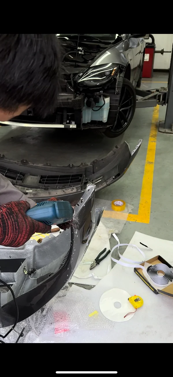

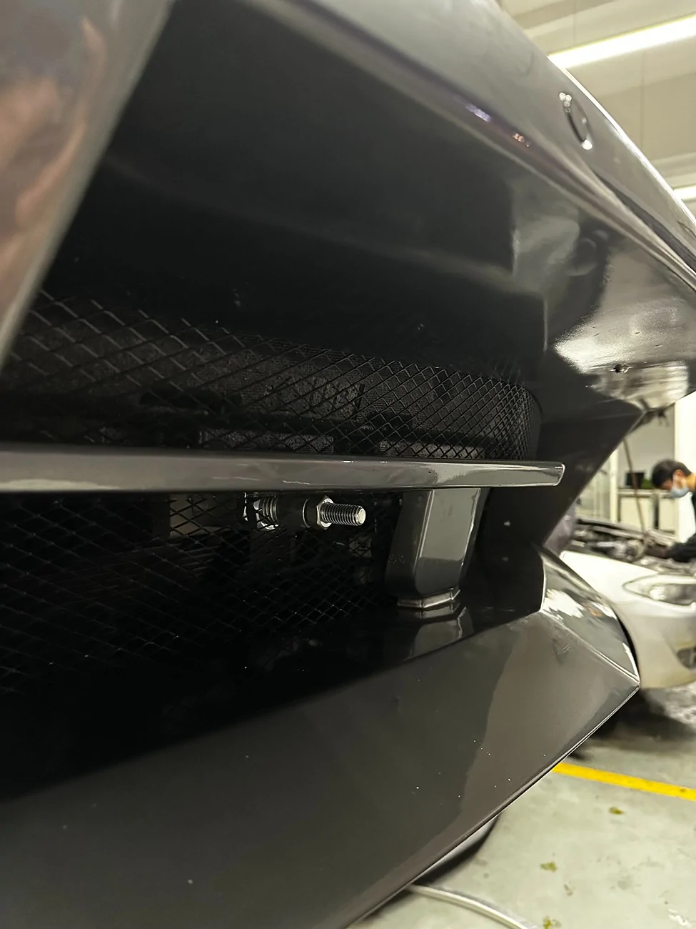

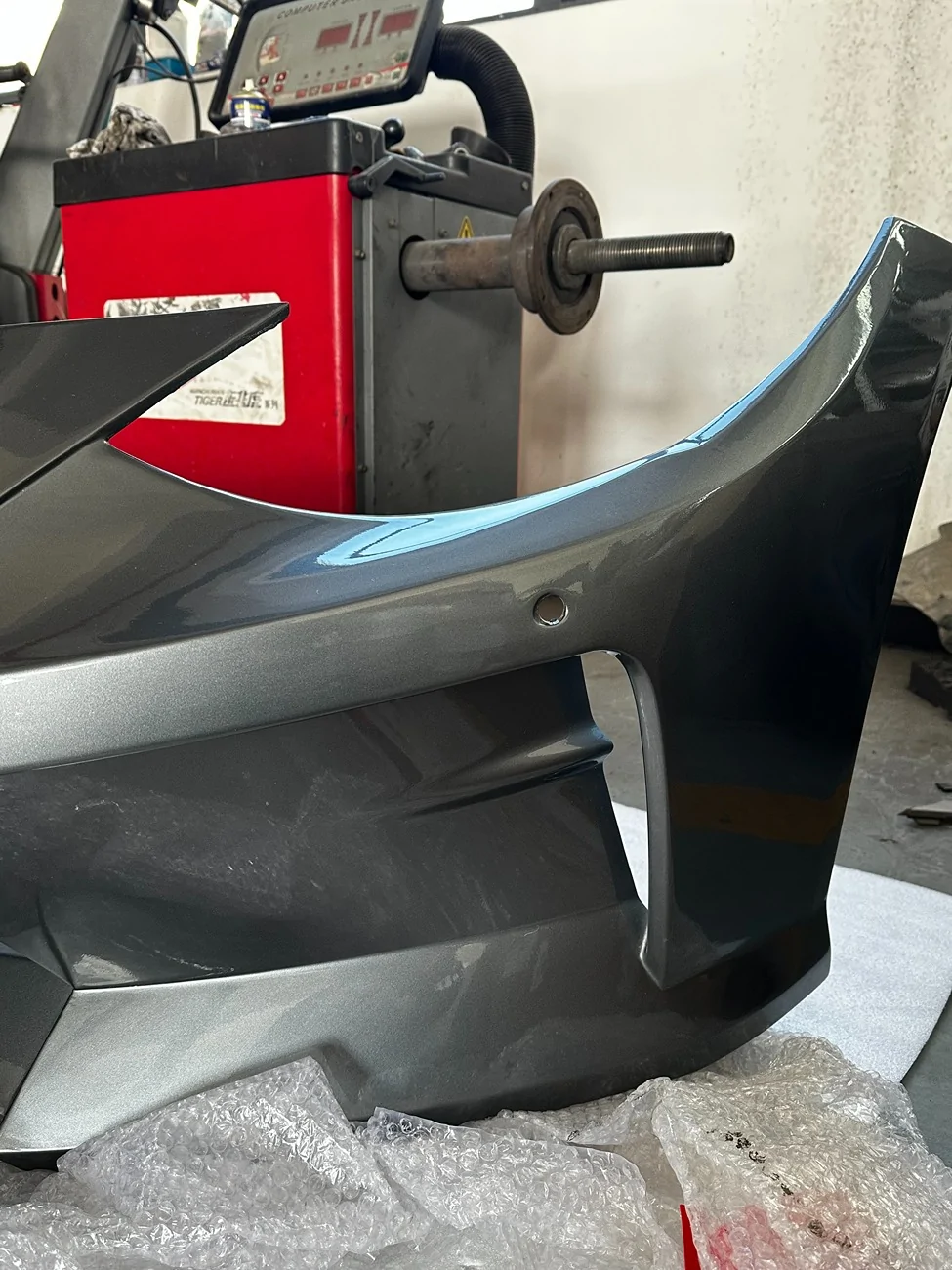

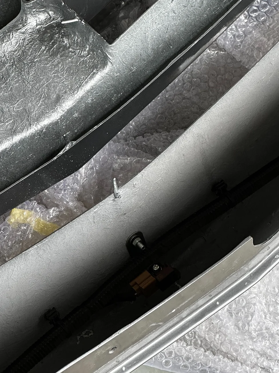

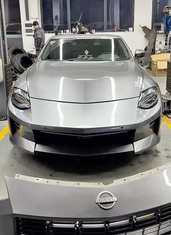

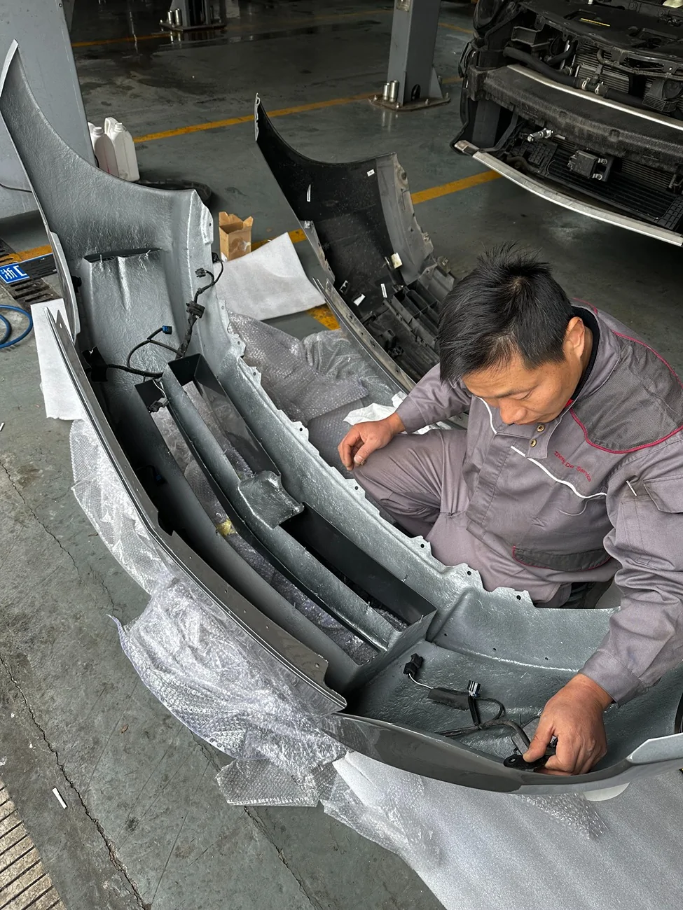

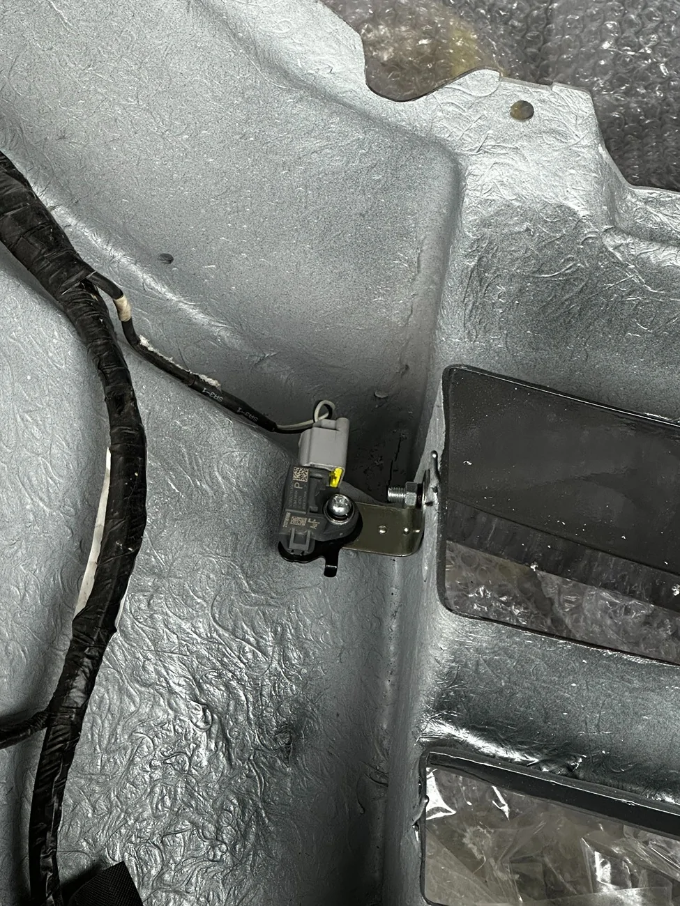

Hey folks, just finished installing the bumper today but the side plate issue still exists. Paint job is okay to look at I guess. But summing things up today, we encountered several problems. First off, OEM radars and sensor wiring were successfully installed with DIY style, we drilled three holes separately located on top including left and right sides next to the center grill to support couple of sensors (probably crash and air bag sensors). Six front radars on the other end were installed without the OEM plastic cover due to the size of the previous LB hole placement. Eventually all of them were triggered with proximity alert when put in reverse gear, we figured the problem might just be the plastic cover, but in order to fix it, we need to dilate them holes. And that's a huge pain in the ass. On the side, in order to fit the bumper into the side fender slots, we had to drill several holes and curves to do that. Because LB left us with flat surface. Currently waiting on extended pole for my side plating, will post and follow up on that too. But if anybody knows a solution to the radar issue please let me know, and btw it kept showing me low washer fluid warning, but my tank is pretty much full as y'all can see. Wonder if any other owner ran into the same problem? Overall, still have to say that the LibertyWalk aesthetics is simply gorgeous!
