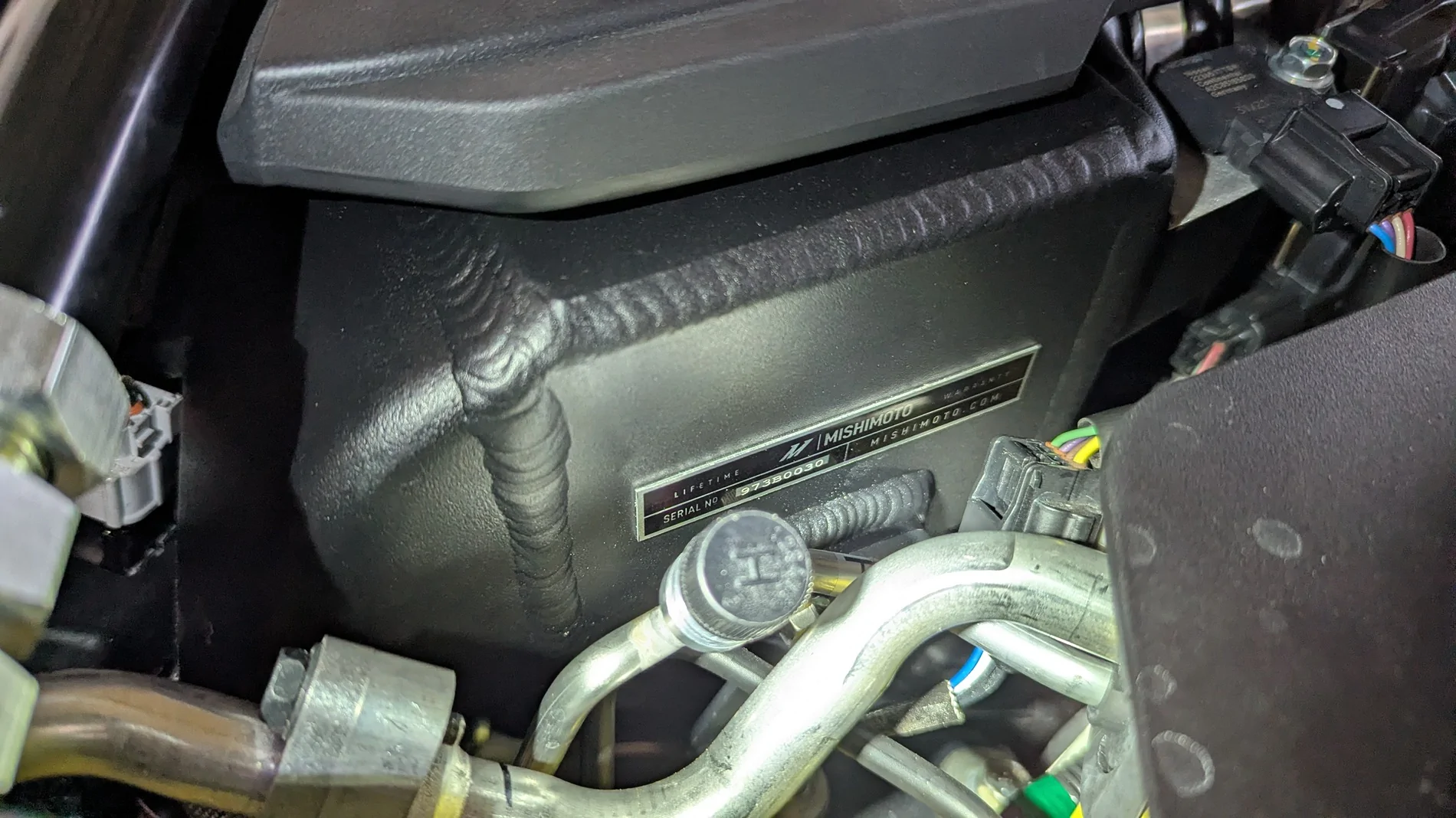

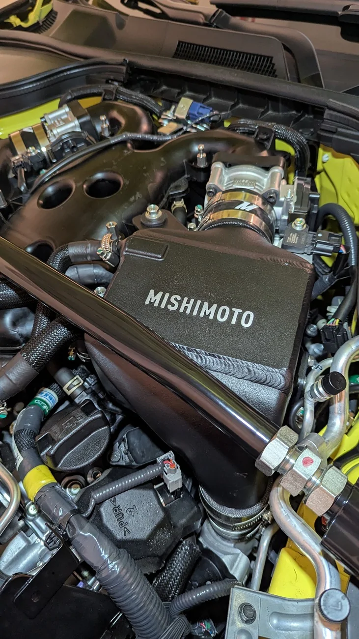

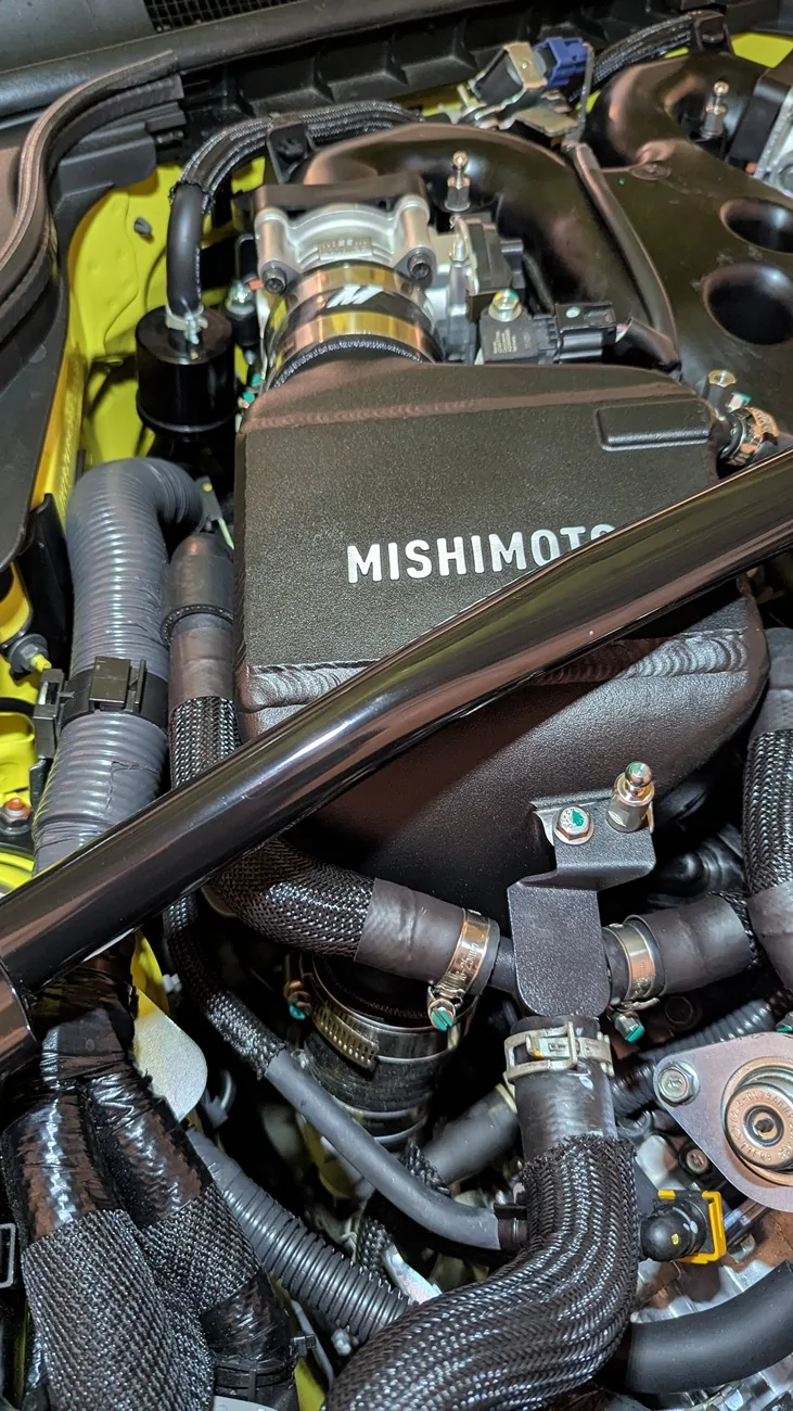

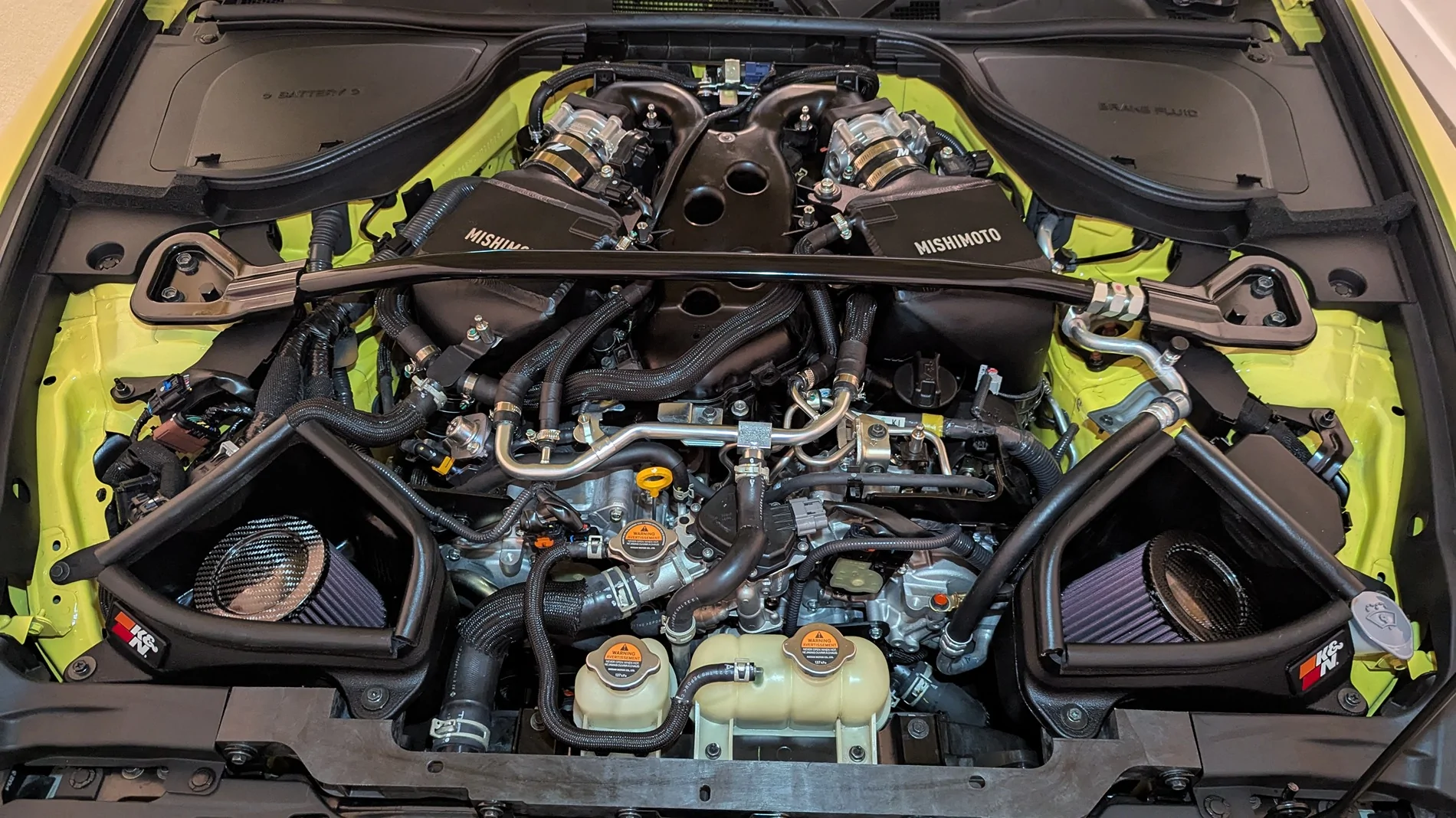

Got these Black Friday parts installed by RaceBox here in Houston yesterday and picked the car up today. Perfect fitment all around from the feedback shared and looks of it. I like that the heat exchanger reuses the factory stone guard and the intercoolers fit under the stock engine cover. As for the intakes, you definitely get plenty of those sweet turbo noises! I'll get the rubber gaskets added that seal to the underside of the hood.

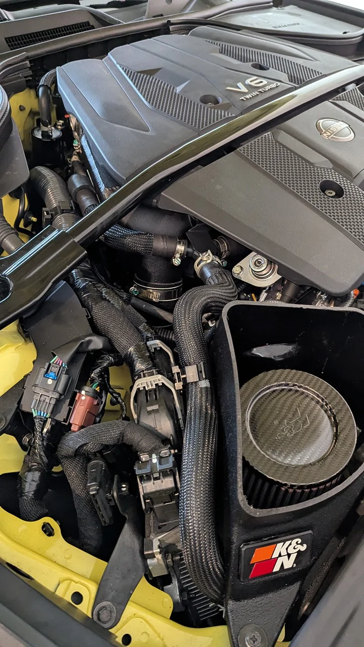

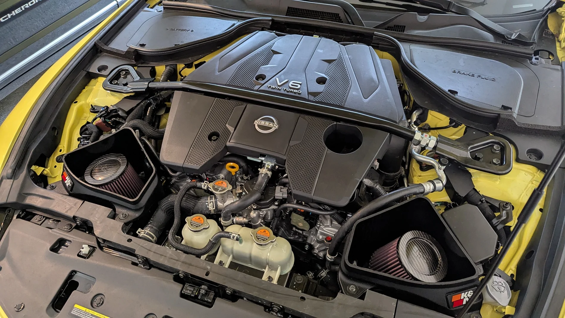

I got the rubber seals installed around the airbox tops tonight.
Pro tip: massage them into place prior to installing the intakes! It'll result in a much cleaner fit.
Overall though, love the fit of everything and how it all came together! I'm glad about my choices and think I made a great decision opting for the K&N intakes.
Quick follow-up:
Adding the airbox seals definitely reduced the intake noise by I'd say 50%. Still audible, but muffled. I lightly greased the seals (Honda Shin-Etsu) to see if/where they make contact against the hood and they in fact do. The airbox w/o seals should keep most of the engine bay heat out while still being loud like fully open filters w/o boxes, but w/seals should be just as effective as the fully enclosed airboxes (AMS, Nismo, Mishimoto, etc.), but louder w/o a fully enclosed plastic lid. Definitely pulling in the fresh air from the front bumper ducts as I already found a full leaf in one of them!

Pics without the engine cover:

@KrackaC8 the Mishimoto intercoolers look nice. I wish they had put their M logo on it vs. just random text that says Mishimoto. Such a 1st world problem but still. Do they still fit under the engine cover?
Christopher
Nov 23, 2025
1,585
2,366
Sioux City, IA
Commodities
Sure do! See post #1. They're hidden under the engine cover.
